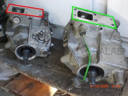

You can use the D1. It is plug and play so long as you take everything involved with the shifter. You will need the shifter, boots, console cover, linkages, nuts/bolts, grab everything or you will have problems. Most important for a seamless swap is the cover and lever for HI/LOW. I tried to find a picture but no luck. Because of the linkage from the D1 shifter to the Hi-Low lever, you will need that lever as the D2 lever doesn't reach over as far. If you do a few searches you will come across what I'm trying to explain.
Attached Thumbnails New Discovery Owner Questions-Snorkel & Lift Kit)-image.jpg

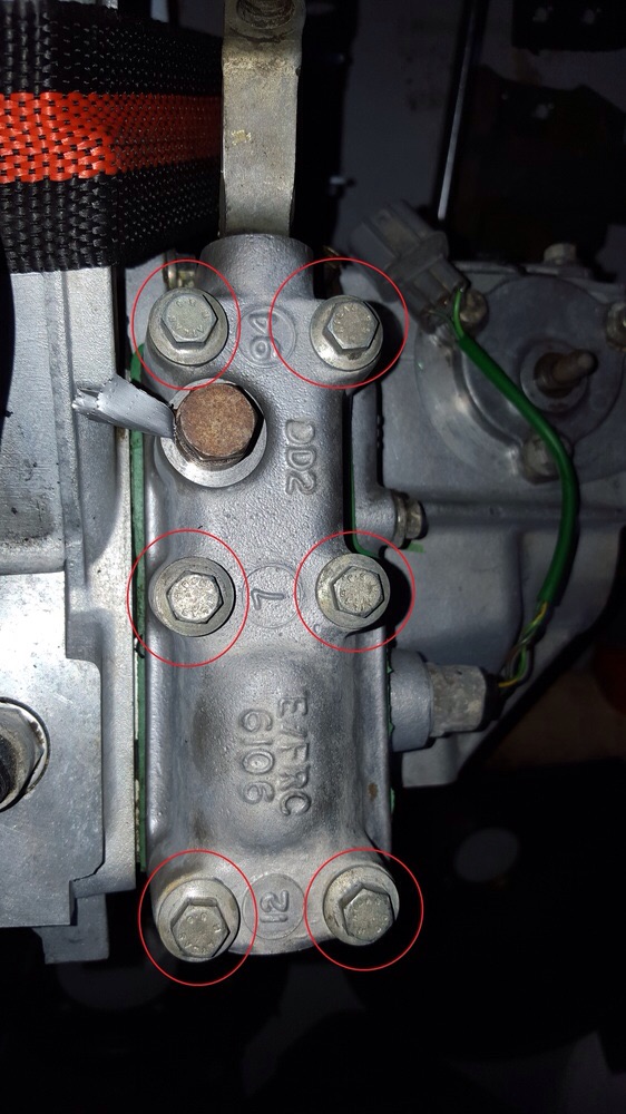

Hi Low lever AND housing. Remove it as an Assembly.
