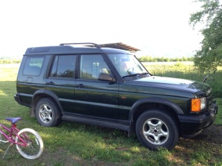

I bought a 2000 Discovery II just over a week ago for an insanely low price. The price was because the previous owner wasn't a "car guy," and he seemed to respond to each new failing as a reason to drive the poor truck less, but not to fix anything. He appears to have bought the rig two years ago, probably with lights glowing on the dashboard, and then drove it only about 9,000 miles. I checked the stored OBD codes before I bought the poor thing, and most had been logged 21,400+ miles ago. With all these problems, and knowing full well I knew what they were, he offered a price too low to turn down. We'll see if I was a fool to buy this Disco for $850.

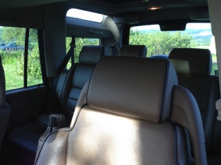

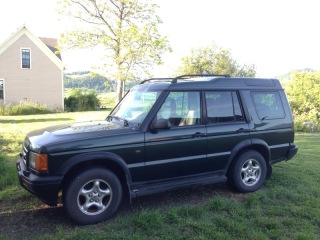

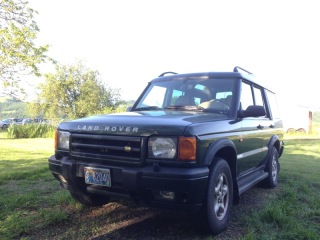

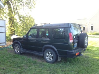

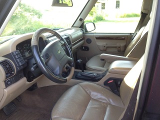

The bodywork and interior are in very good shape.

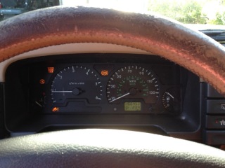

The error lights tell part of the tale. The three amigos are glowing away, as the Service Engine Soon light. The codes are for misfires and lean mixtures on both banks, so I have some vacuum leaks to find and fix. I've got to put in new plugs and wires too. Also, I have a bad sensor for the transmission cooler temperature, so I have some diagnosing. I also have a collapsed tappet, and I have an ugly feeling that the 9,000 miles since he bought it have been on the same fill of motor oil, so it's probably overdue for a change. I'm also encouraged by the errors I don't have, no errors for bad oxygen sensors, or a bad TPS or bad MAF sensor. There's hope.
