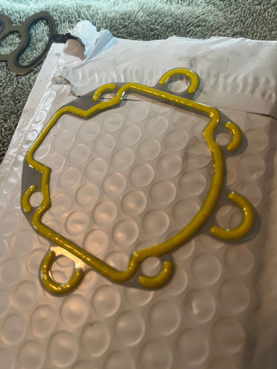

I had success today.
After struggling with the replacement pump (Amazon $70) I rebuilt the original pump. Not a full rebuild, I just replace the gasket.
After getting everything back together I lifted the front and had someone turn the steering wheel back and forth.
Finally got rid of the sound and not foam. Yes there was a little foam, must of been some still in the system but it worked its way through. I was using the 1/4 Inside diameter tubing to flow from the nipple of the steering box and back in the reservoir.

Glad you found a fix. I just ordered a new NAPA pump. I’ll follow your lead and install new gaskets in the problematic ones and have them on hand the next time it poos the bed.
