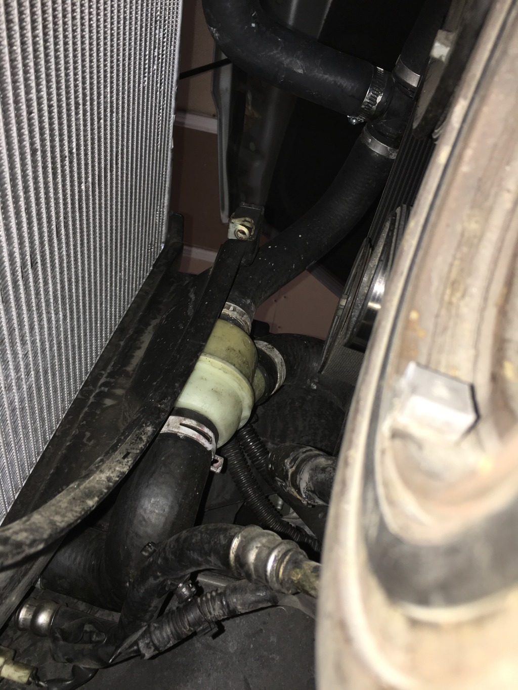

Right now I can't trace any higher than here. going to start looking.

Could be water pump shaft seal, have you replaced pump since becoming a mechanic? Much easier to inspect around that area of engine when fan cowl/shroud, fan/clutch and belt removed. Good lock.

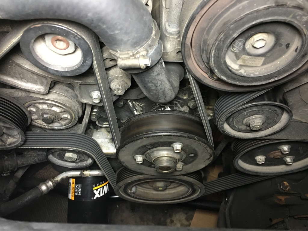

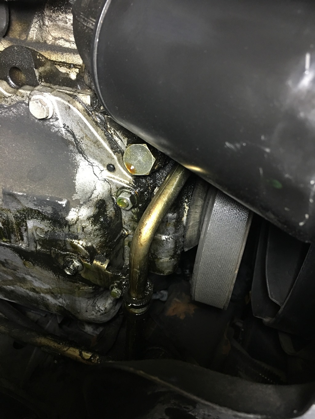

Pulled the fan and shroud. No real evidence except wet on the bottom 1/3rd driver side of what I think is the timing chain cover

Don't know if pump shaft seal leaks favor one side or another. Appears to need a good cleaning before it will be easy to spot a minor leak that may come and go. If unable to get good look at bottom of pump it's easy to loosen pump pulley bolts, remove belt and finish pulley removal to see. Another area to check is fwd end of head/block and can be viewed from below. Hopefully something simple like the pump.

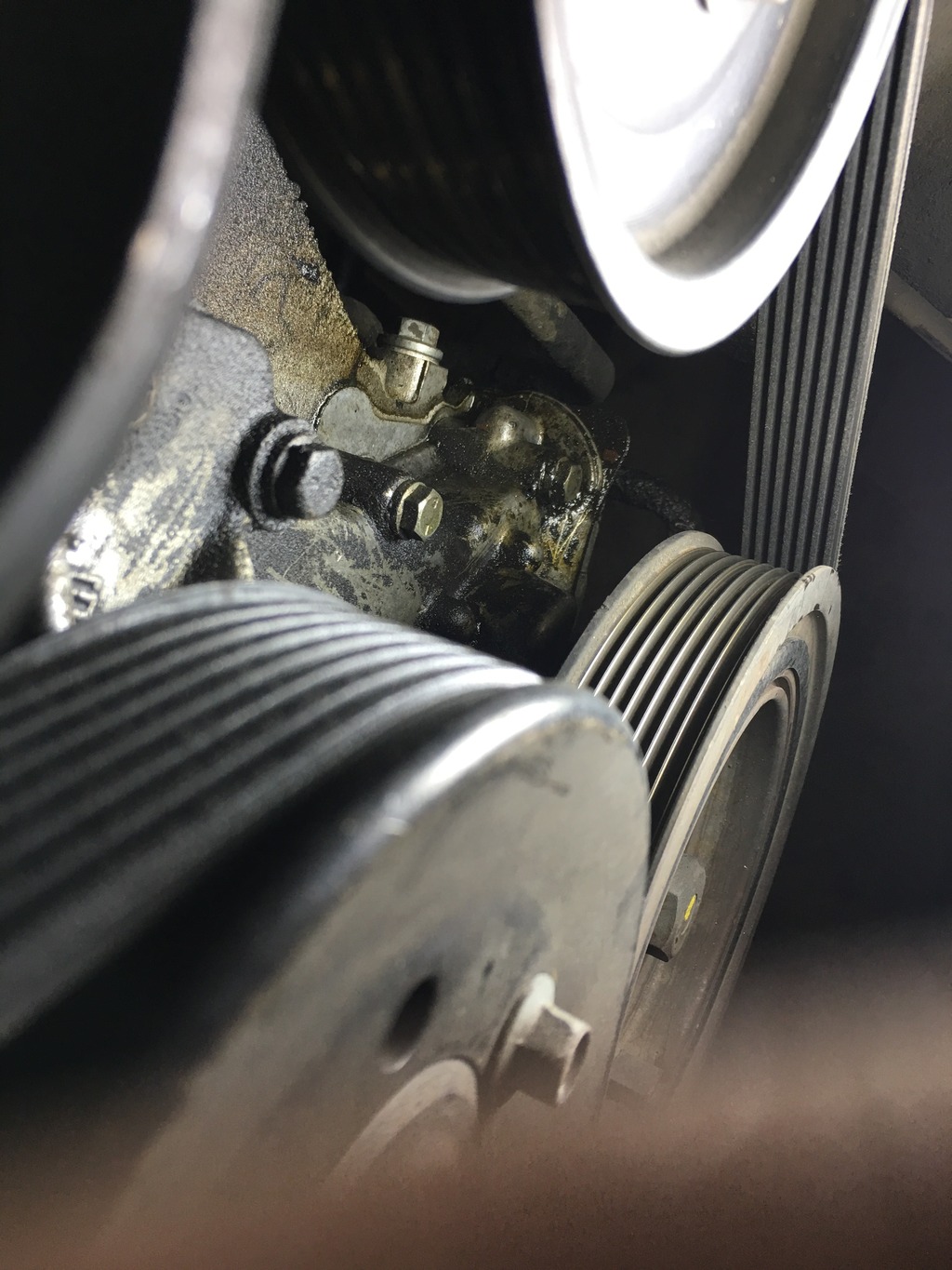

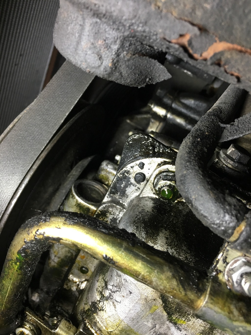

Cruising temp in town 212-215f. Going to add some purple ice. Came home, no drip. When I shut off engine, started to drip from what looks like behind bottom pulley.

When I shut off engine, started to drip from what looks like behind bottom pulley. Is that a scheduled replacement?
Location indicates time better spent pulling pump pulley and checking weep hole below shaft than going through mx records. Pump life varies widely, some go for ever and not usually scheduled mx.
