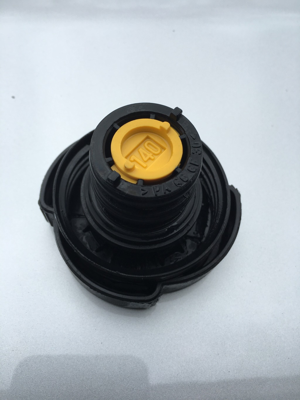

Put back on the original reservoir cap. Drove to gas station and parked. No drip. Filled up and drove 15 minutes at 55 mph. Parked. No drip.
Standing here waiting for a leak. No leak. Wonder if new cap not venting and forcing coolant out somewhere?
This drip did not start until I put my new $12 el cheapo cap from eBay on yesterday

My $8 Gates worked fine and stick to those or Stant. Found under radiator cap rather than reservoir. More Information for GATES 31331
New cap probably fine and making you aware of a problem, minor seeps can often develop into active drip type leaks once systems are tightened up and operating at correct pressure. I saw similar thing once my seeping reservoir was replaced.

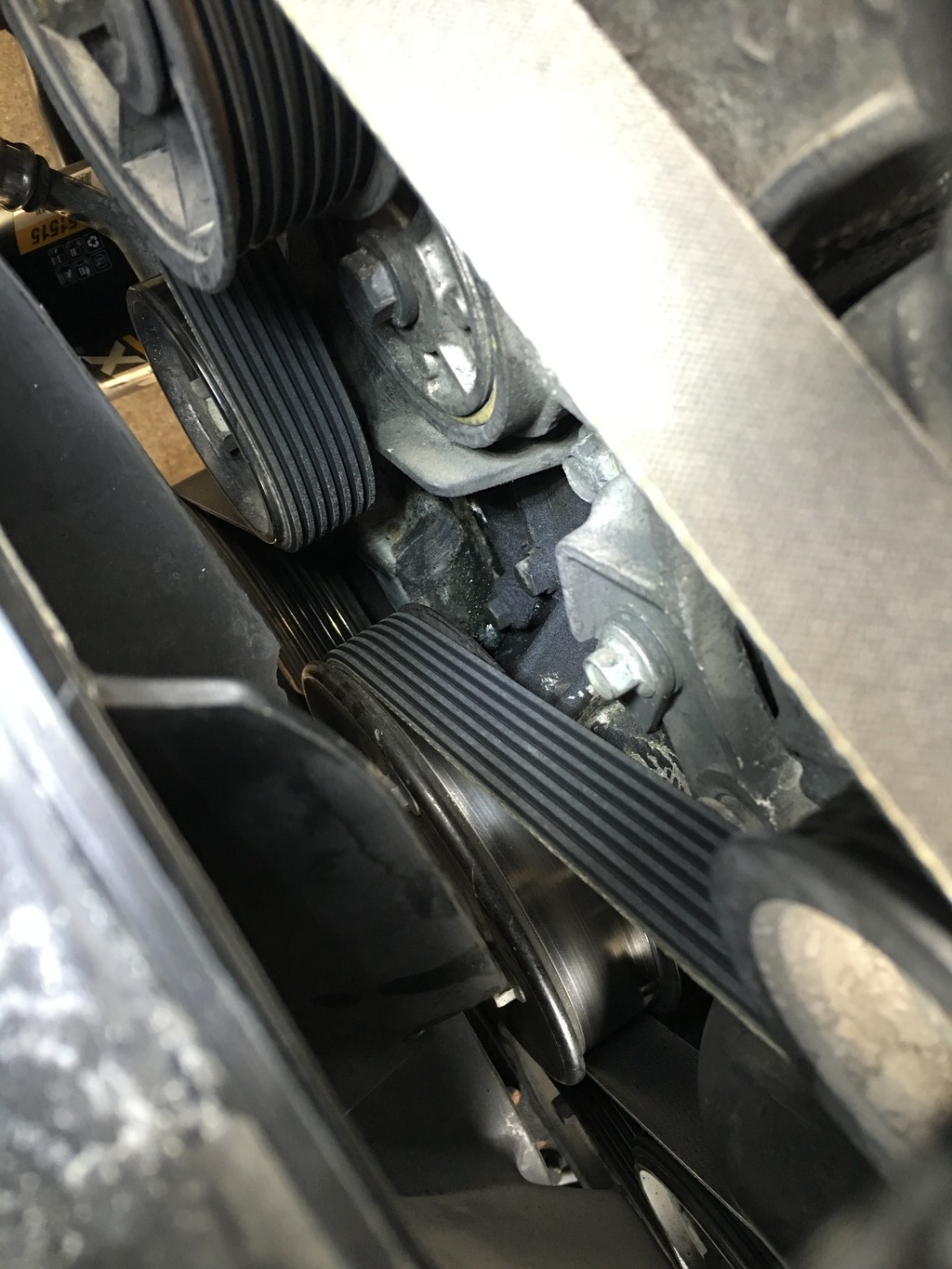

Looks like directly below the alternator it's wet. Also dirty accumulation there so a likely source of a leak.
I just found a great How-to video for this. Wondering if I should order the pump and replace it regardless. http://www.roverparts.com/resources/...t-discovery-2/
I'd recommend as part of your reconditioning project. Recently replaced mine at 97k, no leaks, functional, with clutch and belt off could tell bearing likely in need of grease. R&R of pump could've been a simple one hour job except for having to remove rock hard sealant used between gasket and timing cover. I used a Hylomar equivalent sealant on the long bolt threads and both sides of new gasket using an acid brush to apply.
