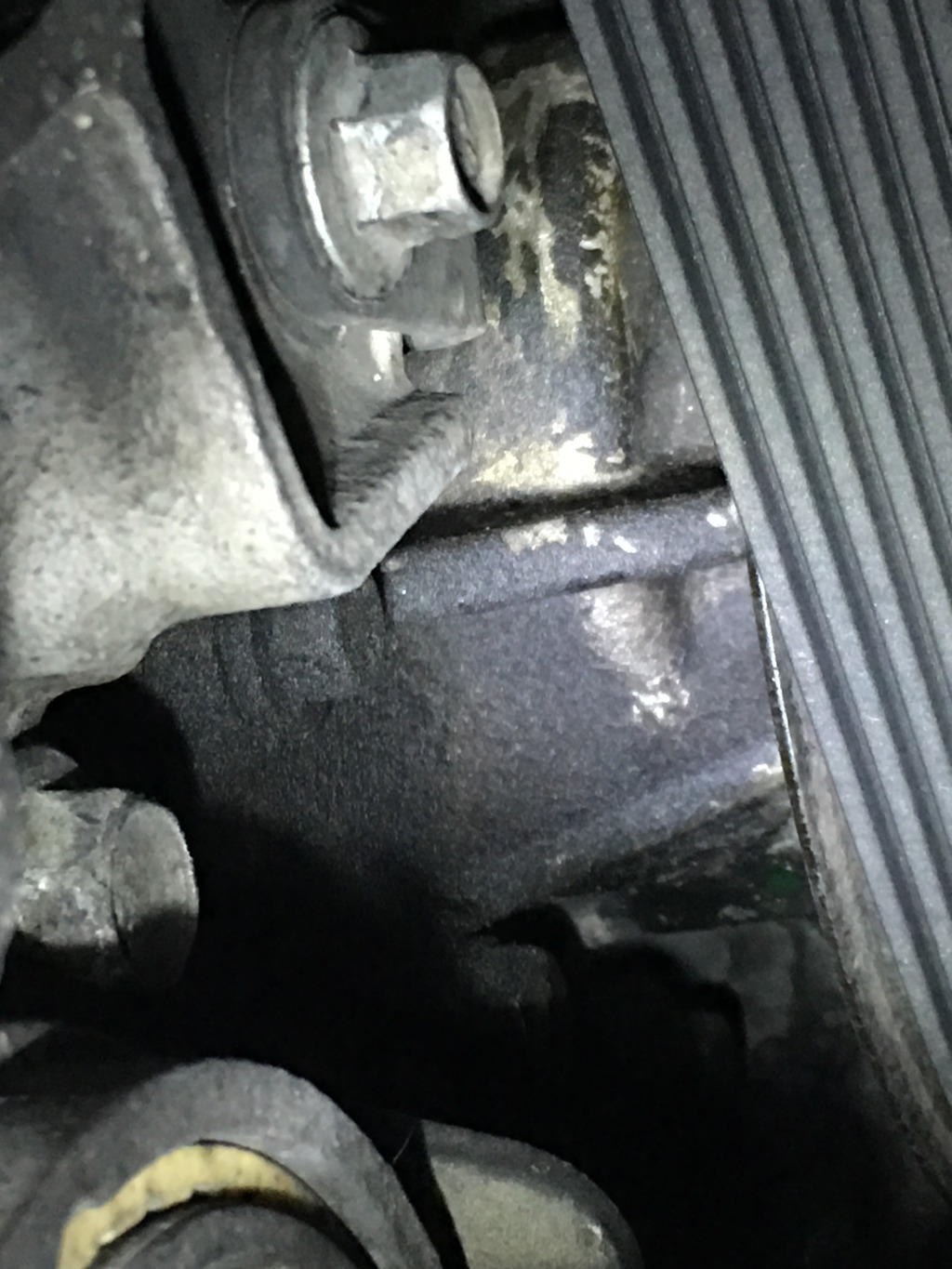

So i found coolant from the weep hole. See bottom right of pic. Pressure tester comes tomorrow, new pump and hoses too. It did not drip yesterday so today I had to point the nose down and look. Kind of glad it was weeping from there. At least glad in the sense that if it was not leaking from there, I would be nervous where.

Now the only trick is to only remove the water pump bolts without disturbing the timing cover and you've got it made.
No, don't tell me that. I thought this job was supposed to be the piece of cake job. :-)
Ok, guess I'll be extra careful.
