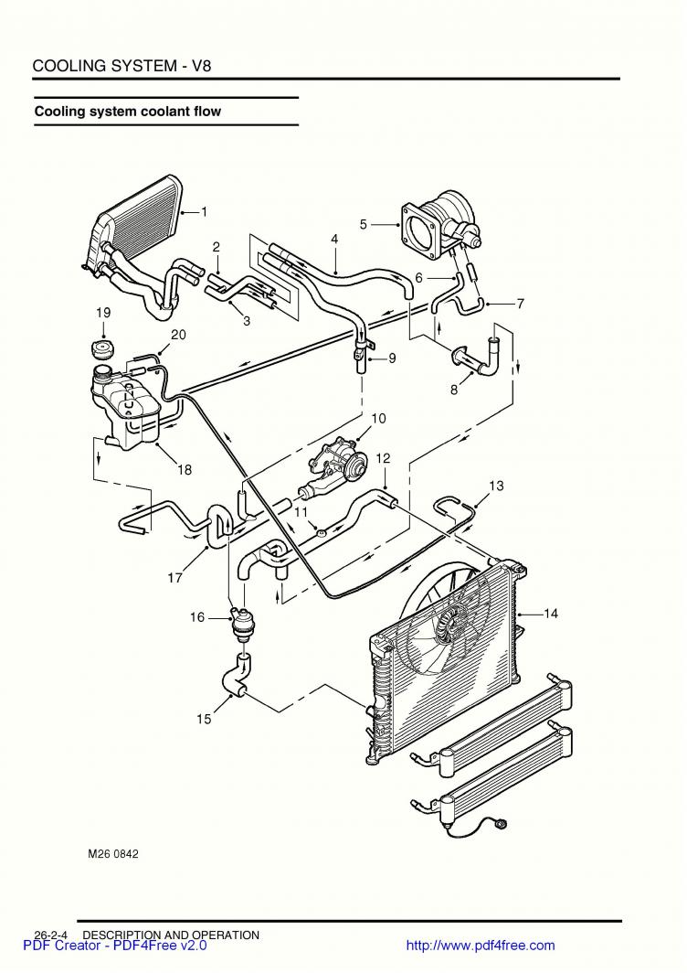

If you suspect heater core is blocked, and you have low heat, that is also a sign of low coolant, a more serious issue. Sound like water rushing thru pipes under dash is air bubbles (can purge) or exhaust gas (head gasket). In the plumbing plan you will note there is no valve for heater core, it gets hot coolant every day of the year, even with AC on. Some reverse flush the core.

I will check the oil pump and see if it needs to be replaced. I'm hoping that by now with a 145xxx that it will have had most of its problems already and things have more than likely been replaced. The heater core gets no heat at all but I can feel warm coolant in the lines running into the fire wall. I am hoping that its plugged up and not something more sinister. The D2 has full coolant to my knowledge but I have only checked the level when I first bought here last week. Thanks for the info everyone.
