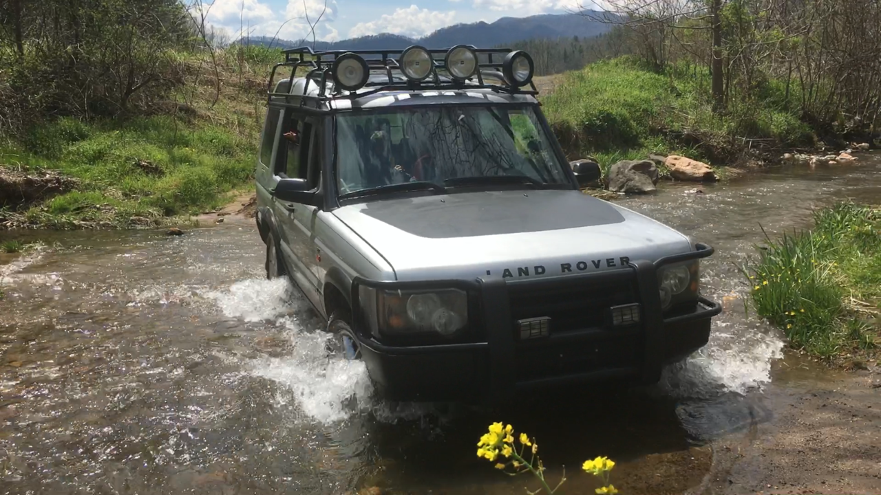

Cool picture BTW. I love those "round eye" LR's!!

Thanks 80's! My mechanic has some old defenders in his lot. I'll post more pics when I see him later.
