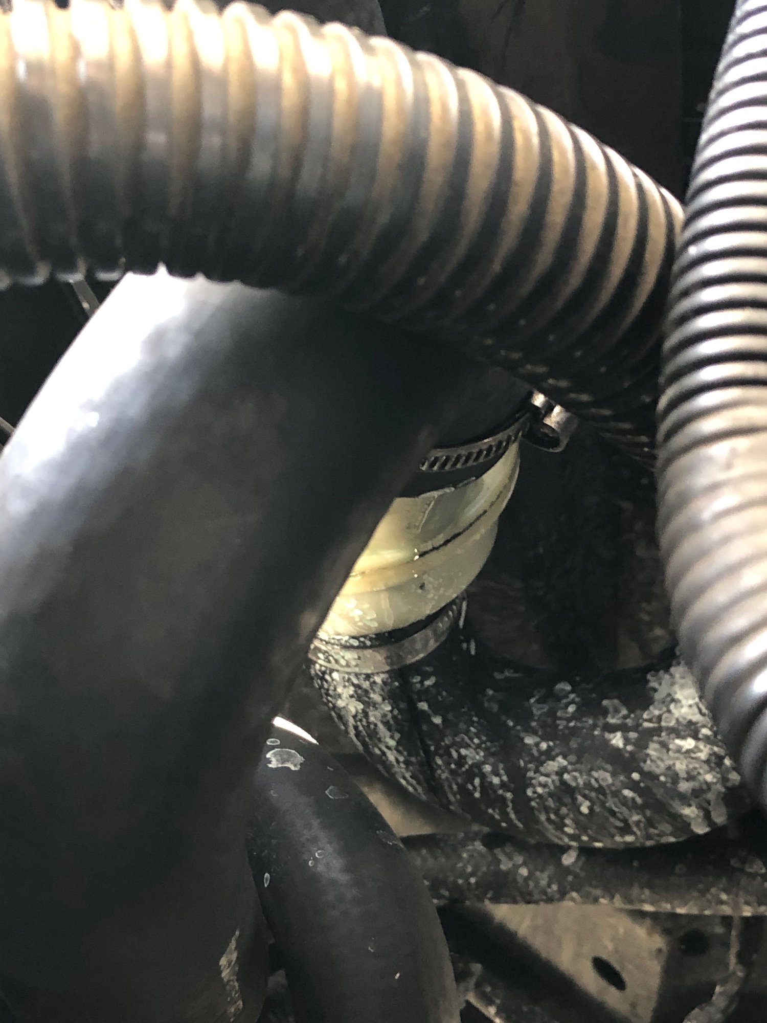

Welp. Problem FREAKIN SOLVED. You guys and your advice to get a pressure tester was exactly what I needed to do. I went to OReilly's rented a pressure tester ($0 btw as long as you return it), hooked it up, ran it to 14PSI, and low and behold, seeping an ever so slight stream... the lower hose that connects to the thermostat had a slightly loose clamp. Tightened up, bled, went for a drive. Temps are 5 degrees lower and there's no more water fall noise.
Also, before you guys comment about how obvious it is that there's a leak based on the dried coolant everywhere... that's also where the bleeder hole drips all over and since I've been bleeding a lot this week, that sort of hid the issue.
Anyway, can't sing the praises of a pressure test any louder.
