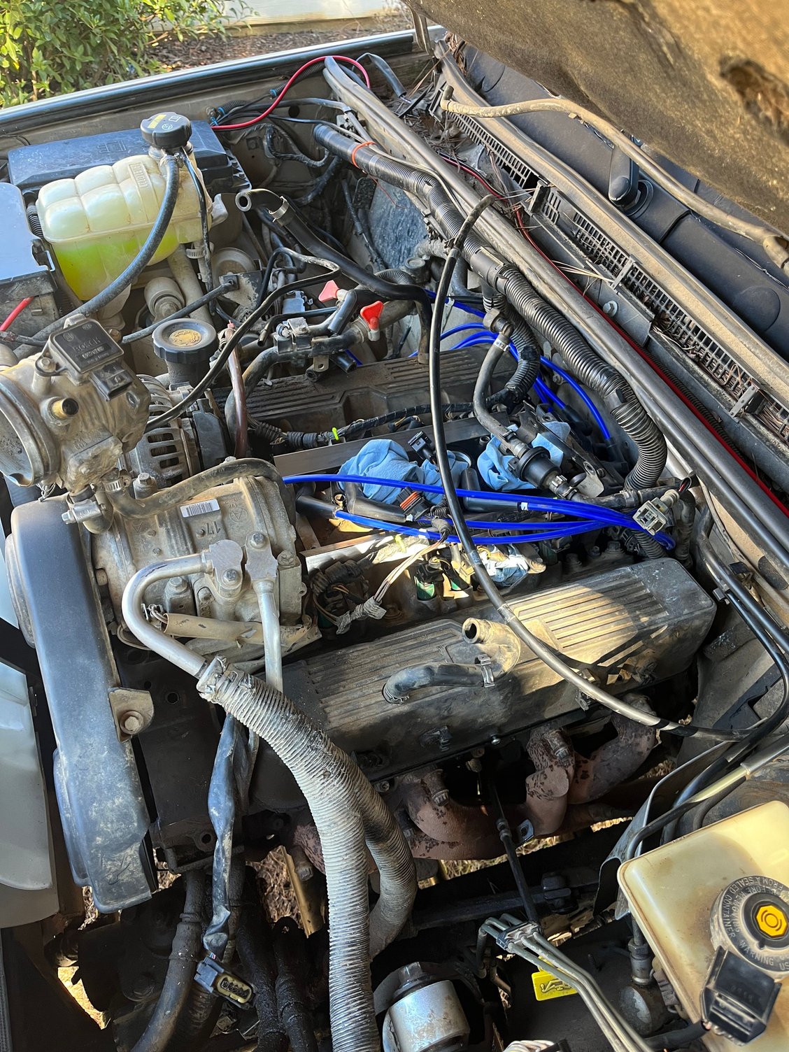

Taking a break to grab lunch, but there isn’t a way to pull the valve cover without moving the ac pump is there? I’m just going to take the belt off and unbolt it so I can wiggle the VC out of there, but before I do that I wanted to double check
Old Jan 9, 2025 | 11:12 AM
Grum.man's Avatar
Joined: Apr 2024
Posts: 176
Likes: 72
The AC is simple to remove. It will sit in the bottom half of the airbox where the air filter goes without removing any lines.

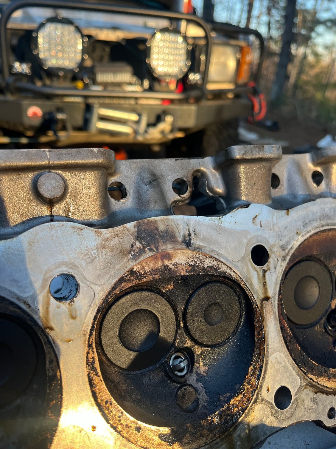

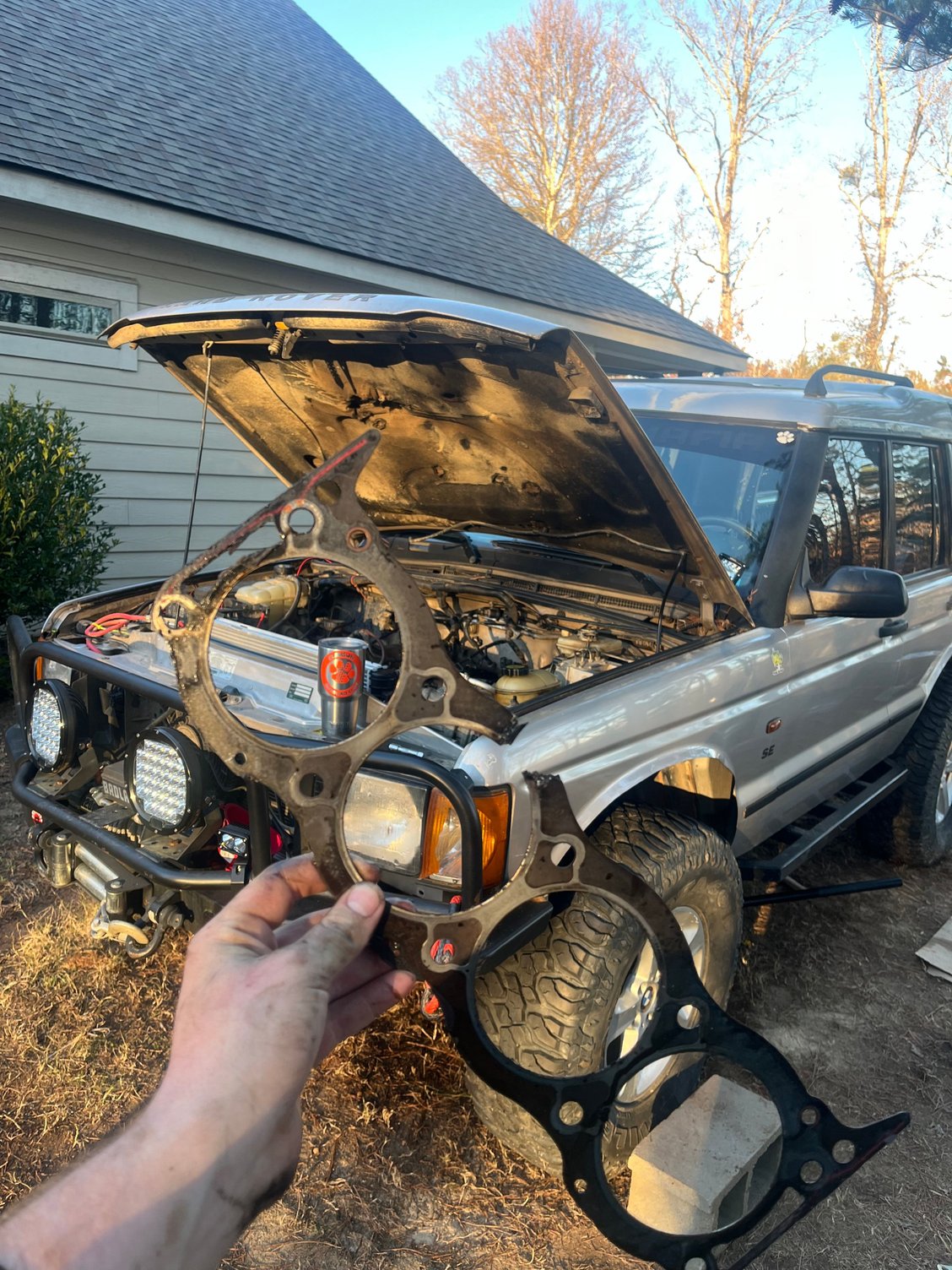

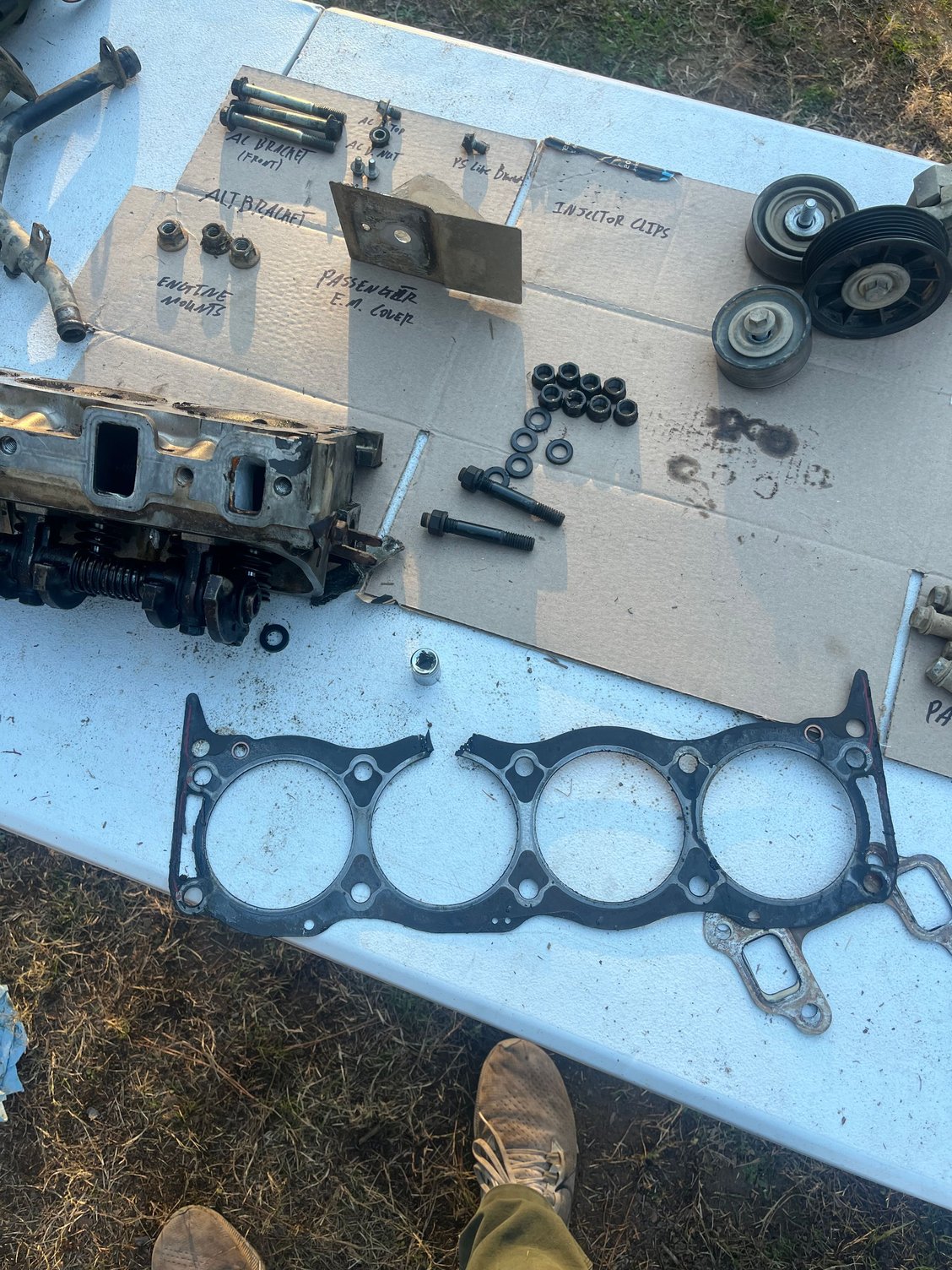

Well, the problem has been found! Classes just started back up and work is picking back up (I bartend downtown, so we are really only busy during the school year) so I hadn’t had a chance to get the head off until today.
I had spoken to a friend at a shop in Texas who knows a lot more about rovers and d2s specifically than I do, and after telling him all the symptoms he suspected it was head gaskets. I told him I was wary of that, since I did HG back in 2020 and have studs now, and the motors never overheated since then (ultra gauge, so I know engine temps haven’t gotten over 220 or so). He asked what brand I had used and I said Victor Rienz, and he said in his experience those fail way early.
Sure enough, I get the head off and there’s a nearly 1” hole in the HG between cylinder 3 and the valley. Lesson learned, and I have Elring HG coming Tuesday to put it all back together. So for anyone who didn’t already know, stay away from Victor Rienz head gaskets. The friend I talked to said he recently had a truck with those HGs that failed after 8k miles or so.

You need to get a precision straight edge and check the head and block for flatness. There is a spec in the RAVE. That big of a blowout i'd be surprised if the head or block doesn't need machining.
As for cleaning, I sprayed mine down with a solvent to remove wet oil then used these brushes on the end of a drill. I pulled the valves and cleaned them up with a wire wheel then lapped them in place and installed new valve seals.
