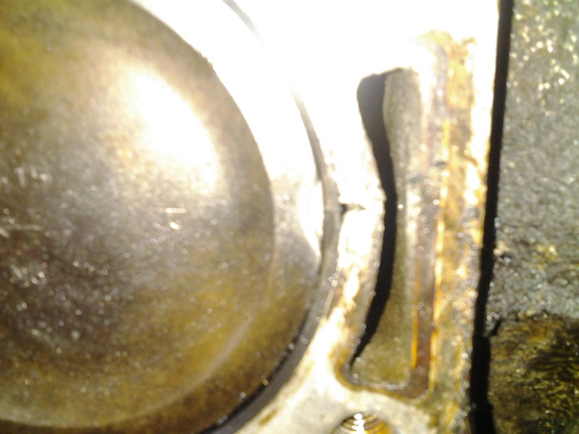

I started pulling the heads today and got down to removing the head bolts before it got to dark to work. I did notice that a couple of the bolts where extremely easy to remove and the two outside ones on the inside of the head where very hard to remove. I will finish getting off the heads after work and report my findings.

take note of the head gasket when you pull the head

my fears confirmed
