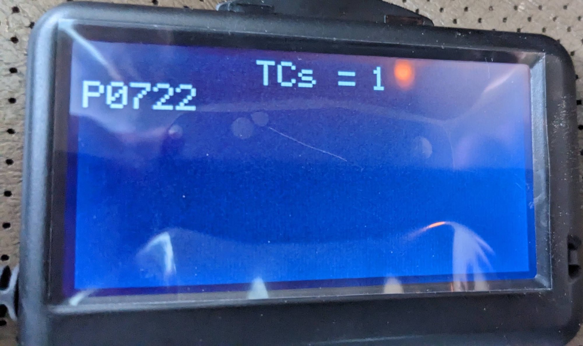

The only trouble code I have is P0722. I have a check engine light. The brake light is staying on even with the parking brake released.
I have read that trouble code is related to the torque converter. I also read that instead of replacing the torque converter I should replace the transmission? Or was that ALSO replace the transmission with the torque converter?

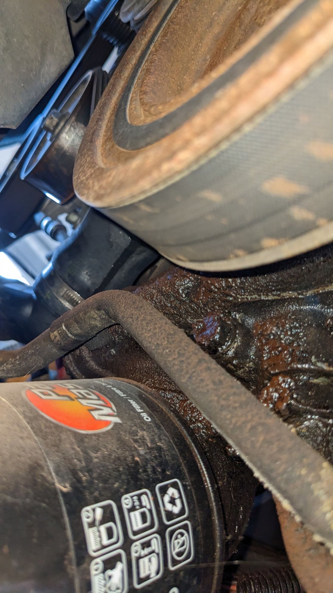

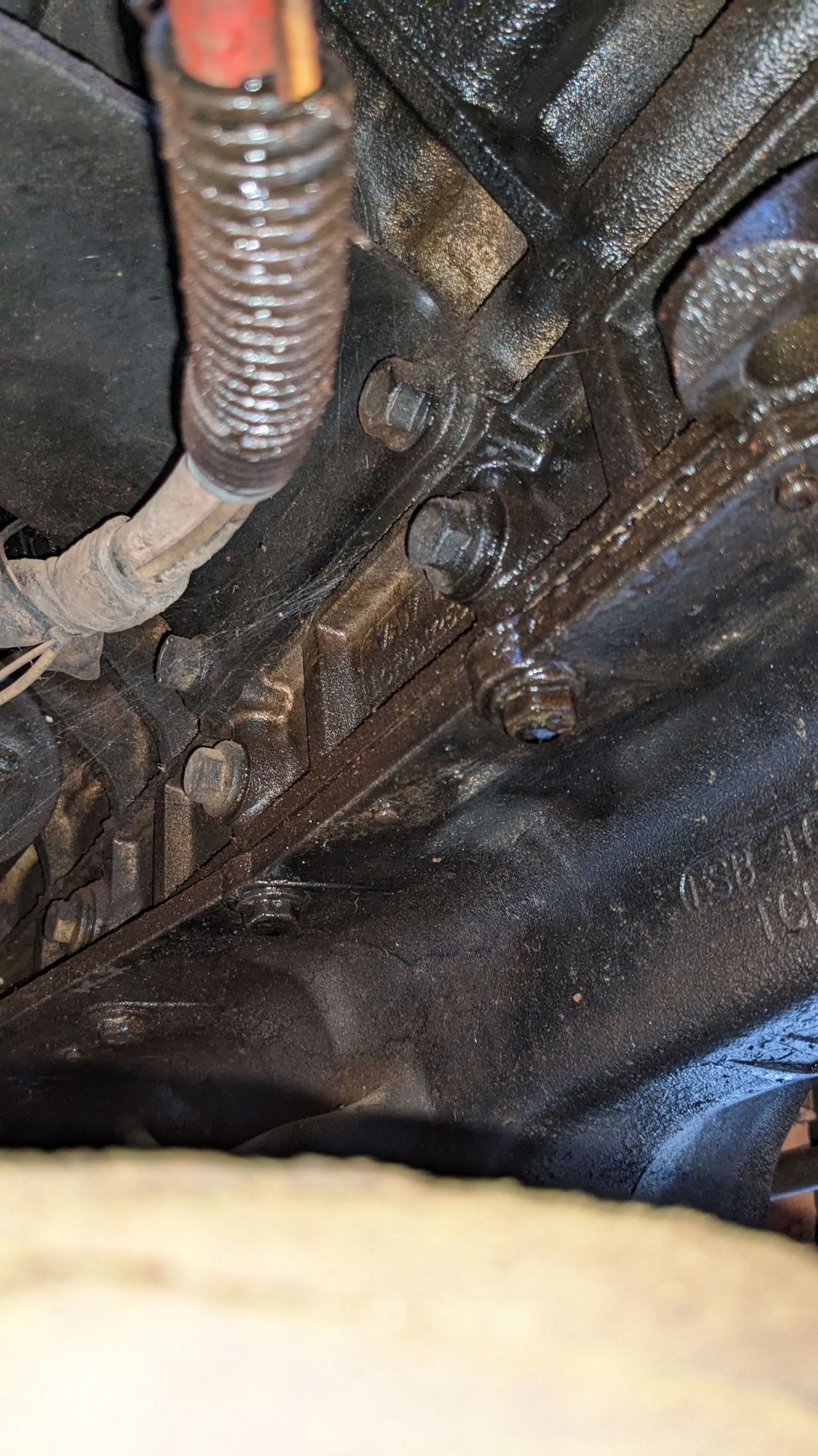

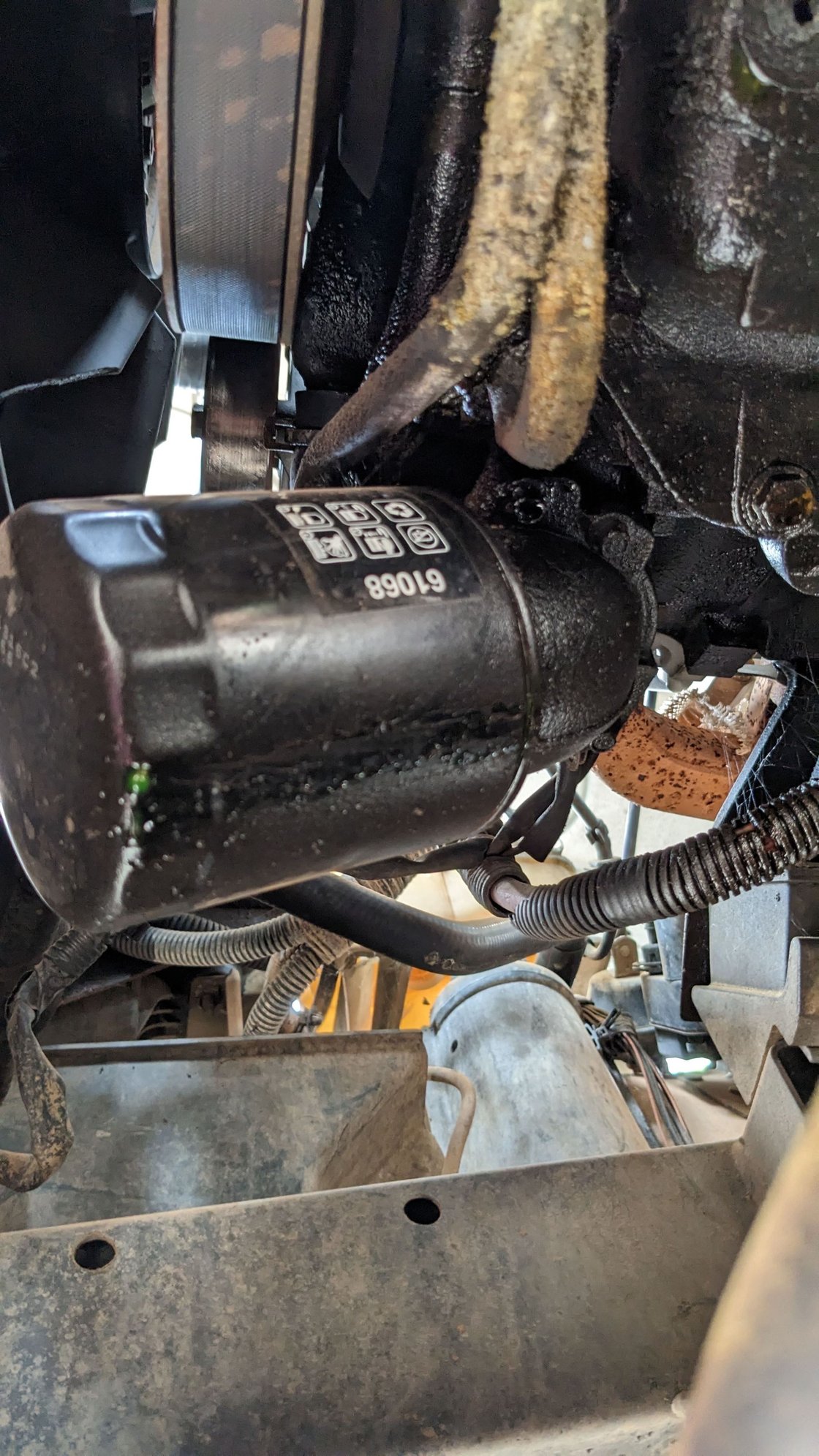

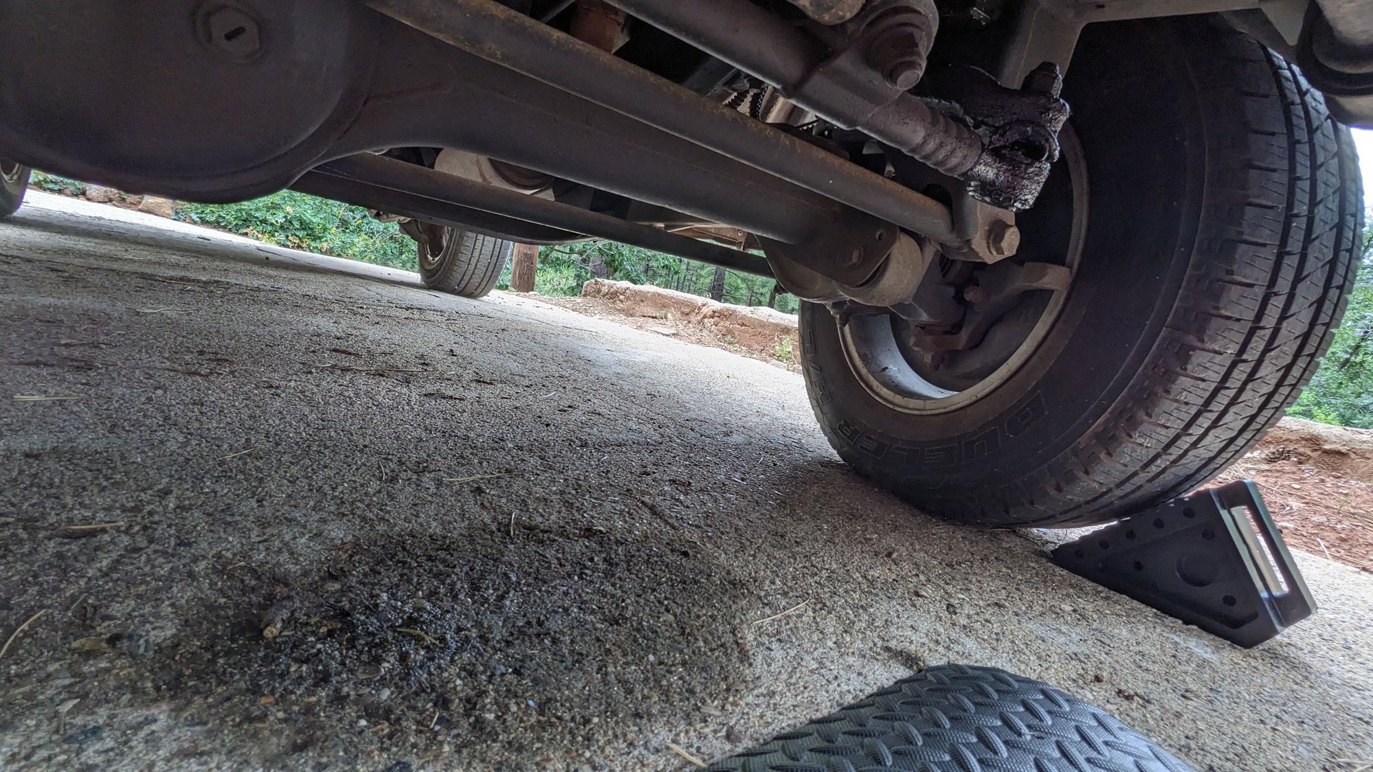

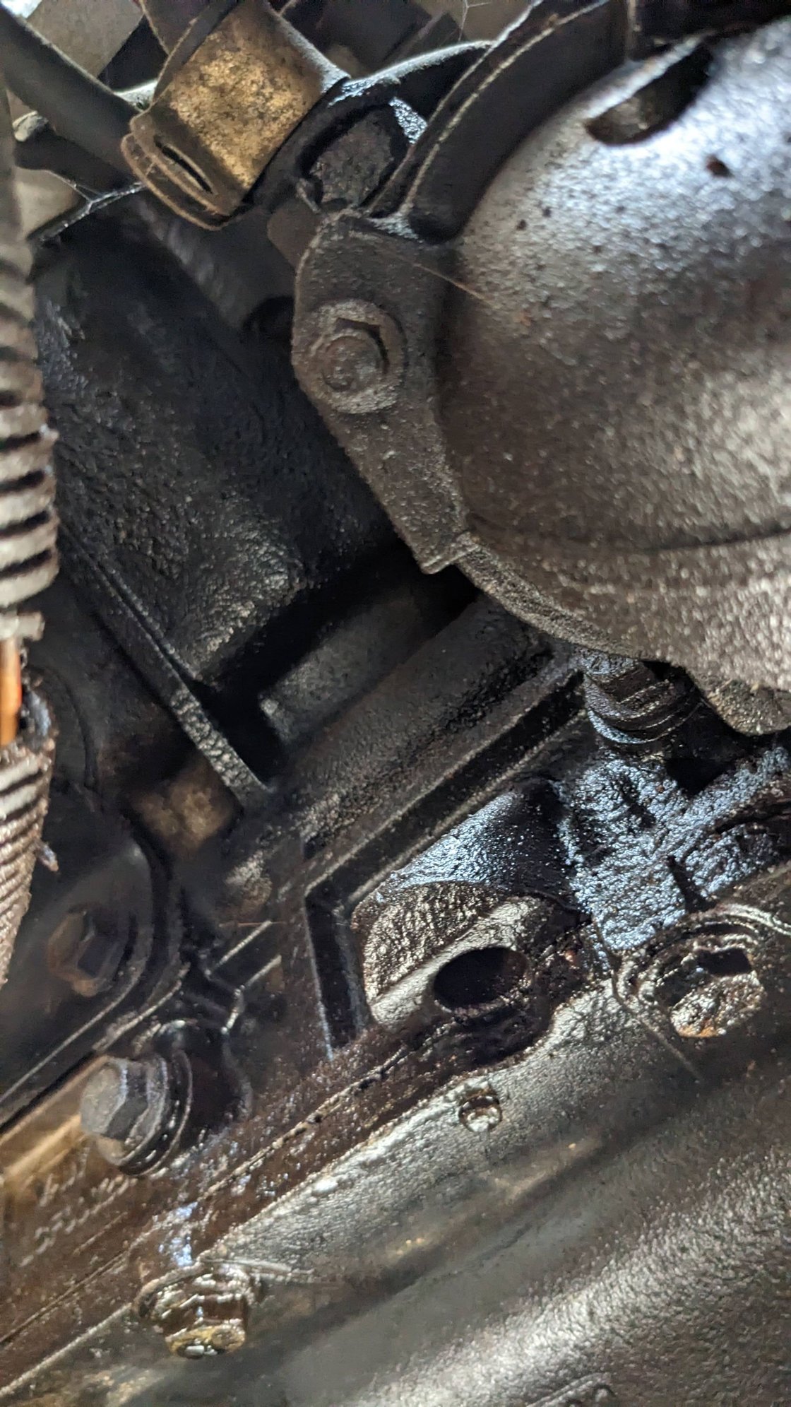

While I was preparing for the cooling maintenance, I saw some fluid on the ground. I also saw a lot of oily fluid on the undercarriage. I did not see anything on top or the sides of the engine. It felt more like oil than anything else. But I did see a green bead on the oil filter. I haven’t been running the engine in a couple of weeks. It spooked me, so I decided to change the oil first. I used Mobil one filter and mobile 10w30. Probably the wrong oil, but I read a few people like that oil.

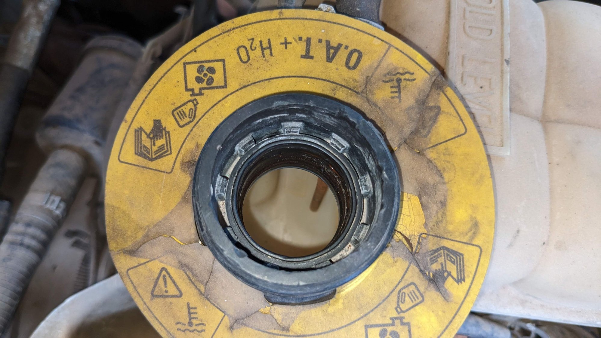

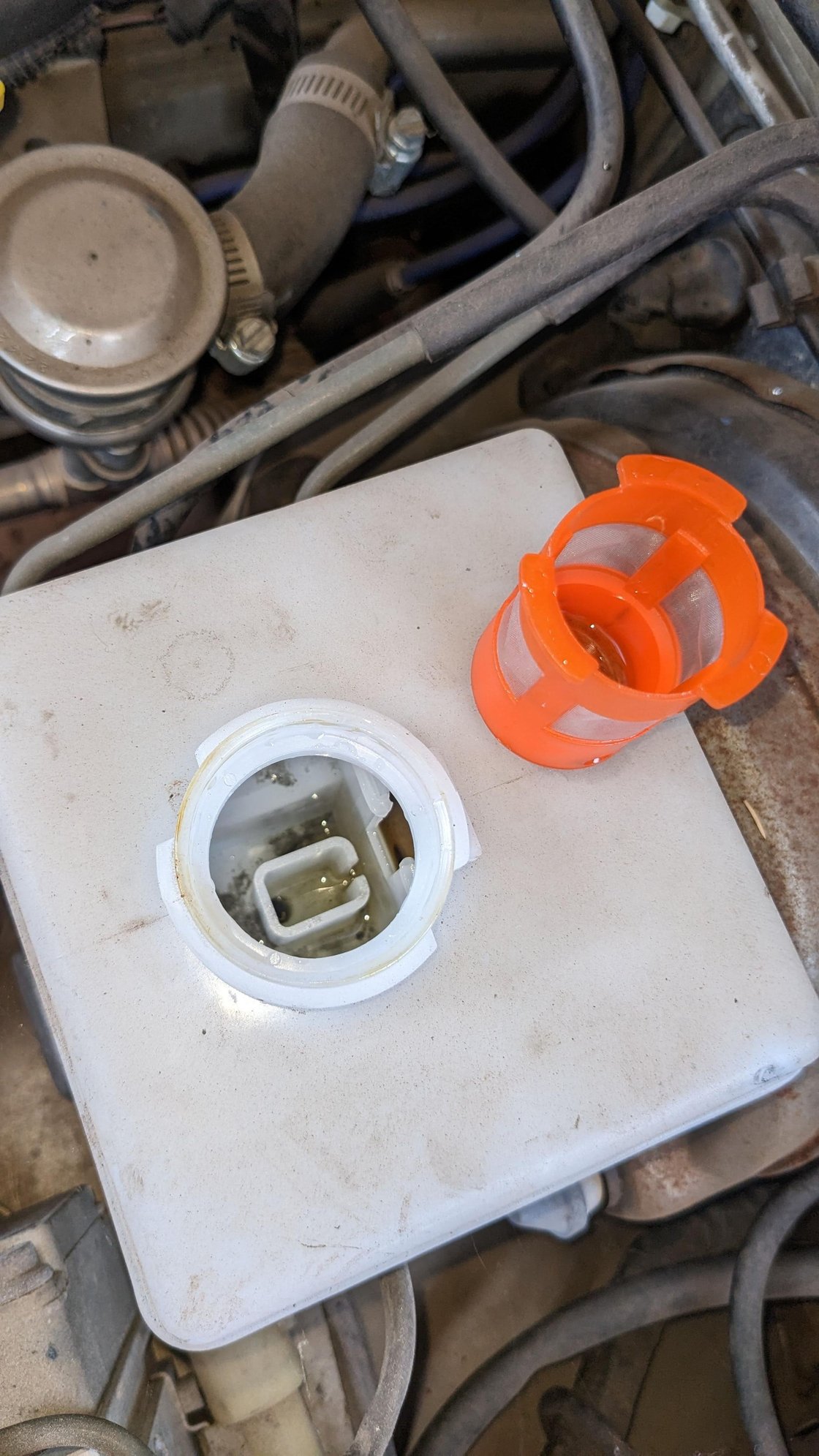

I looked in the coolant reservoir and it was bone dry. I also looked in the brake fluid reservoir and it was bone dry. The truck was sitting for a while, so I am thinking maybe some hoses got hosed.

Green bead on oil filter
Probably coolant? Though it felt oily.
Empty brake fluid reservoir, probably not a good sign?
Empty coolant reservoir…
A bit of fluid here, I thought that hole was weird.
More oily fluid.
More oily fluid.

As Richard said, you need to figure out your overheating. My first step would be to fill the coolant and bleed the air out. Then you can figure out where it is leaking. Where the brake fluid went is also a concern, but you won’t need the brakes until you can run the engine without overheating.
