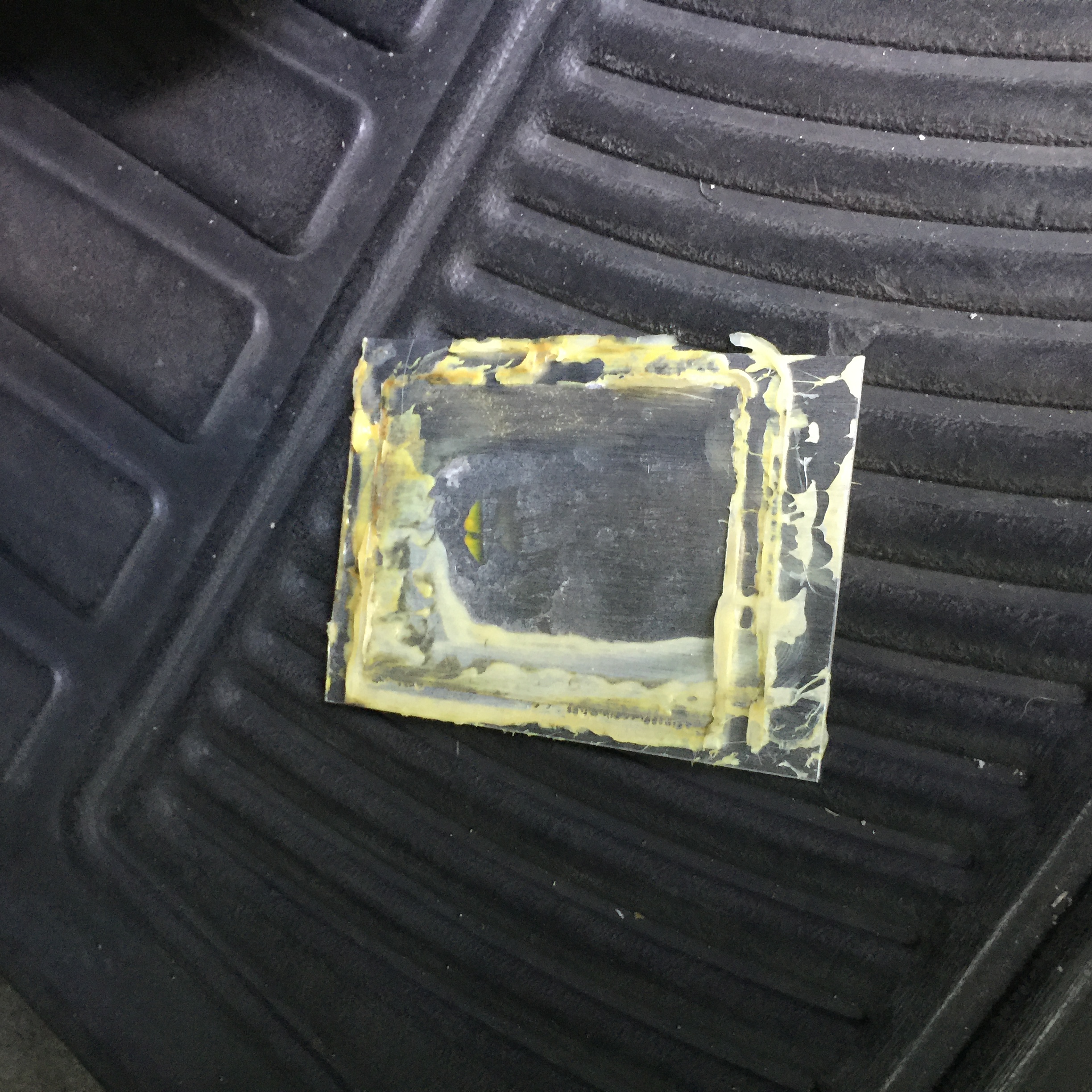

today I'm playing with ours and trying to fix this issue or at least to trace it down.
Well, it didn't take me long to discover that the PO wasn't very honest about the fact that the AC started to work not in full speed when he disconnected his old stereo system!
How did I came to that conclusion?
take a closer look to where the resistor "supossed to be " if this was an issue related to the audio removal...
Attached Thumbnails No Radio, No dome Lights, No lighters, AC on MAX Only-image.jpeg
Old Jan 16, 2016 | 11:43 AM
RawFaith's Avatar
Joined: Jan 2016
Posts: 302
yep,
that's right....
instead of a resistor I have this....
