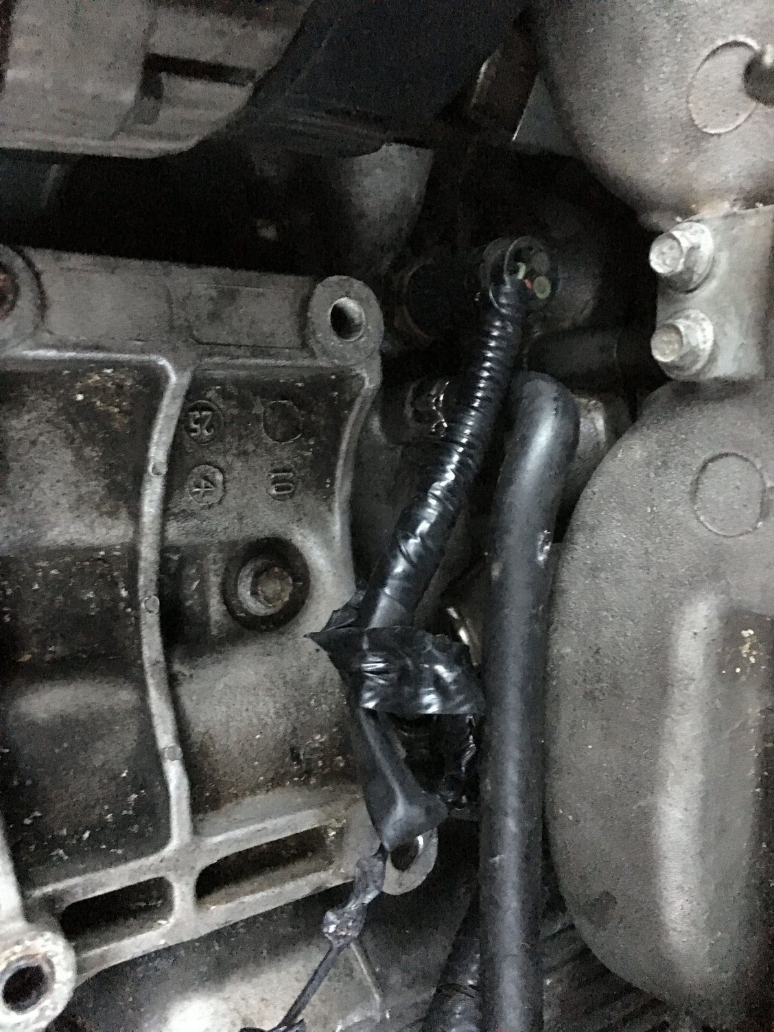

So I found this today but not sure if it could cause the issues I am having. What does this wire go to? Ground?
Single Black wire goes to a sensor and then branches back under the intake.

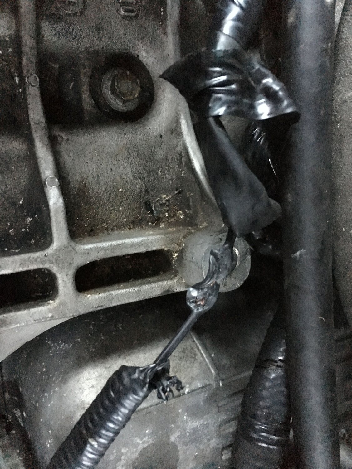

This is a close up of the damage. It looks like it was smashed under the compressor.
Old Mar 1, 2019 | 06:39 PM
  #40
Best4x4's Avatar
Posts: 7,997
Likes: 2,506
From: Beaumont, TX
Knock Sensor wire
