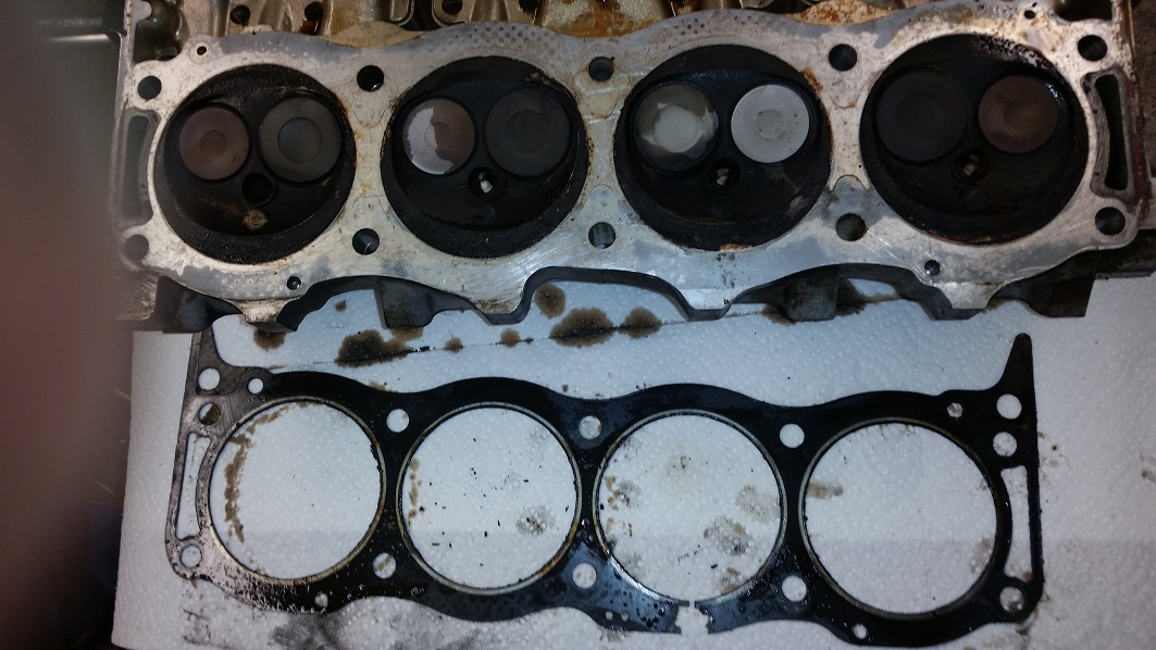

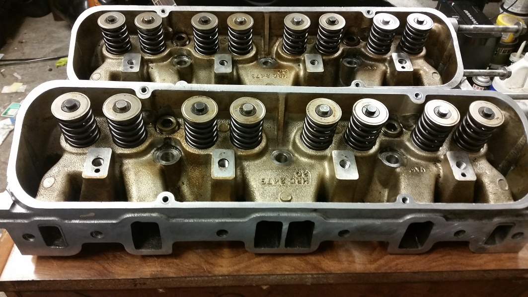

My 2004 Discovery SE blew its head gasket and being a brave soul, and incredibly naive, I decided to fix it myself... and a few months shy of 70 and not the fitness I may have been decades ago, undoing those head bolts was a task and a half.
I met obstacles on the way, I like grinding and lapping valves myself but had to import a UK made oscillating tool and the coarse/fine paste and, amongst the great advice I've received here, found a decent valve spring compressor at Sears.
So I have valves lapped, valve guide seals and valve springs replaced, and the heads back together (see photo).

I had, after the nightmares of undoing the bolts, given very serious thoughts to replacing them with studs and nuts, but everyone I have spoken to has begged me to keep using the bolts so I will go that direction.
