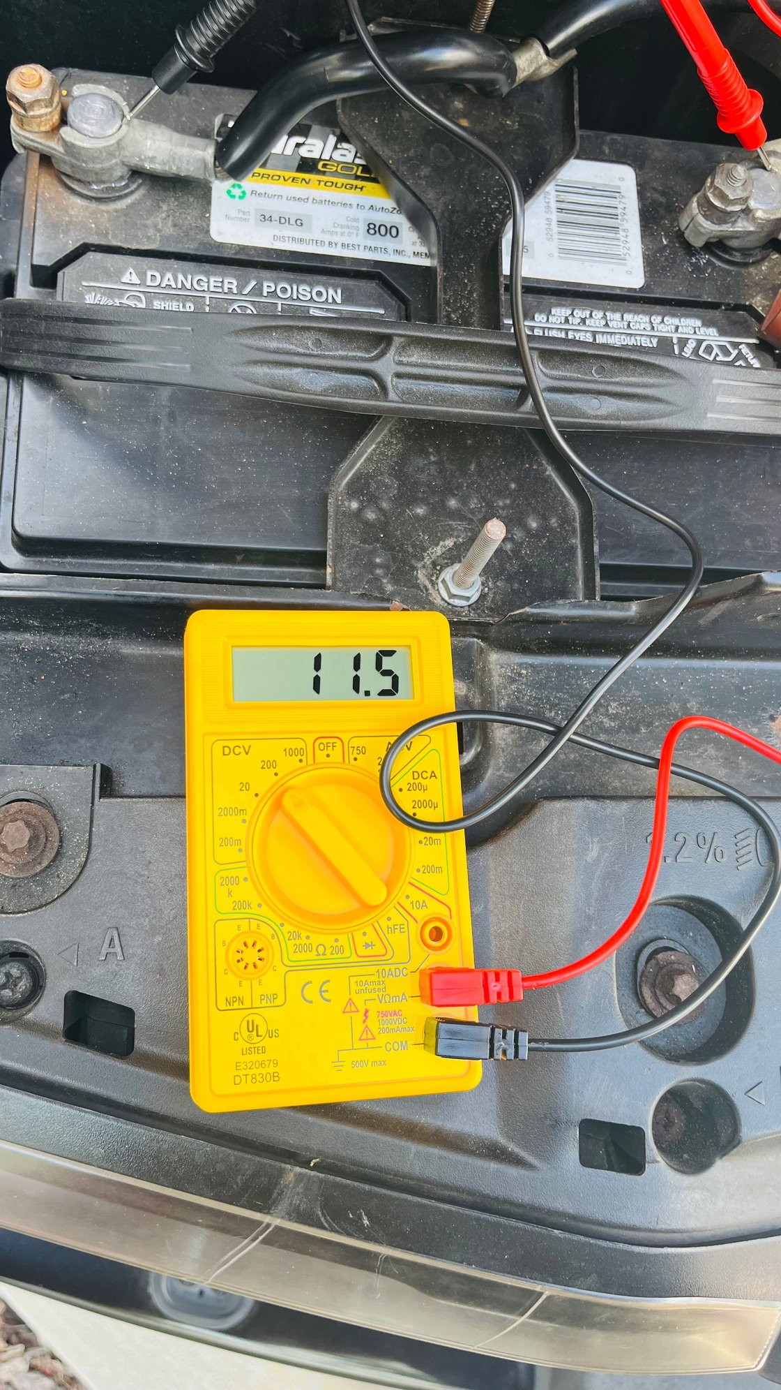

  2. I ran inside to find a bandsaw, opened the multimeter, and ran back out to the truck. Initial readings (which I didn't get a picture of) showed 12.1V to 12.4V depending on where I tested it. Alternator, battery terminals, battery leads.
  3. The missus is out of town so I had to wait until a stranger walked by and politely asked them to turn the ignition while I read the voltage...only now the volts had dropped to 11.3V to 11.5V - what does this mean? Bad/low battery? Because remember earlier in my post/yesterday morning when I would crank I got clicks, and when I jumped her with my second car I was also getting clicks, well into the evening. All of a sudden now, no clicks?

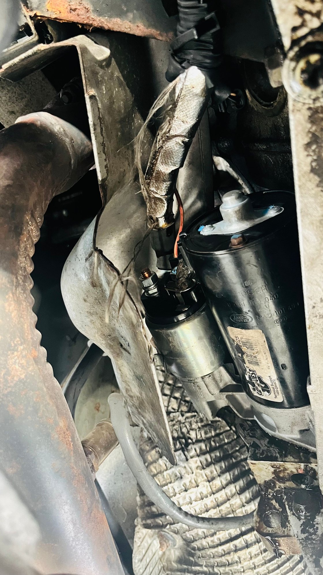

I also want to test jumping the starter but I'm uncertain what touch points were being referenced. Can someone guide me on this? (photo also attached)
Starter (top of image is front of vehicle, bottom of image is read of vehicle)
Voltage reading

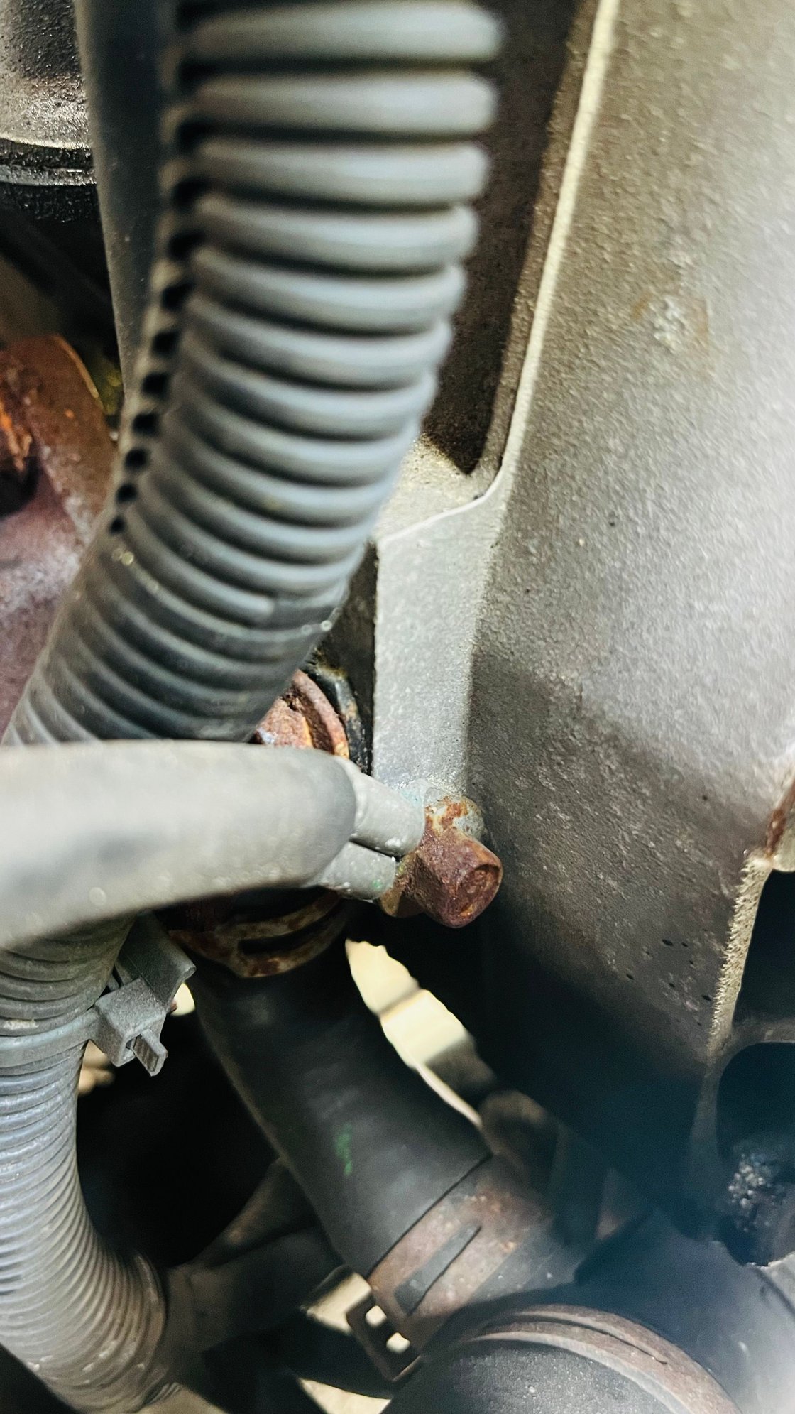

Alternator ground

Ground looks like crap, remove and clean everything, mounting point, bolt, and cable, both surfaces. 11.5 is too low, you might get starter to spin but truck likely will not start. On the starter there are two large nuts, one attaches the cable, the other attaches the starter conductor tab to the solenoid. Jumper between those two large nuts with a screwdriver. Did you jumper the relay yet?

@joefred16 Yea that ground is pretty bad, and 12.1 then 11.5 is a problem. I would check the entire ground cable and all the connections There are 3 on that one and clean them all up, check the cable status as well.

In first photo: 12 V on the red wire terminal should produce a small spark and clack the solenoid, then the starter motor should turn. A big wire jumper from the large bolt/nut to the black starter lead (may need to remove the plastic cap) will produce a big spark, then the starter motor should turn. Be very careful not to touch the jumper to any grounded metal (the spark will be even bigger).
In the second photo, it appears the body ground tab is disconnected. There should be a ground terminal right behind the battery to connect to.

11.5 is a dead battery. You definitely need to clean all of your connections, ground AND positive too. I'm leaning toward bad alternator. Clean all of those cables and charge your battery. With a fresh charge you should start. Either way, immediately get your alternator tested. You could also go ahead and pull it and take it to your LPS and have them put it in their tester.
