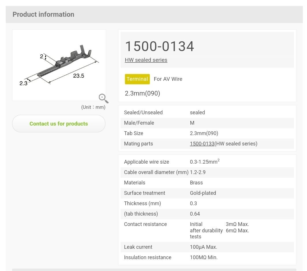

V8 O2 sensor 1 connector replacement. I've found the correct plug, seals and the 2 silver terminals but I can't find the 2 gold terminals. Does anybody have a source for these? They are Sumitomo 1500-0134

This is no good as it has 4 silver pins. The oxygen sensor and the plug on the car loom has 2 gold terminals and 2 silver terminals. The gold and silver terminals have different resistance. The gold is also less suspectable to corrosion. You'll also need to connect the wires with will also add resistance. The resistance will effect the readings.
Cheers for the suggestion though!
I've sourced plenty of gold terminals now. I might put little kits together so people can easily replace theirs.
