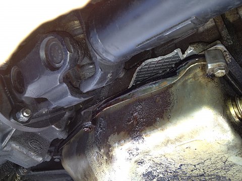

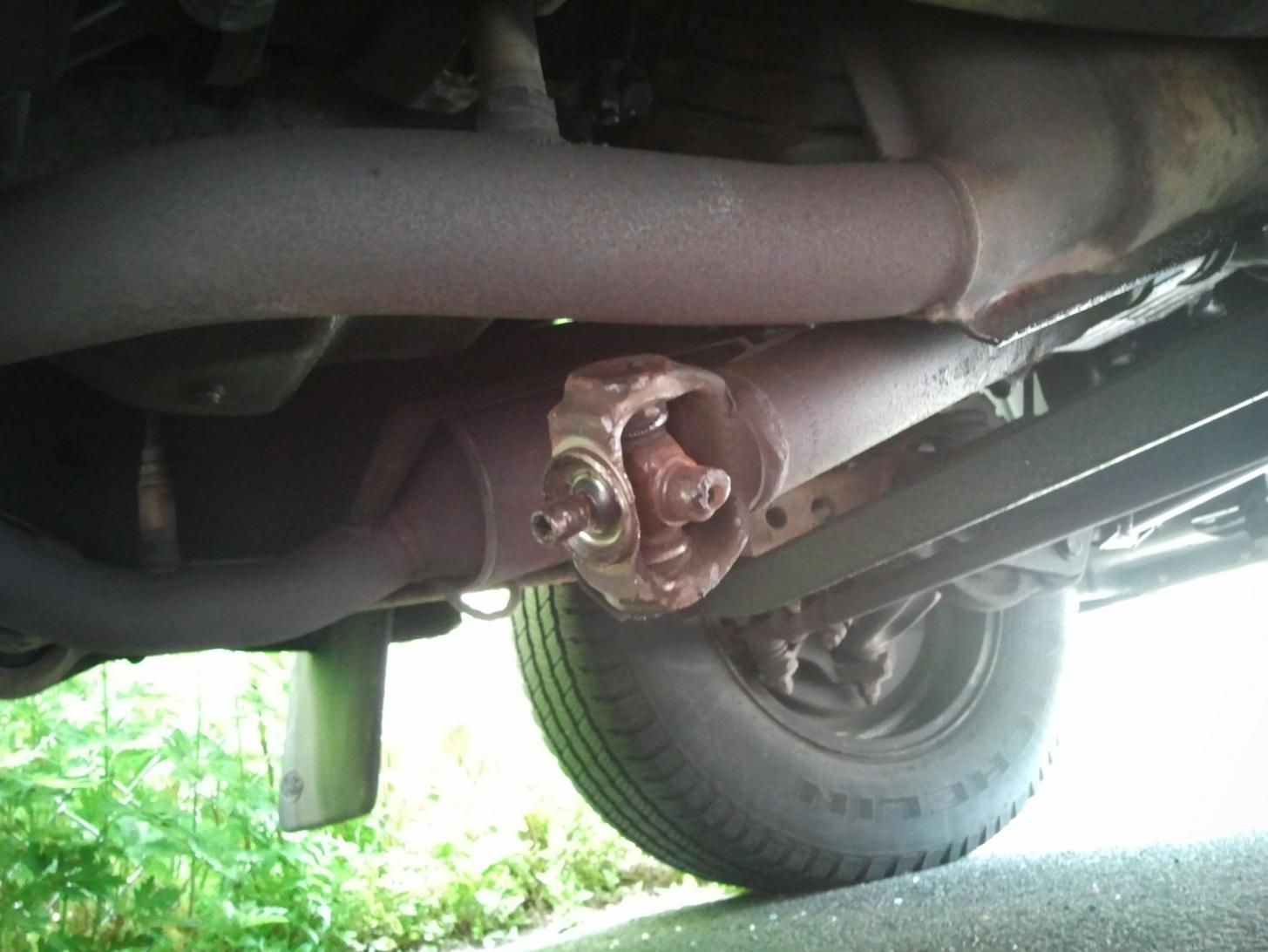

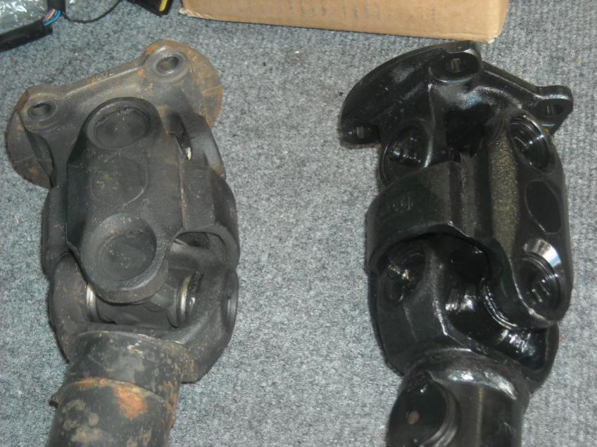

No, many drive with the shaft until failure. Or a new shaft is installed, and one from the dealer will be just like the old, no grease fittings. So problem repeats, baked out by heat from CATS. When shaft comes apart at speed the end of it flails around. Typically new D2 owners find out about this potential problem and put it high on their to-do list.
Brakes can be upgraded as in pads and rotors. Many do use aftermarket.
Pix of what happens with the front shaft, it can easily take out the tranny.
