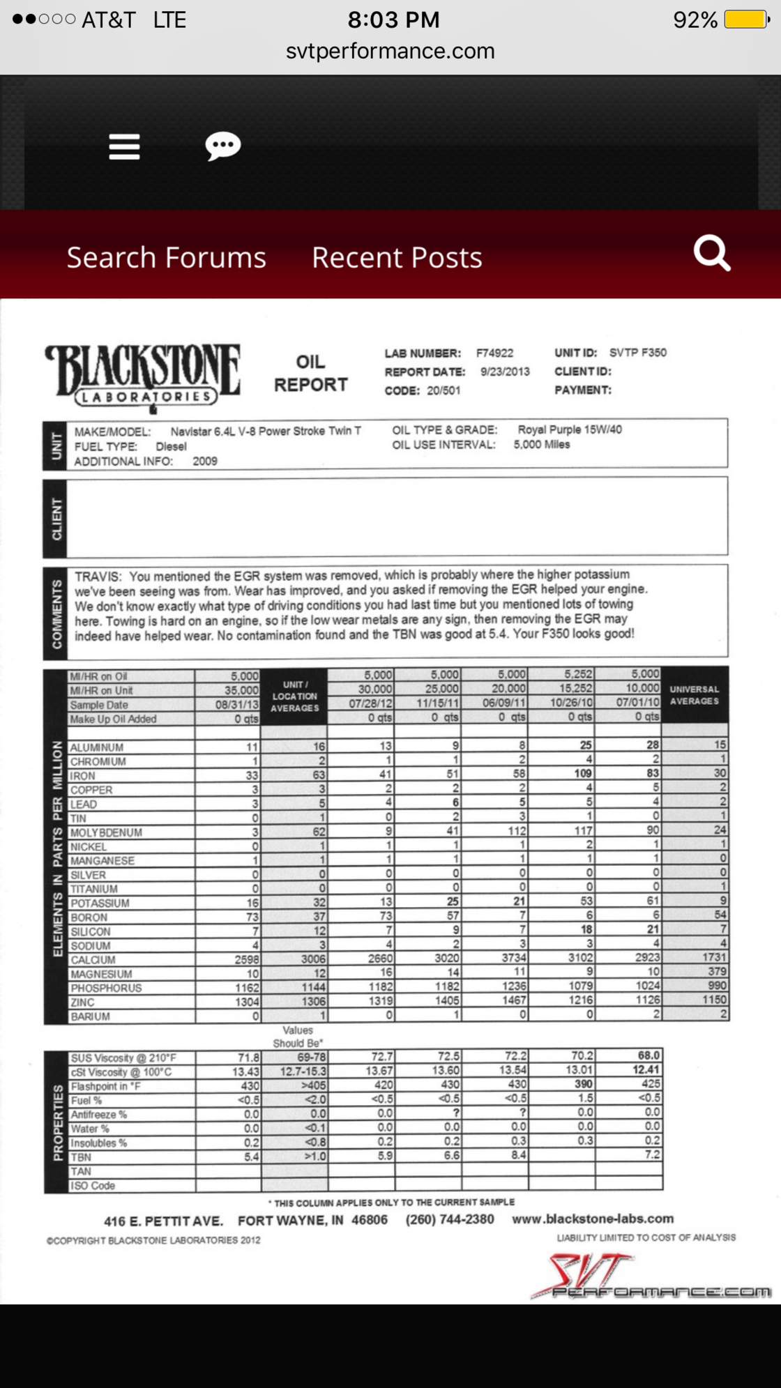

Here is an oil anyalis on royal purple 15w-40 from a ford diesel truck. Hope this helps. I use rp hmx in my work car due to the high zinc in it and if you get their racing oil (not avaliable in a 15w-40 though) it has the added zinc also.
