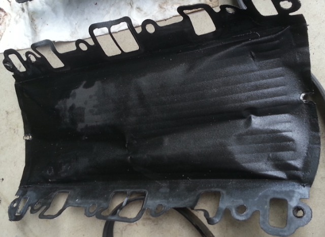

Have you done the PCV mod? Part of the design problem with the Rover V8 is the valve cover baffle plugs up over time and once that happens the crankcase gets pressurized and the pressure pushes oil out of the weak point in the gasketing system. Could be valve cover gaskets, could be crank seals, could be pan gasket, I have even seen the intake manifold gasket warped due to excess pressure. If that is the root cause, you may need to go back and reseal the gaskets after you fix the PCV.
