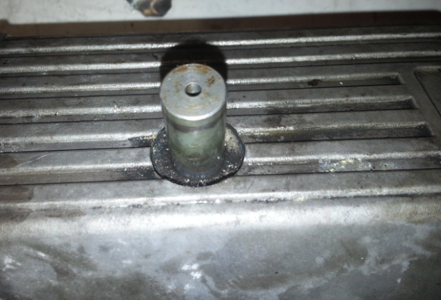

@austinlandroverbill On the 04 and 03 land rover decided to make an easy task hard, by putting a cover on top so you can not get the plastic thing out. Lots of carb cleaner around the base and inside, then set of needle nosed vice grips VERY IMPORTANT only at the very top or you could crush the tube, and gentle left/right turning while applying upward pressure got mine out, tiny bit of cursing helps too. The drill out is just for better airflow.

Thanks for the pics. Makes sense now.
Boy, it is a little breather hole.
I know my son put in a new spiral separator -- I paid for it -- so it's "only" 4.5 years old, maybe not too brittle.

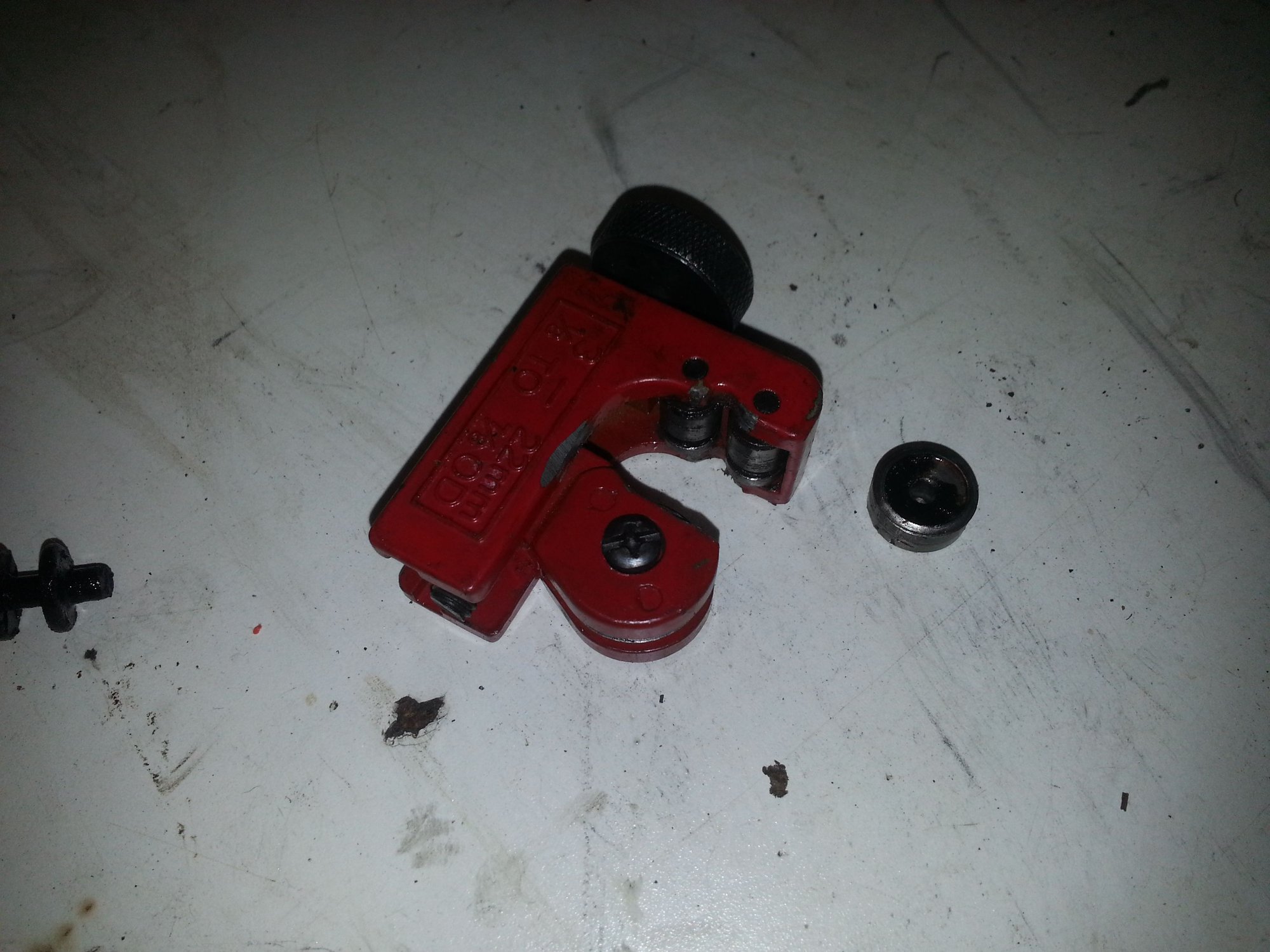

What's the deal with the pipe tubing cutter?
Did you use that as a wedging tool of sorts to get under and pop the top on the separator nipple?
Or did you actually have to cut off the top of the nipple itself?
Looking at the on-valve cover nipple, it looks like the perfect scenario for a small metal screw and slide hammer to pop it out?

@austinlandroverbill that should work but you do not have a lot of room to put the screw in. The problem with the separators is they get completely clogged and you get very little air flow leading to over pressure.
That tube is just a press fit - but it can be really hard to get out

Looks like he just cut off the top of the tube rather than drill it out. Which certainly eliminates the chances of crushing or deforming the tube while securing it in order to drill it out.
