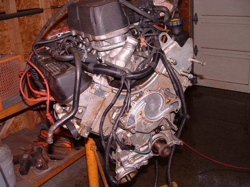

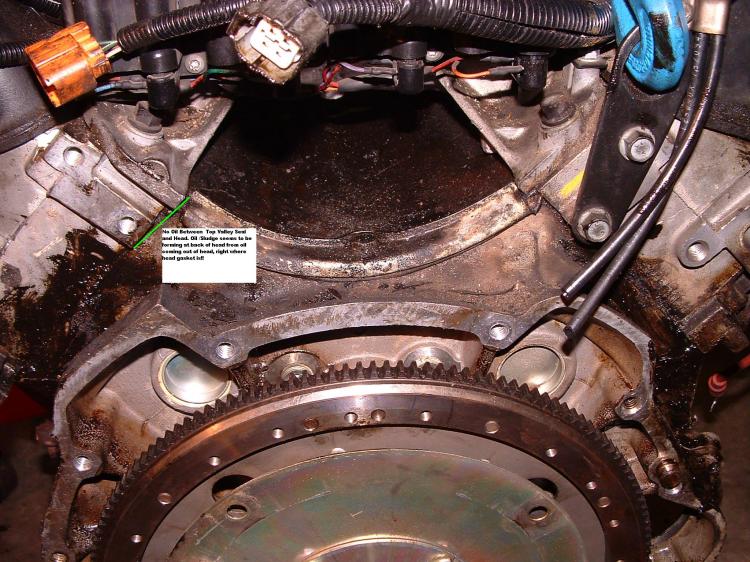

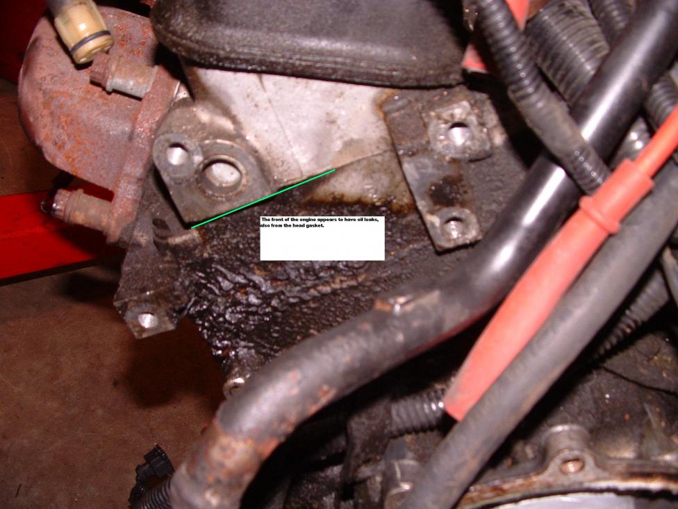

Hi: Removed a 4.o engine from a 1997 Discovery. From the heads down there was significant amounts of oil on the block and oil pan. Oil appears to have come from the head gasket joint along the back (worse) and from the front. I have read one suggestion which was a narrow beat of ATV on the head gasket (outside perimeter only) using the "Right Stuff"... I was of the opinion that one should install these gaskets "dry", but perhaps this is the way to stop leaks. Doesn't appear to have leaked from valley gasket,
Open to any and all ideas to prevent oil leaks upon reassembly.
Please give me your ideas on this one!

V/C gaskets mainly leak because the 2 bolts, that you can see, tend to vibrate loose, so keep them tight using a 8 mm, 12 point, 1/4" socket and you can usually stop the leak.
As for the head gasket leaking, replace them, installing them dry and you'll be set.
