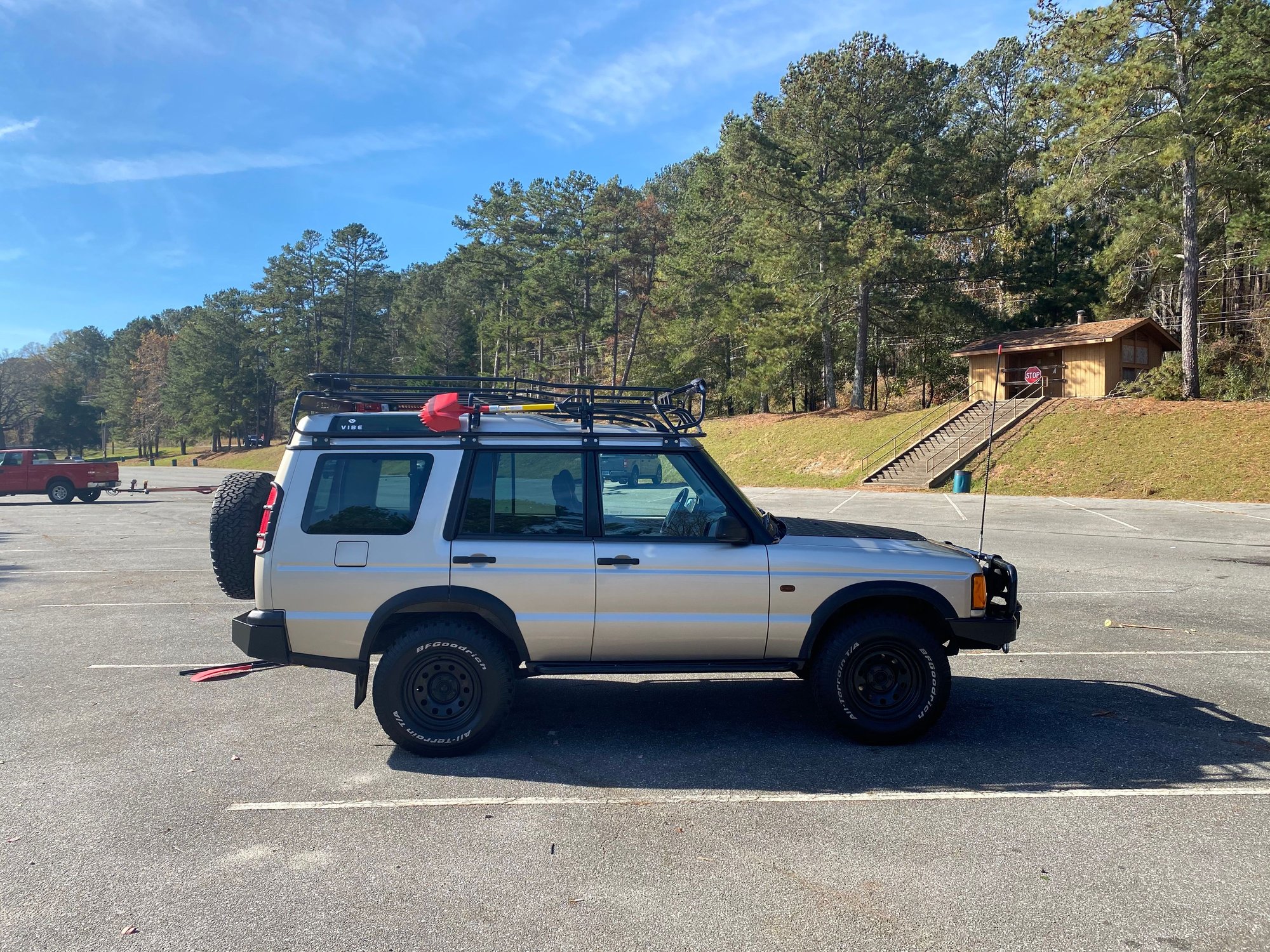

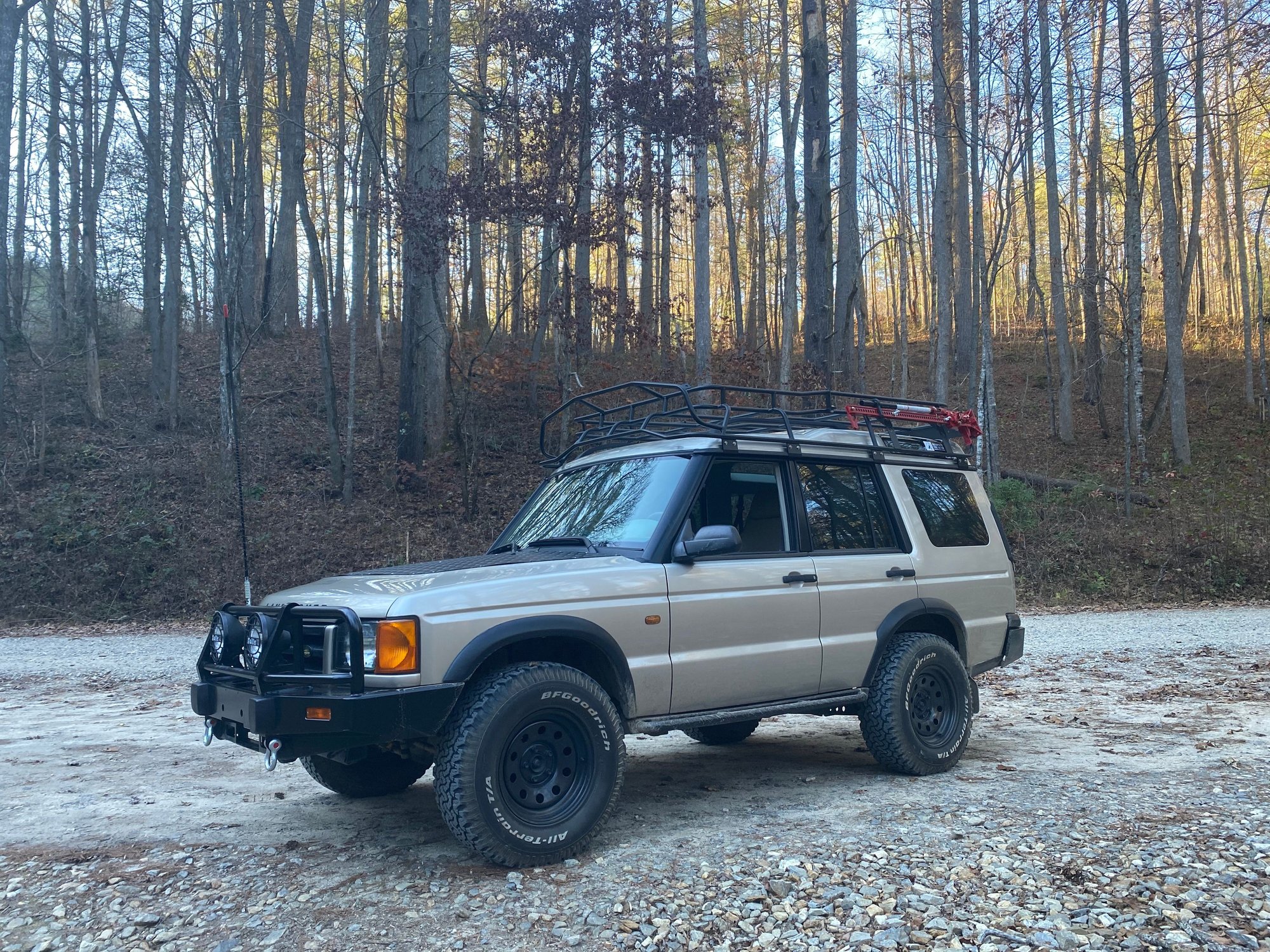

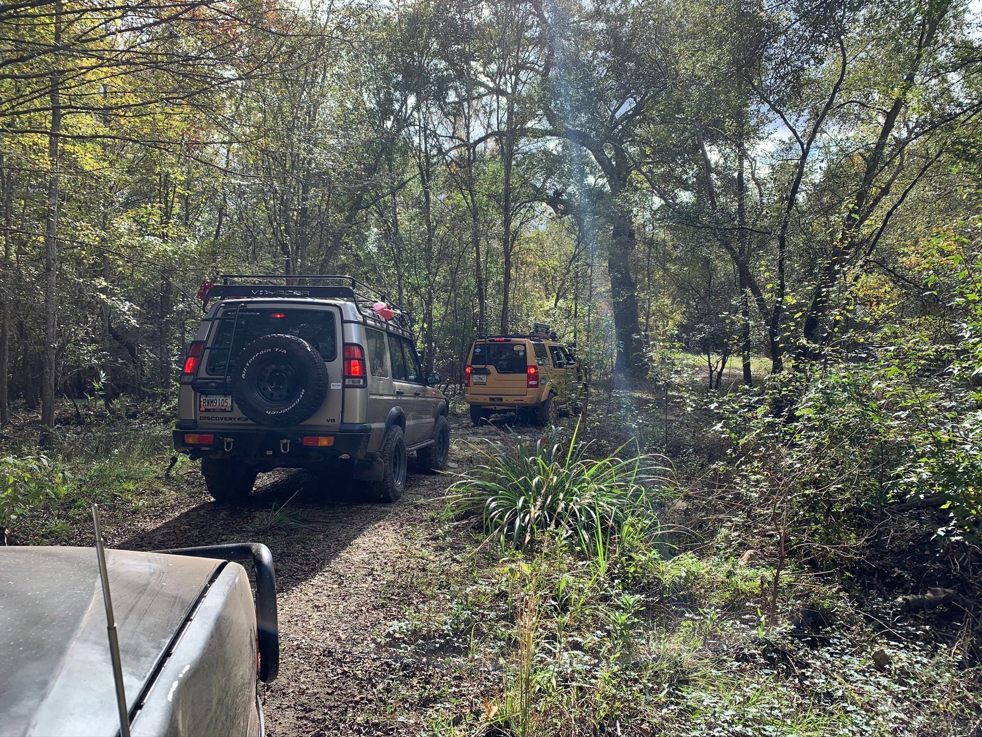

BTW, here's some pics. This is by far the best car I've ever owned. I bought it bone stock from a friend in perfect condition and it's become a great trail rig.
