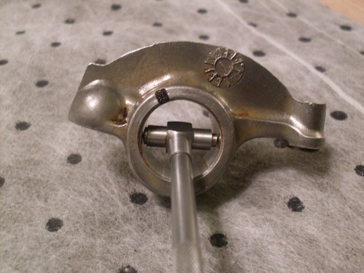

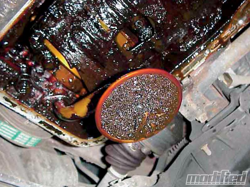

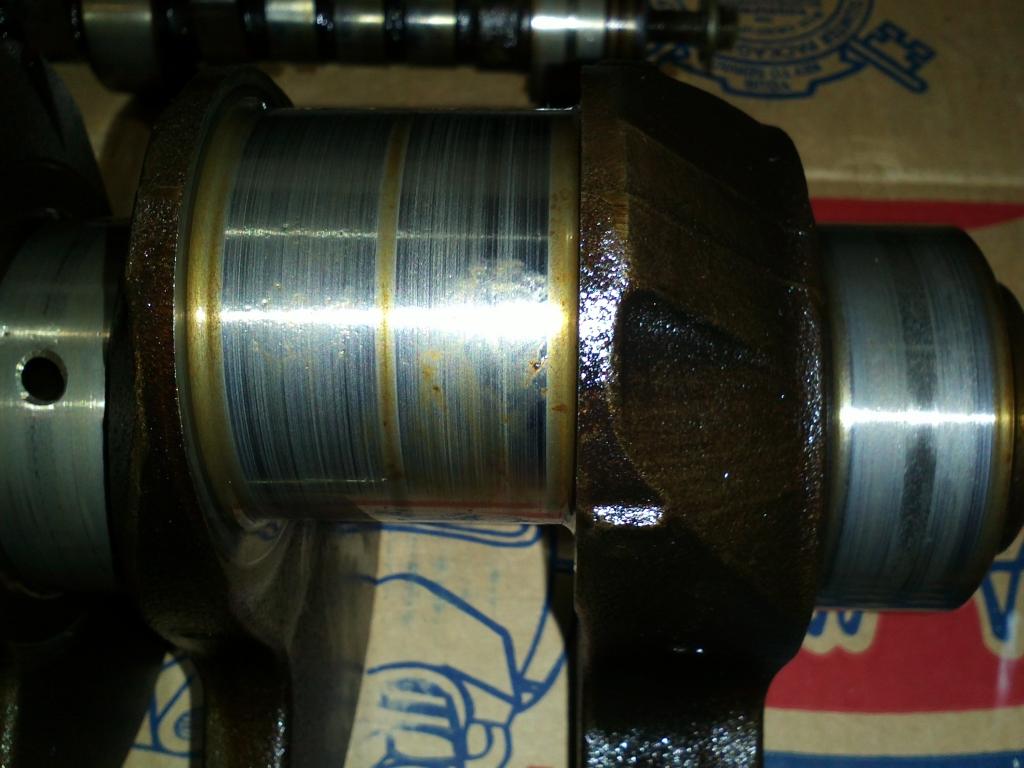

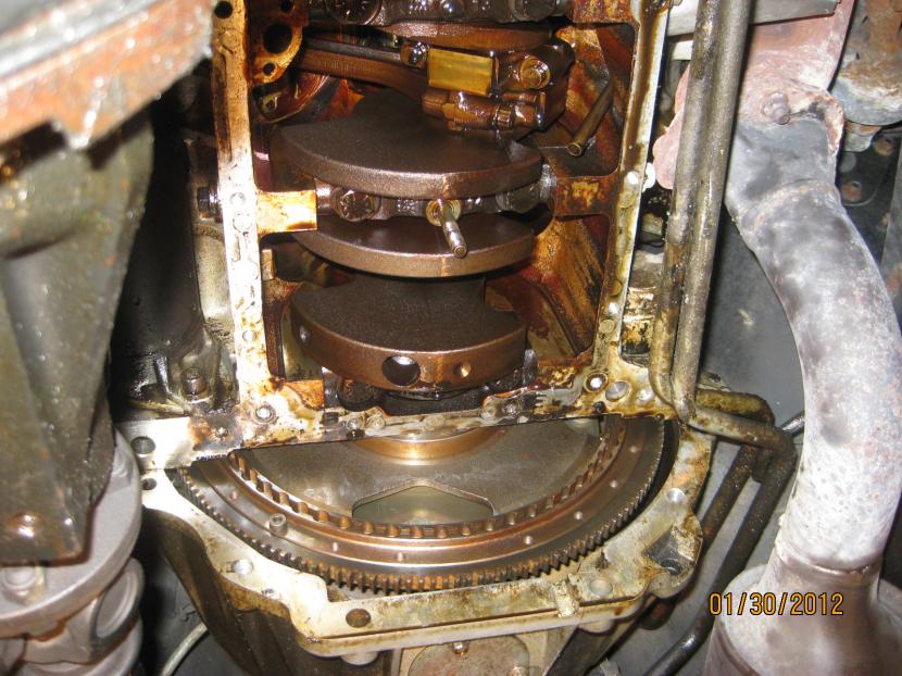

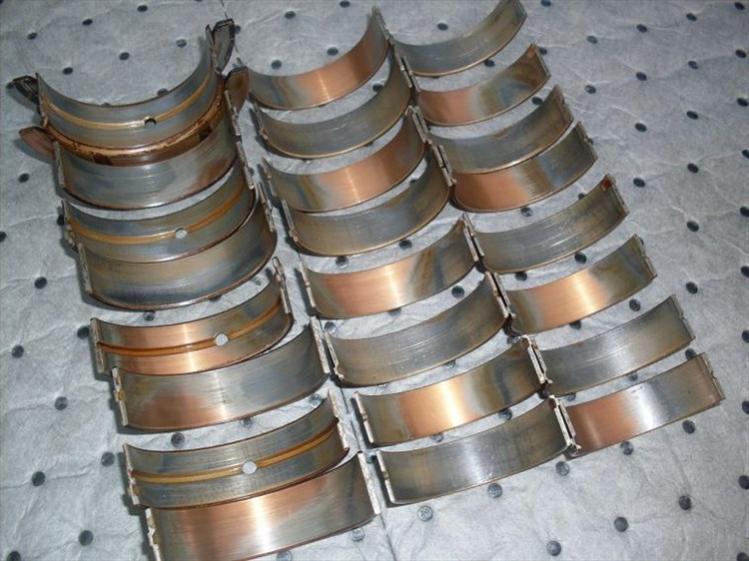

Perhaps a trip into the oil pan may reveal blocked pickup screen, or that pesky O-ring or gasket for the pickup tube (sucking air, not oil).
Also, if it is the mains showing copper the crank should be examined, some have cleaned up with emery cloth, a worn crank will quickly eat away new bearings.
With wear on the mains, you would expect wear on the top end parts as well.
Pix of a pick up screen gunked (non Rover), mains showing copper, crank needing attention, pickup tube port in top left, rocker. The tube the rocker rides on can also have enough wear to drop oil PSI.
Considering the D2 spec is 50 PSI hot, that 30 PSI figure is not good news. 20W50 and 10W60 oils come to mind, needs to be warm weather.
