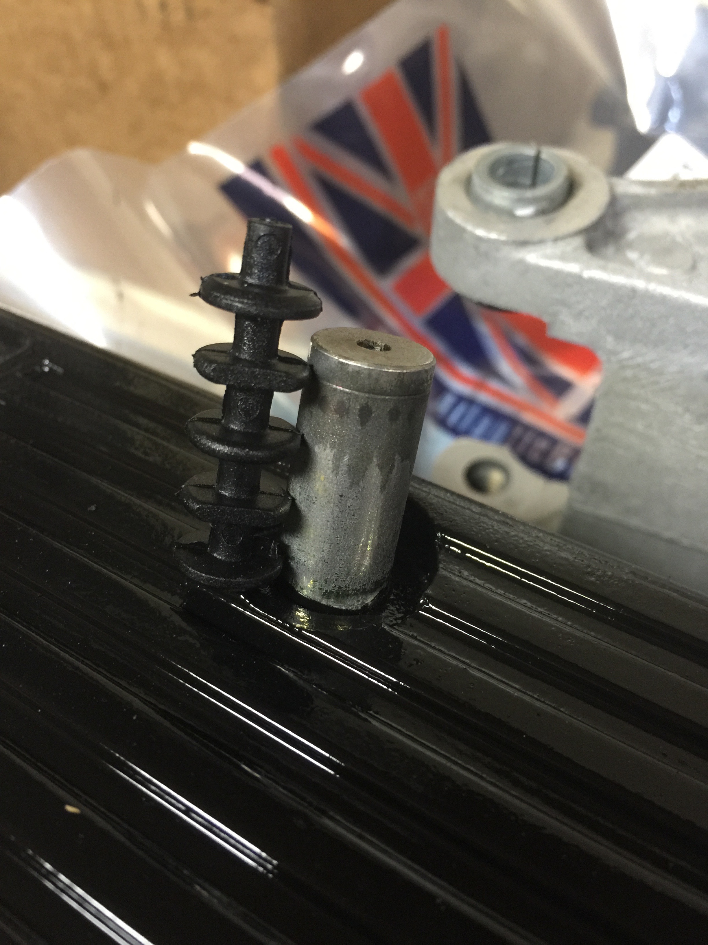

Anyone know what way the oil separator sits inside the valve cover? It has a flat end and a pointed end. And my valve cover has the cap on it.
2003 4.6l

It does not really matter which way you insert it. I had to trim mine slightly with a Dremel cut off wheel on the outer circles to make it slip inside the orifice. I also drilled out the the hole about a 16th bigger.

As a form of maintenance, consider spraying carb clean thru the tube on to the separator to prevent any blockage. I have done this once a year for the last 13 or 14 year and never had to replace it.
Also consider cleaning the t/body at the same time for better crankcase flow.
