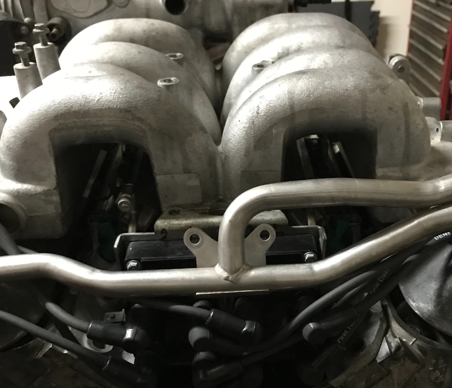

When I got my truck, I noticed that the bracket pictured here on the SAI piping was sticking up behind the intake. I surmised that the bracket had been bent up to replace coils or wires by the previous owner.
Today as I was mocking up the plug wires I remembered this bracket and wanted to see if it mounted to the back of the intake or coil bracket. No go. Even if the bracket was bent downward by 90 degrees there are no corresponding mounting point. Am I missing a bracket for this??

If I remember correctly, there is a little black metal plate that bolts into the coil pack and has a 90 bend up that holds the SAI pipes in place. I don't see it in your picture.

No, I don’t have any black bracket. Looks like another trip to the pick n pull.

Unfortunately, I can't find a picture of it. The only reference to it in the RAVE is on page 17-2-63. The top left picture shows taking the plate off. Maybe someone else has a picture of it? Some one that ditched their SAI might have one they could send you?

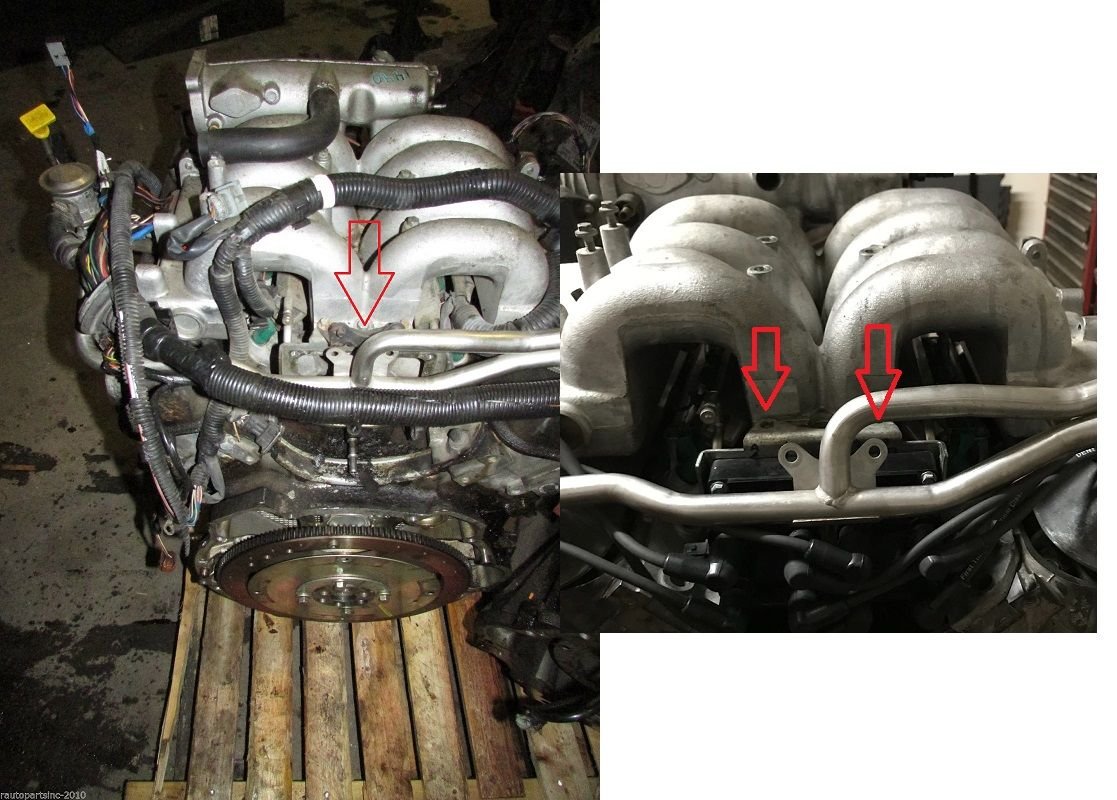

Yes, you are missing the bracket
