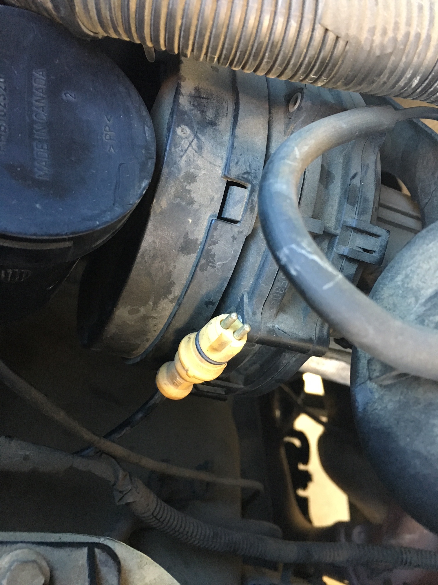

Default That was fast - do you know what this plug goes to...
should I be concerned? pic attached. I found it near passenger firewall.

I wouldn't be concerned, just be sure to get a new one. If your flywheel does catch a rock that's gonna be a really bad time.
As for that which you just found, that's a wheel speed sensor plug. There should be a female end that looks just like it somewhere around. Just fond it and plug them back together. You probably have the 3 amigos illuminated since its unplugged. If they have been on long enough then you'll need a special scanner like an ABS Amigo to clear them. Otherwise your ABS and traction control will not function.

That is an ABS sensor plug. You should have an ABS fault

unless it's been updated with the hard-wired sensor and someone just left the old wiring there

Thanks, I have no ABS faults showing up, and I cannot locate the other end to the plug anywhere. So like jbarr89 said its probably a left over.
