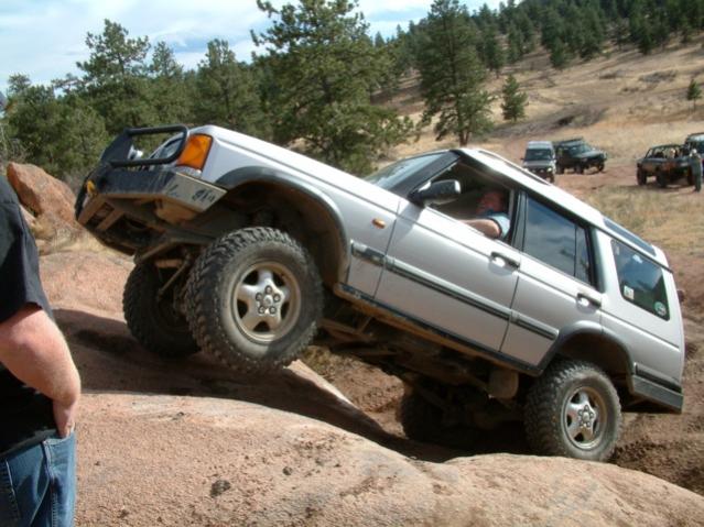

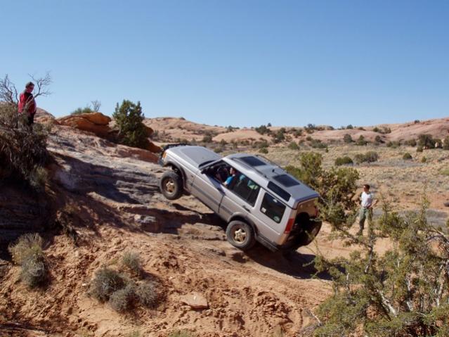

Here is my 99 D2 with SLS and ACE at over 100,000 miles of trails, the likes of which most people can only dream of. This all the answer you should need.
Attached Thumbnails OME Suspension Kit with SLS or Springs??-dscf0026.jpg   OME Suspension Kit with SLS or Springs??-p4130043.jpg

Mike your D2 is Amazing and it took you pretty good work but if you were to travel to lets say south america or just stay in colorado desert without being able to get parts for weeks and be in the middle of nowhere by yourself and no possibility of towing to anywhere relatively close to your home.... would you still keep your SLS air springs or go with Coil springs?? do you trust the SLS system that much.... maybe i would travel with extra air springs in case of anything but still.... do you get my question now???
