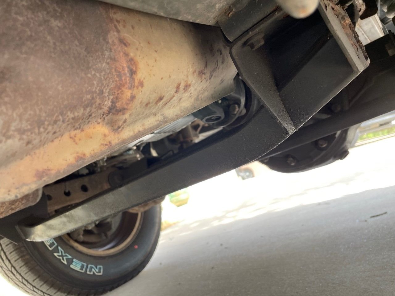

@Best4x4 Is this the front support that needs to be removed? It looks structural. No frame twist issues with removing this? thanks.

If your frame twist with that removed = you have bigger problems lol. Zero issues on 3 D2's with that removed.

10-4. I guess I'm just used to my Landcruiser and 4Runner which have aluminum skidplates from front to back.
