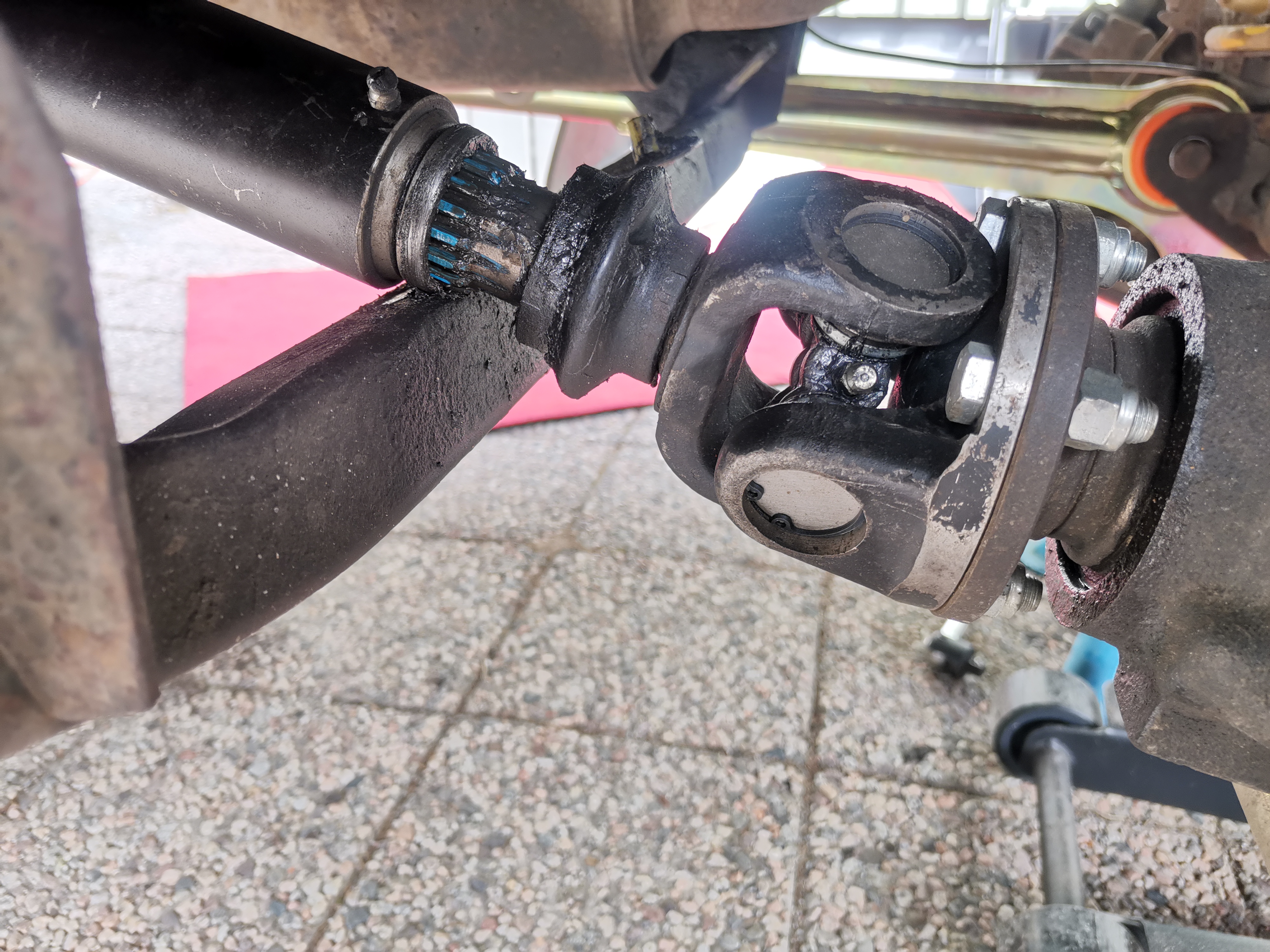

This is with 3" suspension lift on a 2003 TD5.
No space for any flexing.
There were signs of rubbing even on the 2" lift the truck had when I bought it. The rubber on the shaft was "cut in half".
But on 3", there really is no other way than remove that cross member. There are spacers for it to bring it lower, but I wouldn't go that way.

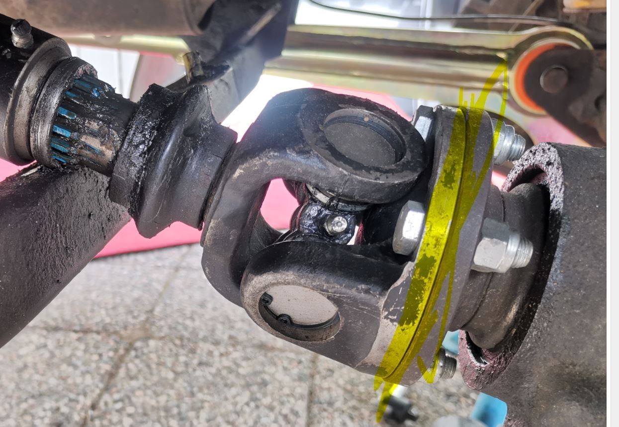

Good point! if its tried and true to remove then thats what I will do. Quick question. Does someone make like a 1/2 inch or 1 inch spacer to go in between the driveshaft flange and the diff flange? Looks like you have some teeth showing when flexxed and a spacer here would be alot cheaper than having an extended shaft made. Thanks.
EDIT: Never mind, I answered my own question. Will I need a spacer for a 2 inch lift?

Can't say anything to that prop spacer, but those teeth show because the rubber boot over them is shot.
And it's normal to see them, as it slides in and out due flexing. If You look carefully, You can see that the grease nipple has also hit the cross member.
That pic is with the stock front prop and I now have this installed.
https://gwynlewis4x4.co.uk/product/d...dc-d2-ext-600/

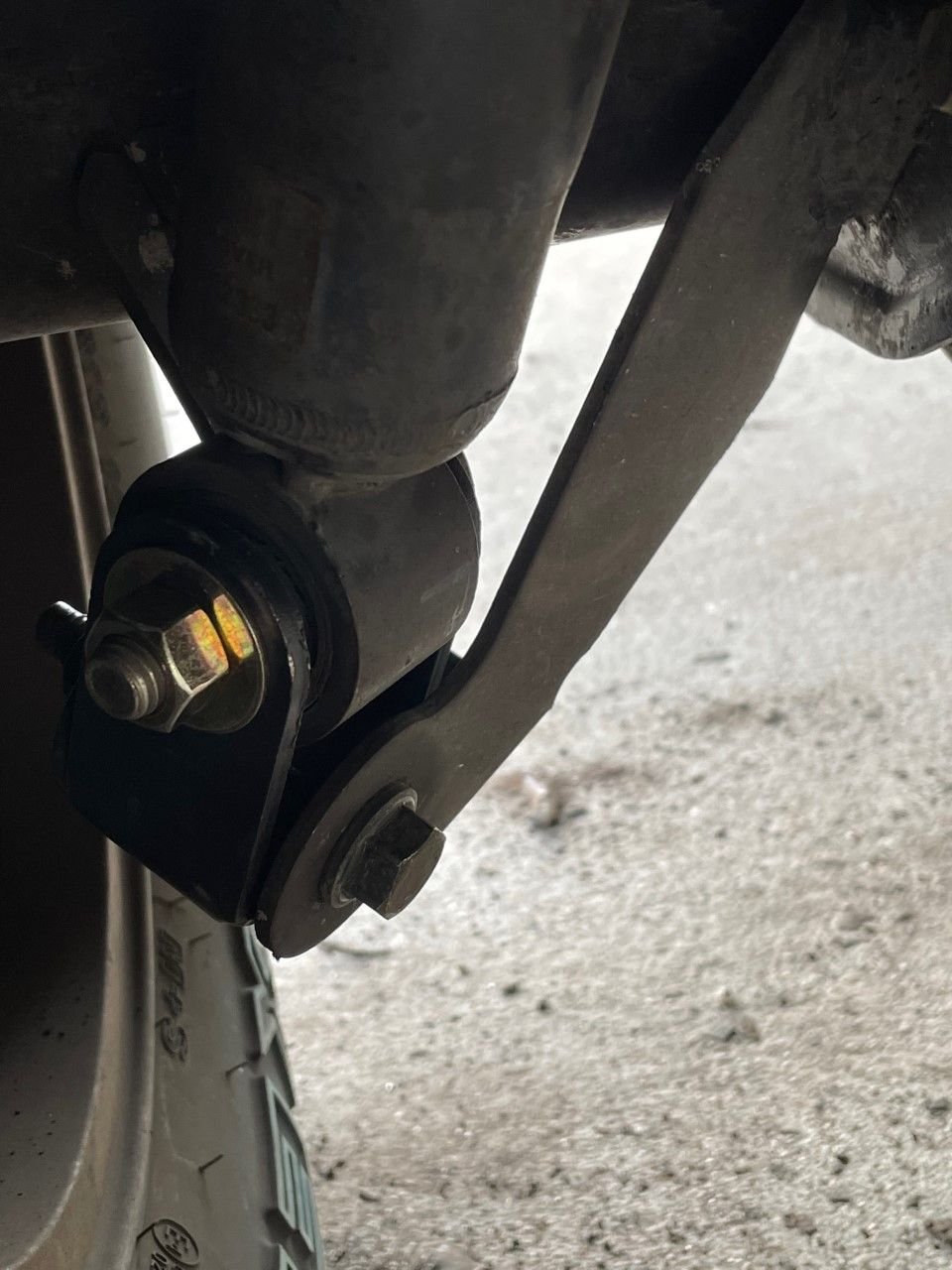

Got the rear lift installed this afternoon after work. Ill hit the front tomorrow morning. 2 inches really is 2 inches with a spacer lift! The 99-up Chevrolet Silverado 1-3 inch extended shock brackets work just fine. The one thing to point out is that the hardware that comes with them is bigger than the shock eye hole. You can either get smaller hardware at the hardware store, or do as I did and drill out the shock. There was plenty of steel left after drilling out. I'm going to need new shocks in very near future anyway. I believe these to be the stock shocks from 2001!! I'm eyeballing some Bilstein 4600's. They ride so smooth and I can buy stock sized shocks available in most parts houses.
