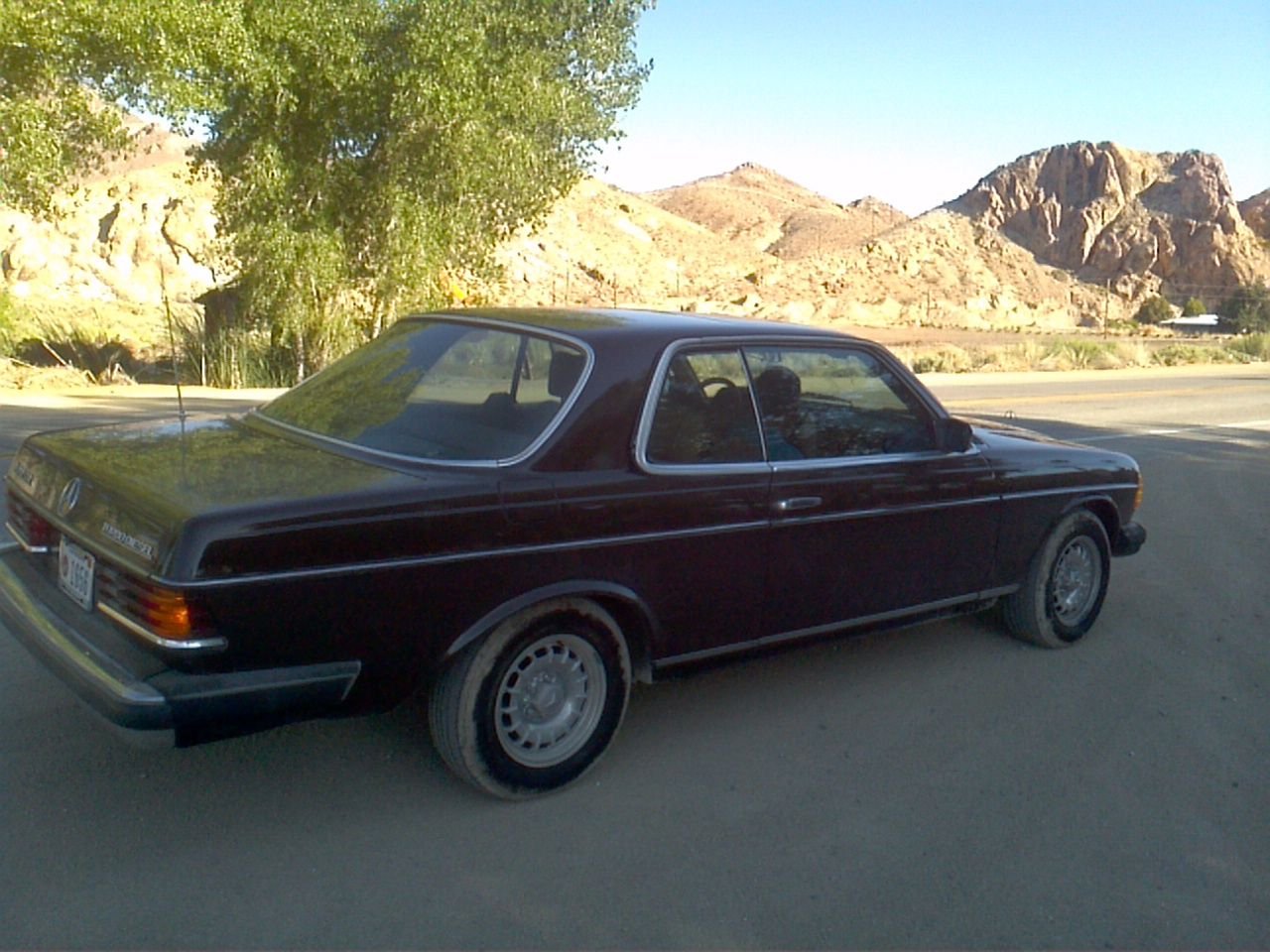

Damn Charlie, is that the scenic view from your driveway? Unbelievable. I didn't know you had hills out East

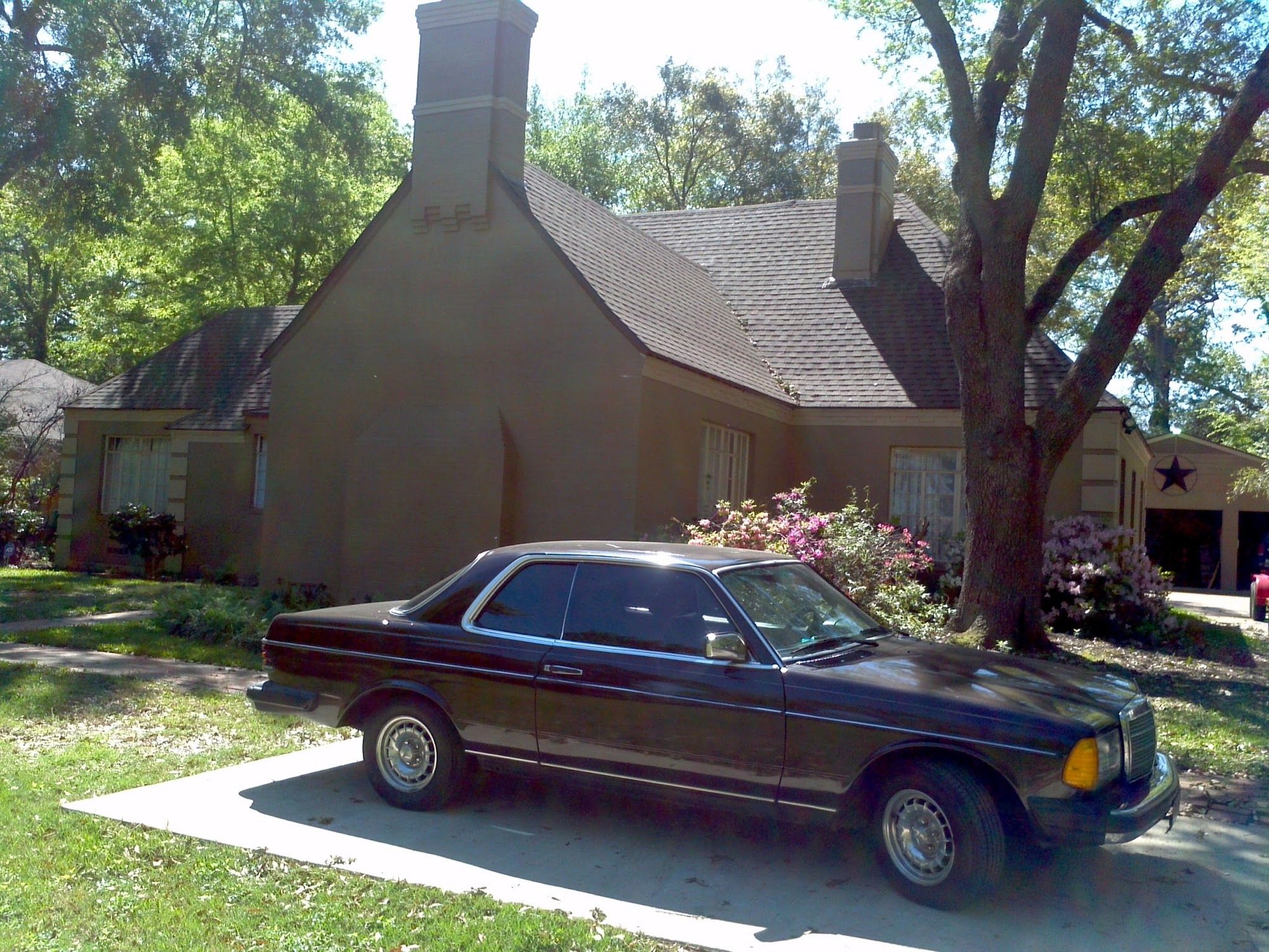

No, that was taken on the fateful 1700 mile trip. It did make it back to my little hovel in the piney woods:
