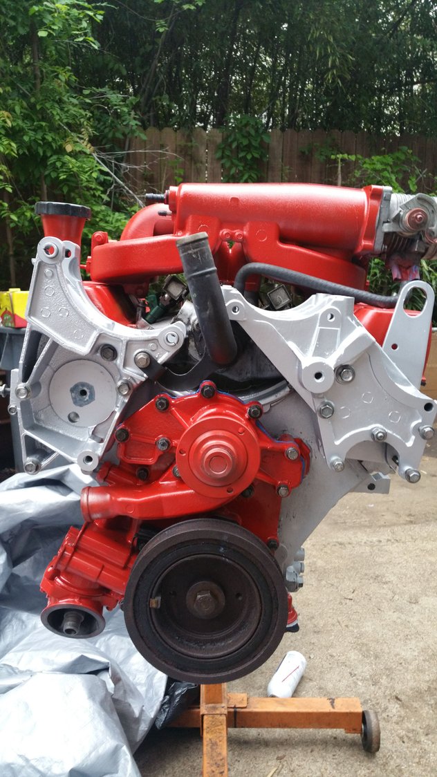

Take heart. I painted my engine and it still runs like crap.
I really thought the paint would bring it in line. Polish on a turd.

The painted engine (above) has a persistent misfire that I'm ridding in another thread, and I've almost decided that I have bent valves due to an unfortunate and stupid act on my part of turning the crank by hand without the timing chain on. I was tired and not thinking. If you run out of ideas I will have done a compression and leak down test in the cylinders by then and may be able to contribute some low budget way of conducting those tests (because that's my budget for the Disco these days). I doubt you have a bent valve but a burnt valve is possible if you have eliminated everything else and the test would find it.
