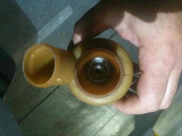

Heres the plumbing layout.

Possible causes - bad hose / clamp caused coolant loss, resulting in over heating. Had to happen fairly quick. Could be plugged thermostat (see those little holes in pix) or heater core. Could be head gasket, although the norm is over heat again and again, etc. Could be radiator plugged with dexcool sludge (don't refill with that).
