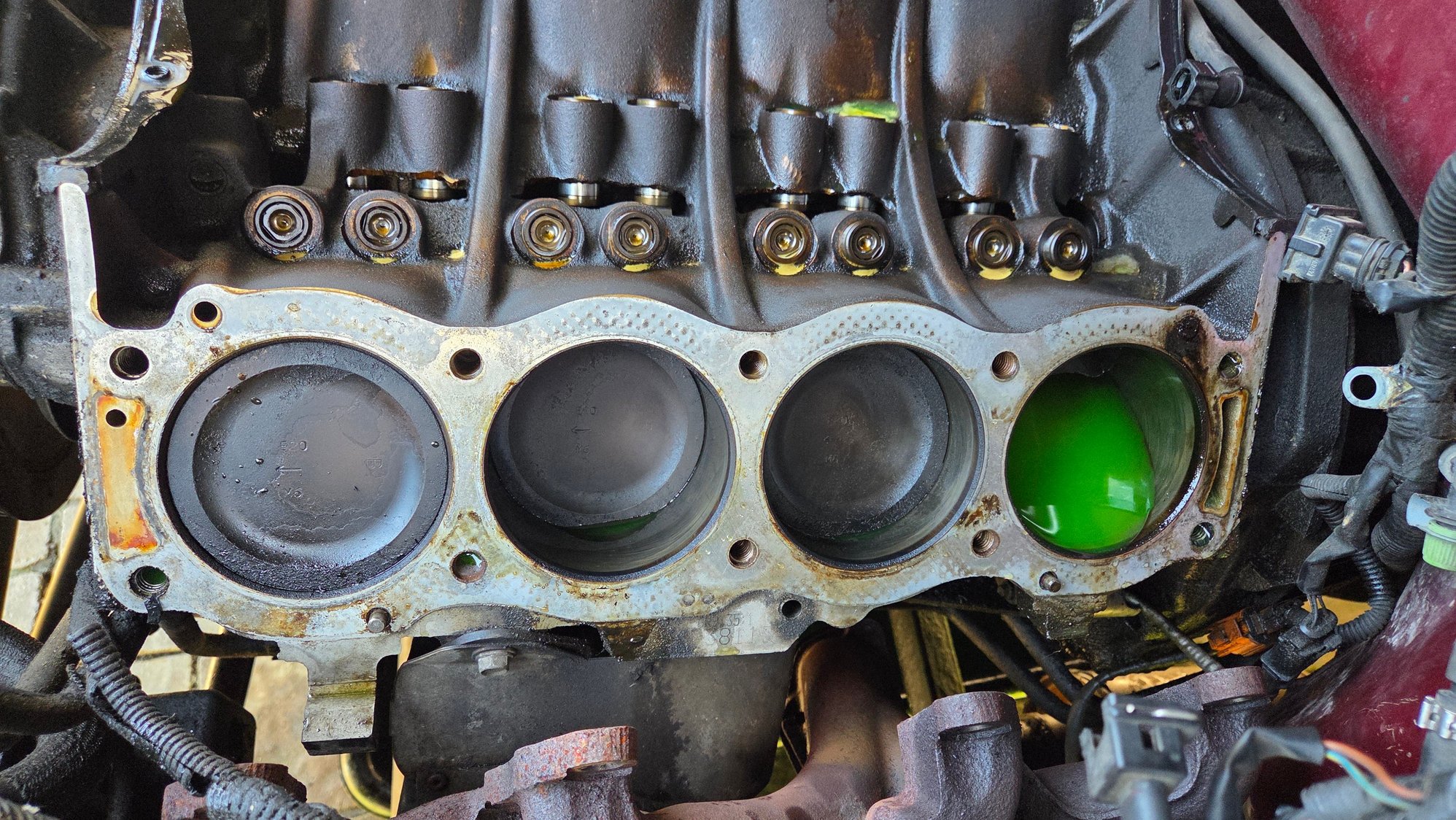

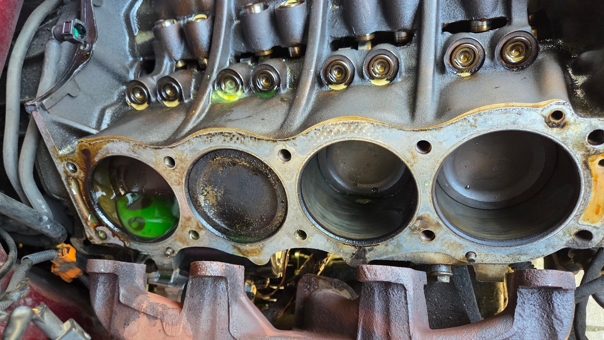

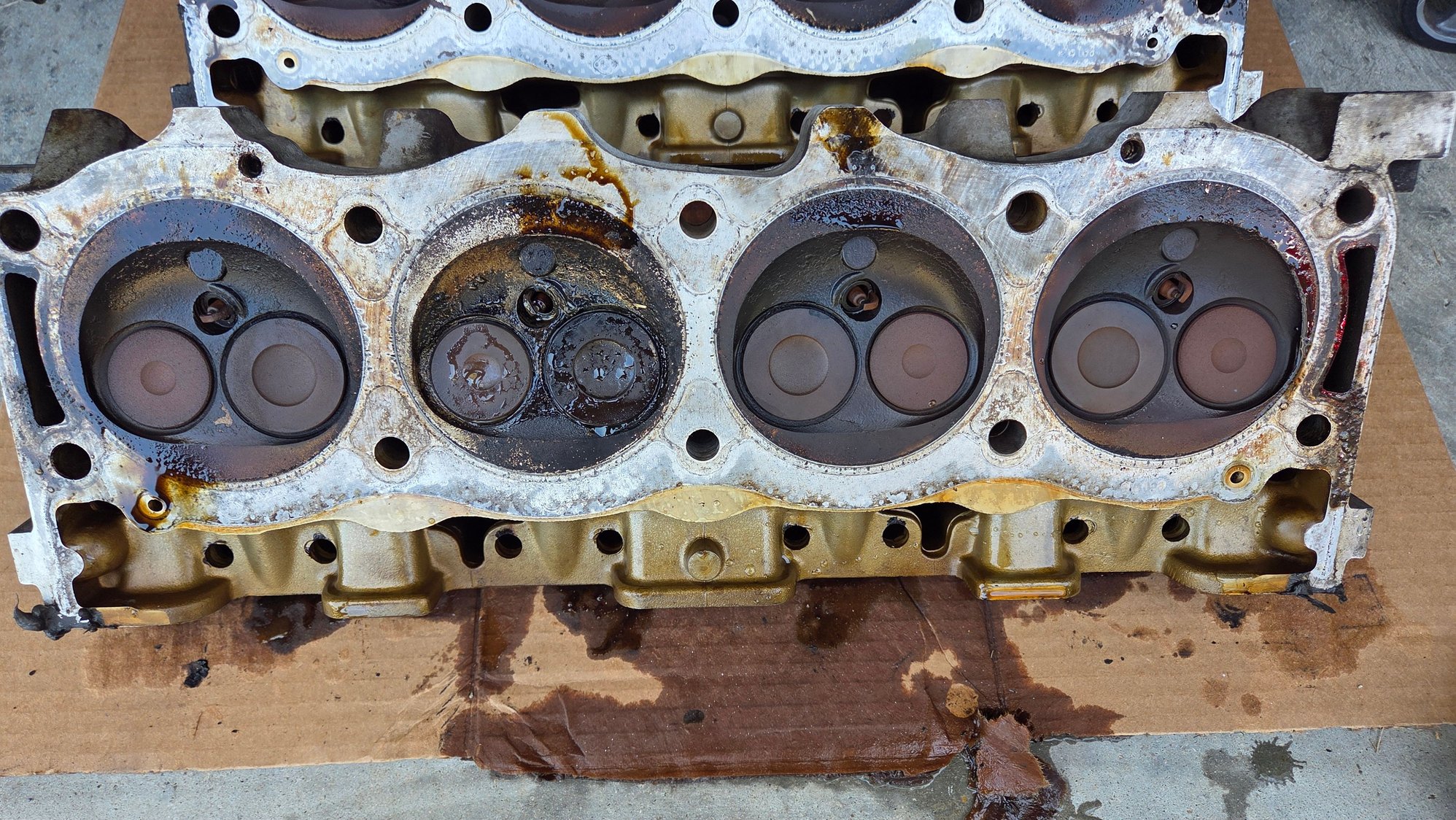

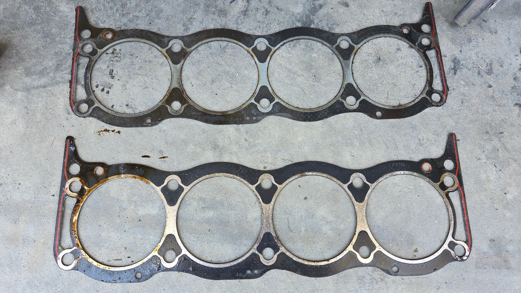

At this point from everything I had read, just decided to replace the head gaskets. Got the kit from Lucky8. I'll post some picks, but the old gaskets looked pretty good to me. Seemed like there was some steam cleaning on one side of cylinder 6.

Looked at the codes and it had a misfire on 6. I guess from reading on here this could be wires or plug I replaced. Seems strange that this is the same cylinder that looked suspect to me when I first got it apart.
At this point just trying to figure out what to do next.
Anyone think I could have a sleave or block issue looking at the pictures of when I first got it apart?

That number six cylinder looks steam cleaned to me, because there's no water jacket there usually the only way to get number six to look like that is with a cracked block. There are multiple ways to test this but what I would do is rent the kit from Advance Auto Parts to pressure test the cooling system. Start the truck up with a full coolant system and let it get to operating temperature. Shut it off and pressurize the system. Let it sit. More than likely if it's cracked and you've got it in operating temperature you will push some coolant into the cylinder and you can see it with a cheap USB borescope that plugs into your phone from Amazon. By the way, I saw a good 4.0 engine for sale in the Raleigh-Durham area yesterday on Facebook. Not sure what part of the country you're in but occasionally trucks Get Wrecked or the frames rust out and you can get a good donor engine for not much money.
@Extinct This sounds like another good test to do. I purchased a coolant pressure kit that I have been using but only did it when cold. I will also look on Facebook. Live in NC close to Raleigh-Durham and been looking but didn't see anything yet.
