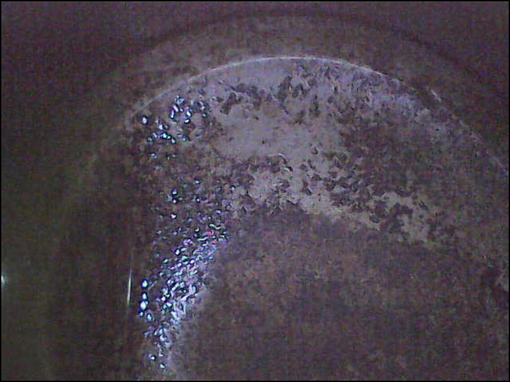

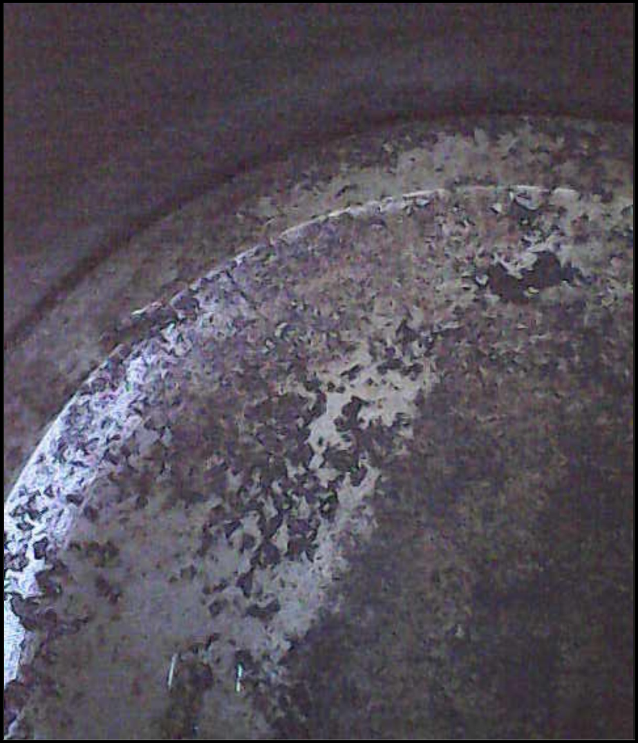

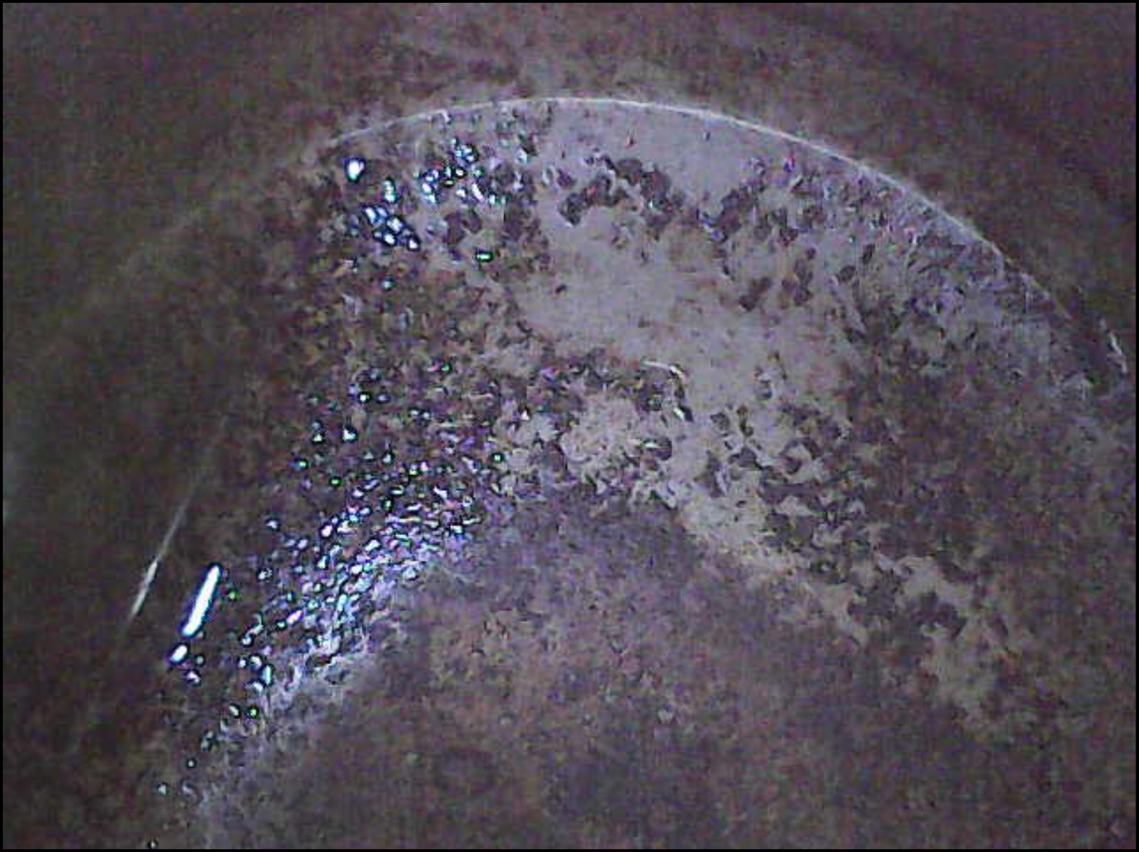

Then while it was still warm I did a coolant pressure test and took a look in 6 with the USB camera. Coolant pressure test still slowly going down in pressure from 18. Was down to 16 after a few minutes. Tried to capture some of the images from the USB camera.
These are all from 6. Definitely was way cleaner and had coolant compared to 2/4/8. Forgot to capture image from 2/4/8 but they were all dry and just a little build up since I had cleaned them off when doing the gaskets. I had to put all the plugs back in so I could move it. May try the block seal stuff but this is a pretty sure sign that I have a crack in the block right?

@pheel well that sucks, beyond the block crack you have an issue on number two I am not sure there is much you can do. Given you the crack is big enough to show up cold I doubt block seal will work. As the block is shot you could try it - nothing to lose but time and some AF. But you are looking at an engine replacement
