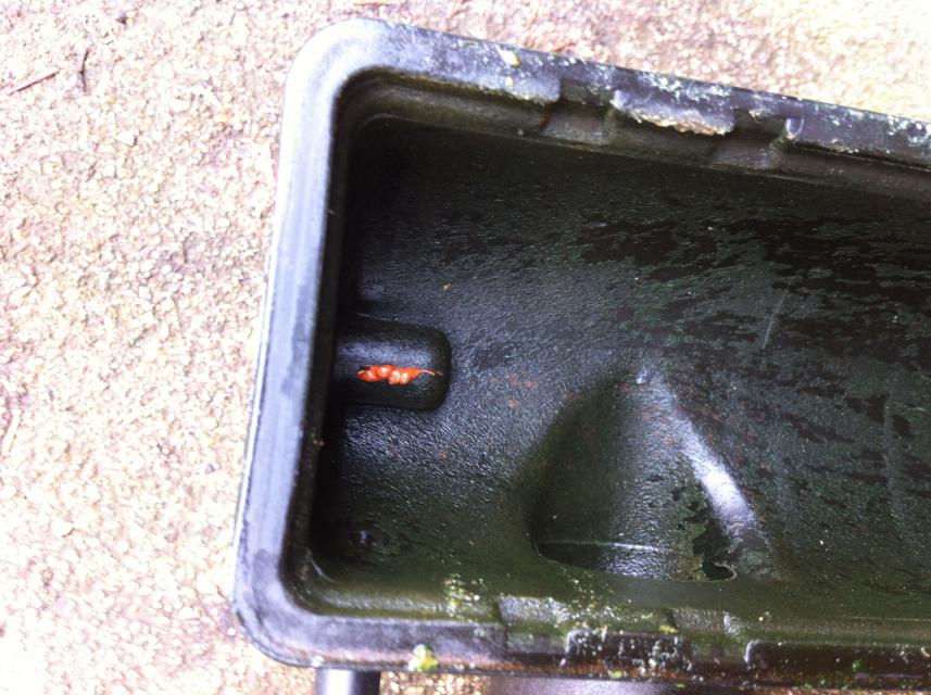

Originally Posted by Dirty Dora
When I got home from work yesterday, I bled the system as per the instructions I found from Disco Mike on here, after putting around 5 litres in, no more would go in and nothing was coming out of the bleeding hole. I carried on as per the instructions still, putting the bleeding screw back in, cap on and then letting the engine idle until warm with the heating turned up full until warm. I proceeded to take the car from where it was parked up to my house about 30min drive. When I got home I popped the bonnet and found coolant leaking from the top of the radiator, it seems to be coming through the screw hole as per the attached pic's, with the engine on it pumps out at quite a rate and their was evidence of leaking from this area before. I hope this is the cause of all my problems and not the head gasket, its annoying as I only had the radiator replaced 6 months ago and about 2 weeks after it was replaced I was left stranded on the beach as one of the hoses hadn't been tied back properly by the mechanics i'd used and had been worn through by the fan!!!
You paid a shop to install the radiator and those pics are the result? They did more than leave a hose clamp loose, those two screws are part of the mounting system, they either put the wrong screws in(too long or too big) or "gorilla" tightened them. Either way I'd be going after them for a new radiator. Those are blind holes that the mounting screws are inserted and if they are leaking, they've cracked the plastic radiator tanks. Cracks in the plastic are pretty terminal when you think of the heat cycles a radiator goes through. Sad to say but IMO, that radiator is toast.

X2 on the damaged rad, even a melted zip tie platic weld won't help this for long.

That leak is the exact same one that I had, except mine was at 90,000 miles. And after having just replaced mine, I can say for sure that Bkreutz is correct. Those are not the proper screws for those holes, and by using the incorrect screws they cracked your tank. On my radiator, I backed out the screw, dried up the hole as best I could, squeezed in a buch of RTV and the reinstalled the screw. It held for a week with no leaks until I was able to replace the radiator. A similar approach may work temporarily in your case so you can drive it back the shop and get them to fix it on their dime.

I suspected that the scr ews that were used would have more than likely been the wrong ones!! I'll see what I can do to hit them up for a replacement. It was a britpart radiator that I used, looks like i'll be replacing again, flushing the system and so on.
