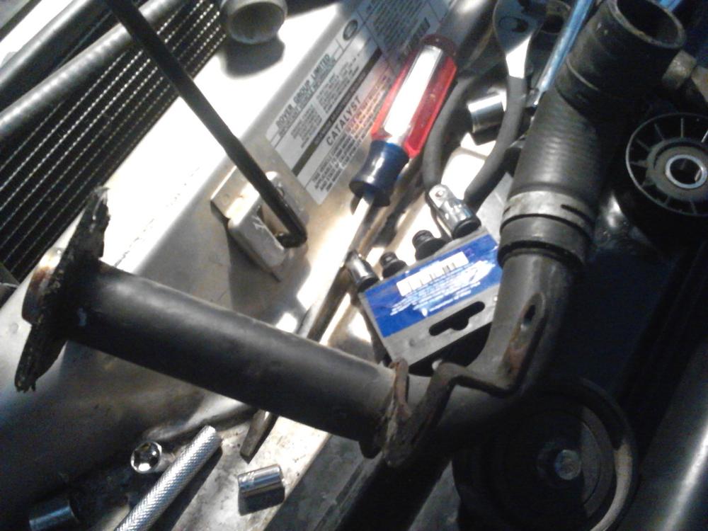

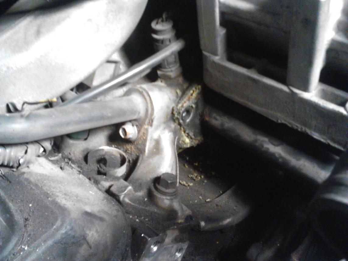

I have a 2000 DII, i keep losing coolant but i cant find the leak.Originally it was overheating only when it was in idle. i realized that condenser fan was not coming on so i replaced it .I replaced the thermostat and the bleeder screw broke and was leaking so i replaced it, also in one of the pictures ive attached it was leaking at the attatchment connecting the engine to the T on top,i just cleaned it well with a brush and used silicone to reseal it. About every four days its running low on coolant and i cant find a leak or not seeing anything on the ground.i also checked the oil and it doesnt seem to be milky or anything ,so im guessing its not the head gaskets? I dunno...Im confused. I appreciate any help
