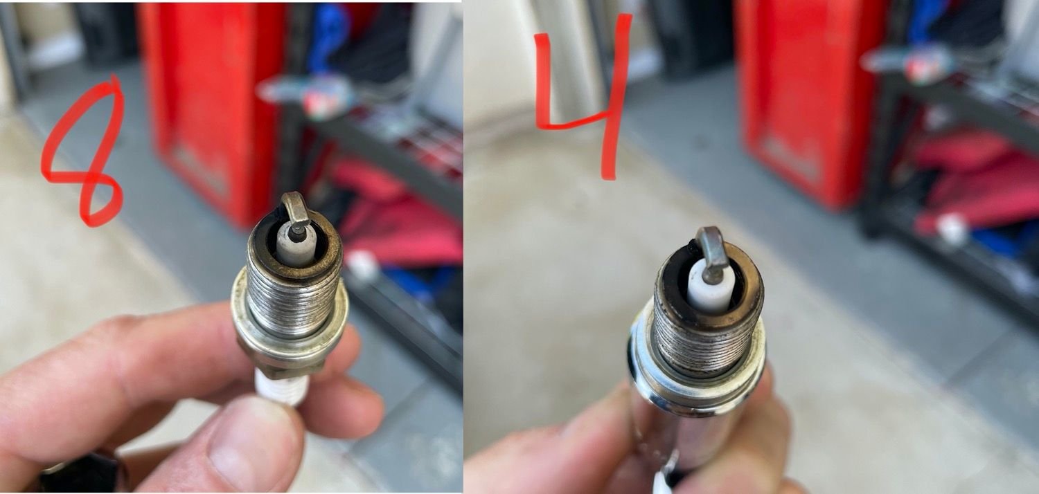

It's possible the misfire is not caused by an ignition system problem, especially since the misfire returned on the same cylinder. A coolant leak into a cylinder can cause a misfire. When you pulled the old spark plugs did the plug from number 8 look different than the others? Was it, for example, noticeably cleaner than the other seven?
I pulled #4 and #8, they looked nearly identical (I will check a couple from the opposite bank). I'll add a coolant system pressure test to my list of things to check. Thanks.
