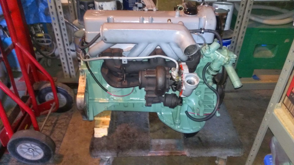

That 1963 is iron. And there is so much room around the engine I could smuggle immigrants in it! Not like ours. When I was on a diesel kick, a guy sent me a picture of his prepped Mercedes OM617 engine and it looked like an alien life form compared to mine!
I'm sort of fixated on it.
