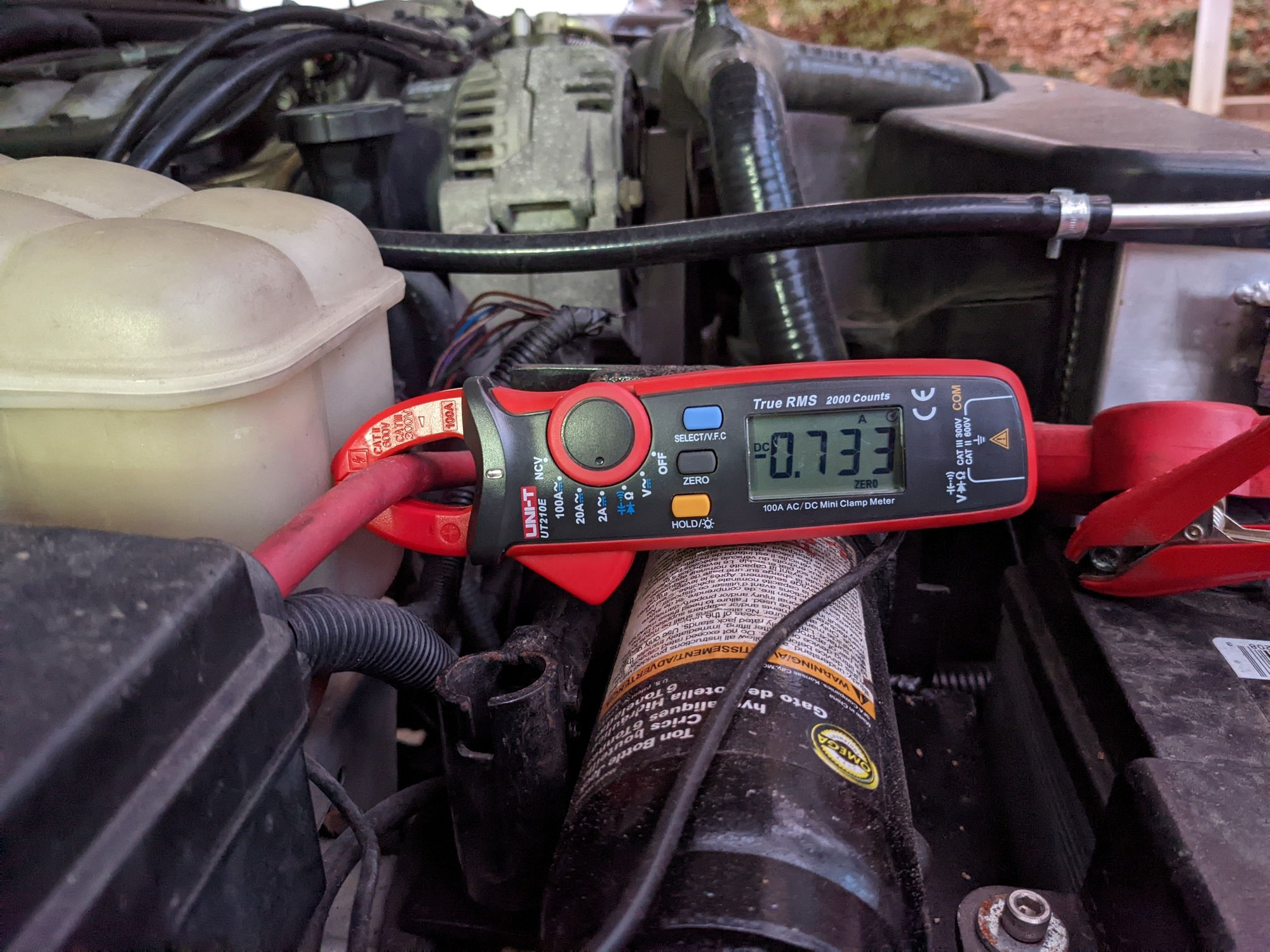

Having an issue with mine, drawing 600-1000ma on the battery lead to the under hood fuse box. I pulled every relay and fuse in that box without any change. Guess I'll get back at it in the daylight.
As I work through fixing leaks and such it just sits for weeks at a time. Usually with this draw it takes about a week for the battery to be dead.
I measure that too, ECU & BCU draw that much when ignition is off. When you lock the doors via the remote the current consumption goes down after several minutes, since these units are put into sleep mode. Just tamper the hood switch with a clamp, lock the doors and come back half an hour later. Current draw should be down significantly to several milliamps.
