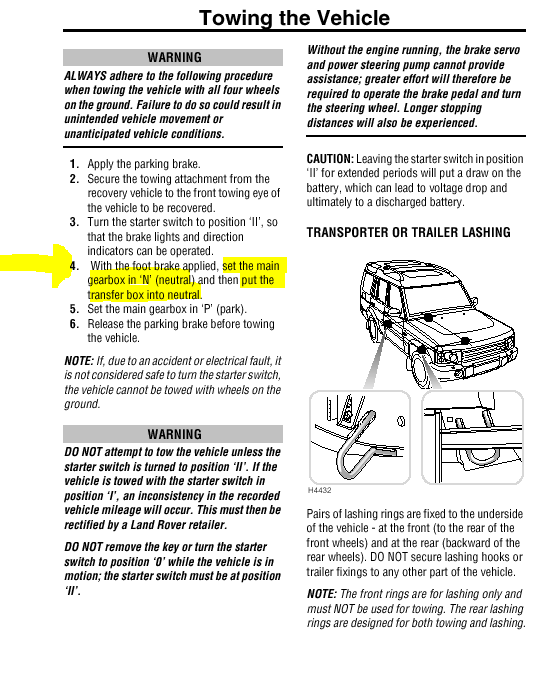

Thanks guys. Brian, I had the same thought and that was the first thing I checked. To make doubly sure it wasn't an issue with the shifter cable we disconnected that and manually clicked the selector all the way into park, then rolled the car.
Alex, I wasn't familiar with the ins and outs of an engine rebuild and wanted to make sure the mechanic didn't have a reason to be in the transfer case where he could accidentally break the pawl.
Process of elimination makes it sound to me like the tow truck dragged the Rover with it in park. I watched them load it onto the truck the first time and it was in Neutral but because it was such a long tow they kept it overnight at their site. I guess they did the damage the following morning loading it back onto the truck. Sounds like a call to the towing company is in order...

It's VERY IMPORTANT when towing these rigs to put BOTH the Automatic Transmission in (N)eutral AND
the Transfer case in (N)eutral. Please educate the towing dip$hit$ for next time.
