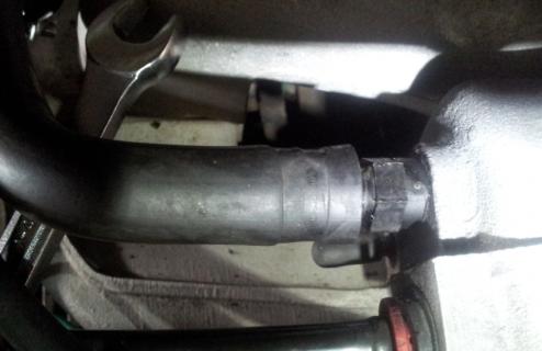

This is a picture of it. It is the black plastic connector between the plenum and the top hose (#11). I really appreciate all the assistance!

^Then acamato has your info, cheers!
