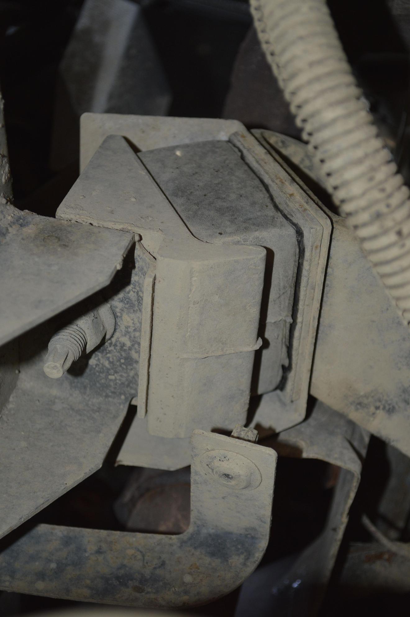

Hi guys pretty sure this is shot or going but any input would be nice.
If is shot do I need an engine hoist to get it out or I can I manage with a floor jack and some 4x4 to protect the pan.
And any brands to avoid Rockauto has an SKP for a reasonable price and shipping is easy
passenger side

I did mine with a floor jack and some wood blocking. Pretty easy job, comparatively.

This maintenance action is what I've been wanting to do in fear of the aging mounts coming apart.
For our V8s you can use the mounts for a 300 TDI engine part #NTC9416 w/ M10 nuts.
I've read from other D2 owners that they are cheaper in price and more solid than the D2 V8 mounts.

@JUKE179r Well they are pretty cheap at 45.00 but I will take a look at 300 TDI mounts thanks for the info
