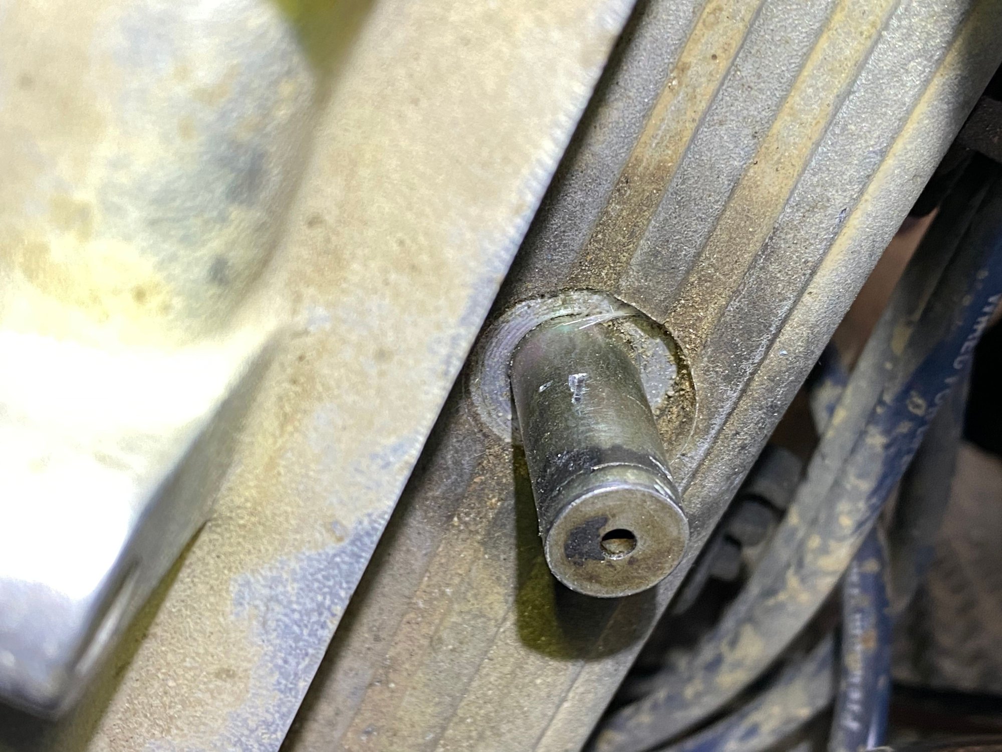

Hi all,
I was going to do the PCV mod on my 2004 disco2 and i dont see the plastic baffle on the oil seperator end. All there is, is a metal tube. See pic.
Do I remove this from the valve cover? Any ideas on how to easily remove it?
thanks in advance!

Ok. So I do need to remove this tube. Is it a pull off or screw off? Any tips please!!!

Grab the end with a pair of pliers and twist till the tube comes out. Once it is out, cut the end with the disc off of it with a tubing cutter. Then drill the plastic baffle out and just tap the tube back in the valve cover

Thanks. So it’s not a screw on, but just tapped in place? Im soaking it with penetrating oil. Hopefully it comes out!

It's just pressed in, but it came lose very easily on mine. Put a short piece of rubber hose over the tube (to prevent scratches) and try to wiggle it with a vice grip.

The easiest way to pull the PVC tube out is with Hose Pliers. These have a little round open tip at the end to grab hoses. It will grab the PVC tube and easily pull it out.
Harbor Freight sells a set for cheap.
I have SAI, so it's crowded around that area in the engine, and I struggled to pull it out with various regular pliers. Hose pliers took seconds.

Thank you all for the suggestions. I soaked it it penetrating oil for a day, then got a vise grip from Harbor freight and it took me a few seconds to wiggle and pull it out. I cant’t believe its just held in place by tapping, but oh well.
I was able to push out the plstic baffle and enlarge the hole with a drill. Managed to get some minor scuffs in the process but looks like the hose went back on it nicely and the truck feels a tad bit smoother and less noisy. Thank you all again!
