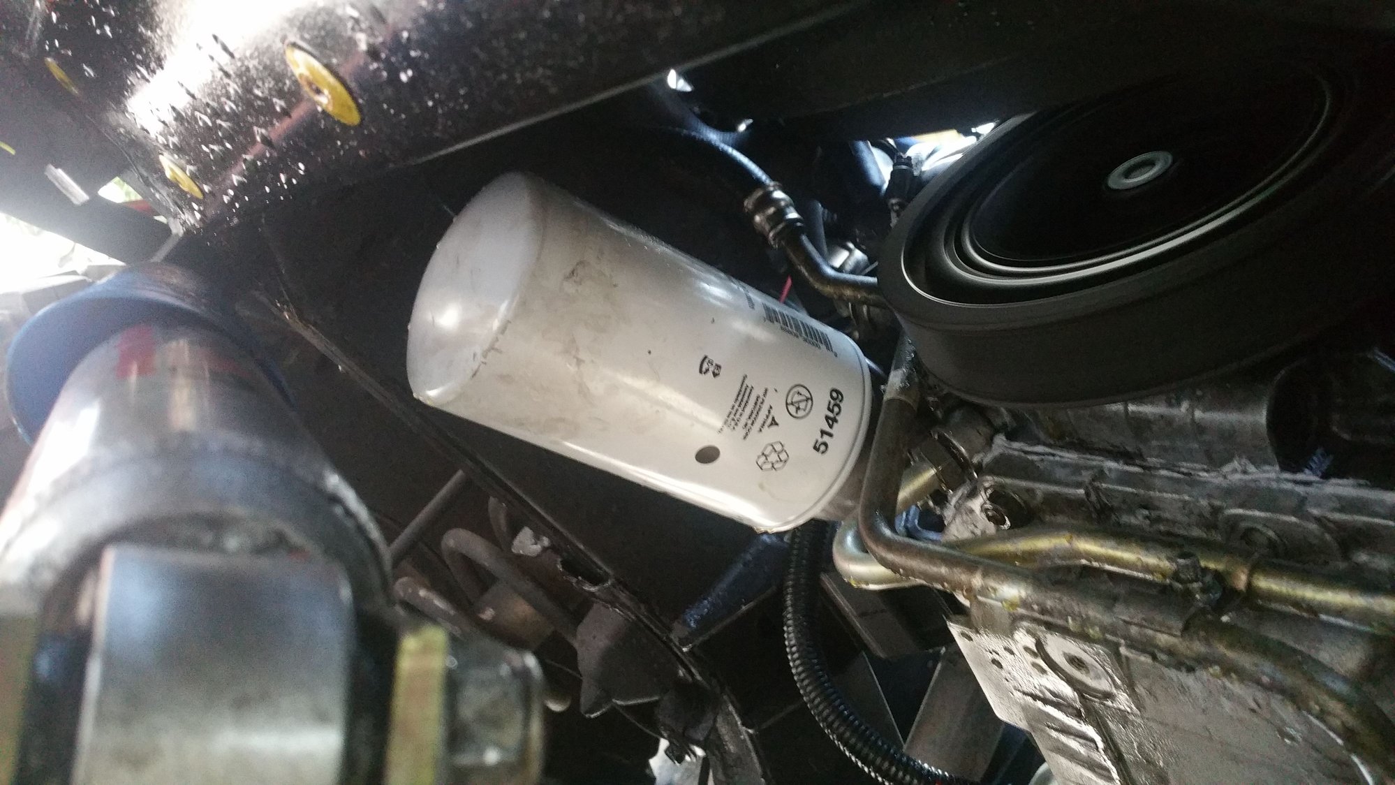

So then I put on my new mega filter.
This increased the pressure immediately. I cut the old filter open and it did have some sludgy stuff in it which I assume is the Vaseline that I put everywhere in the oil pump when I swapped last week. No Vaseline this time.

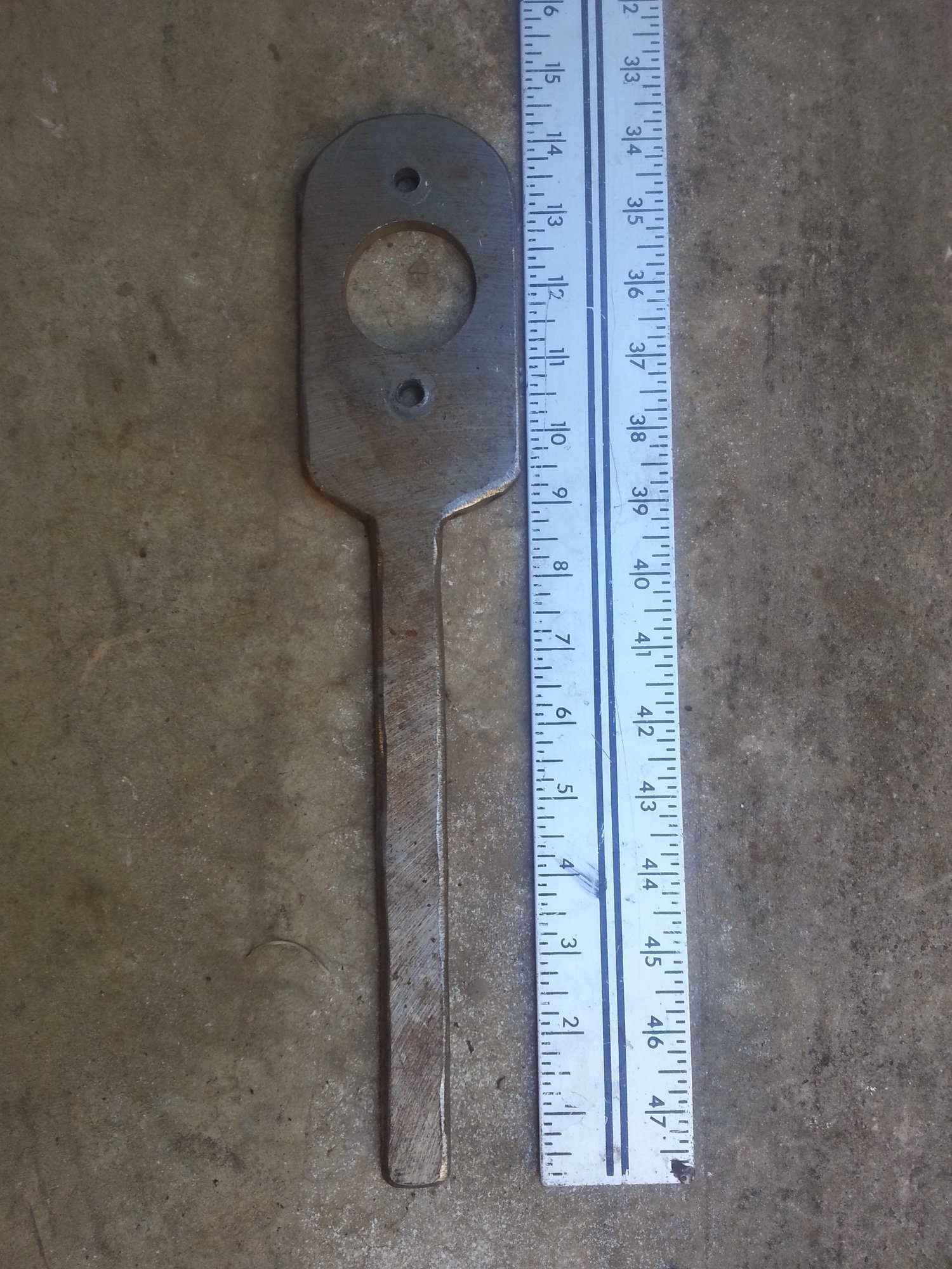

It is basically a metal coach's paddle. I'm looking for a picture...

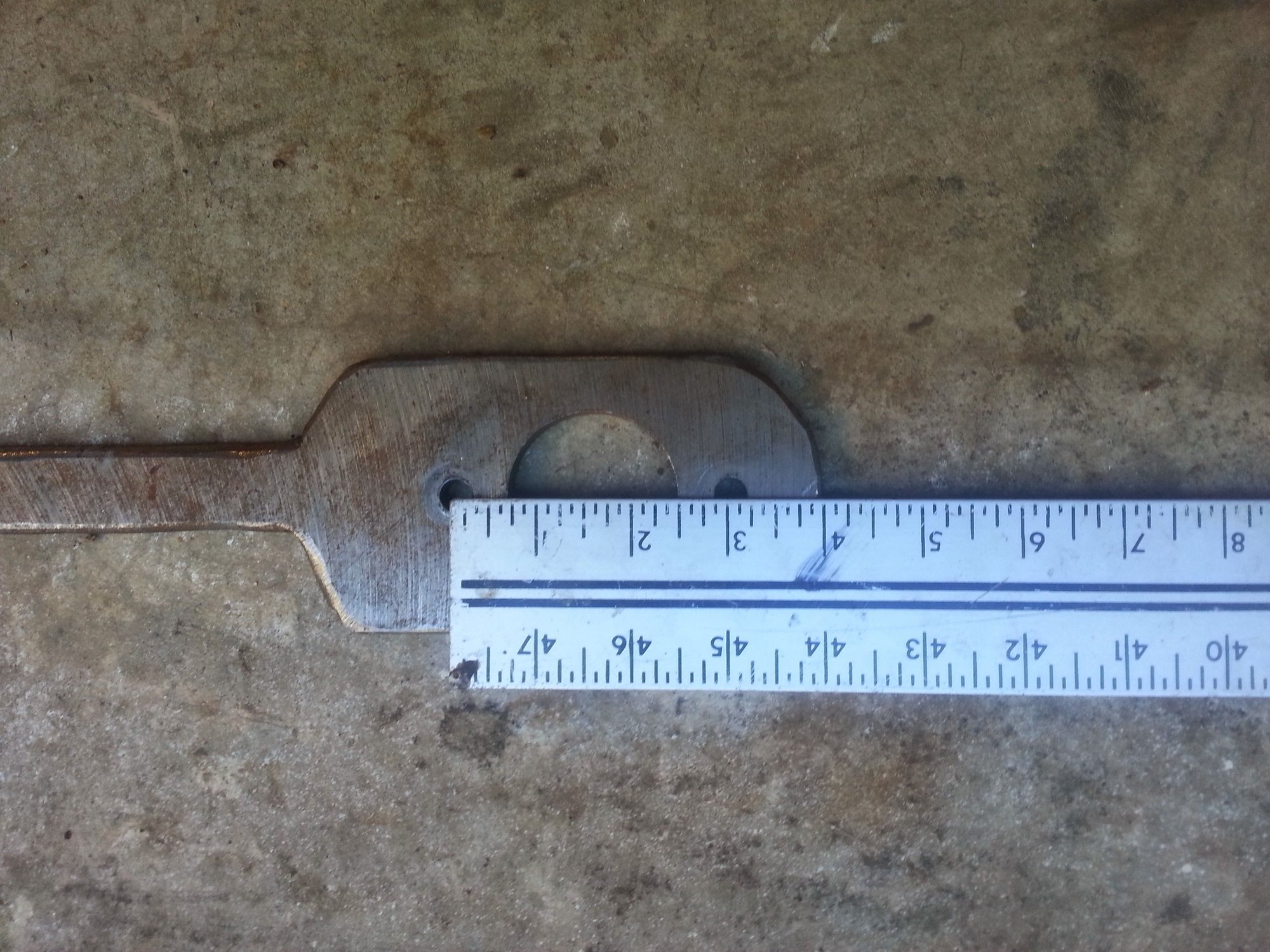

AH, here is what you need. I can't remember what it cost.... maybe 35 or 40 dollars. I use it all of the time... I used it a couple of days ago. EDIT: Well, DUH, that's in this very thread. Any decent fabrication shop should be able to look at those pictures and make one while you have lunch. The length of the handle could be longer, but I wouldn't make it shorter--it rests very easily against the power steering unit for loosening and a 5 dollar metal fence post cut to length holds it just below the power steering unit for tightening. swinging the other way for loosening (and avoiding the power steering unit) is fine, but you have to take the oil filter off. Or if you have gorilla arms I guess you could just pull or push the two levers.
Bolts go through the holes to the threaded holes on the crank pulley. The socket for the crank bolt goes through the middle. You just brace the end on something sturdy and turn the socket.
Sometimes it is better than dropping the pan and wedging wood or a mallet in the crank. It definitely works better on a stand (with a metal fence post on the tool) because you are levering against the tool, not the stand. I never have any help and it took me about 30 minutes to swap the crank pulley and seal, including rummaging for tools and spitting out dripped antifreeze from another project.
I used to bend the bolts badly every time I used it because I couldn't run them all the way to tight or they would hit the metal shield behind the pulley. One time I bent them so bad it took alot of work to get them off. Since then I got shorter bolts and use washers. It would be better if the tool was dished to fit inside of the pulley, but nothing is perfect and this is plenty strong (including the bolts) for 150-200ft/lbs. Also, the paddle can be wider (but there is no reason) but not shorter. My prototype was a 2x4 with bolts through it. It broke in an alarming fashion while I was trying to give myself a hernia with a too-short ratchet.
