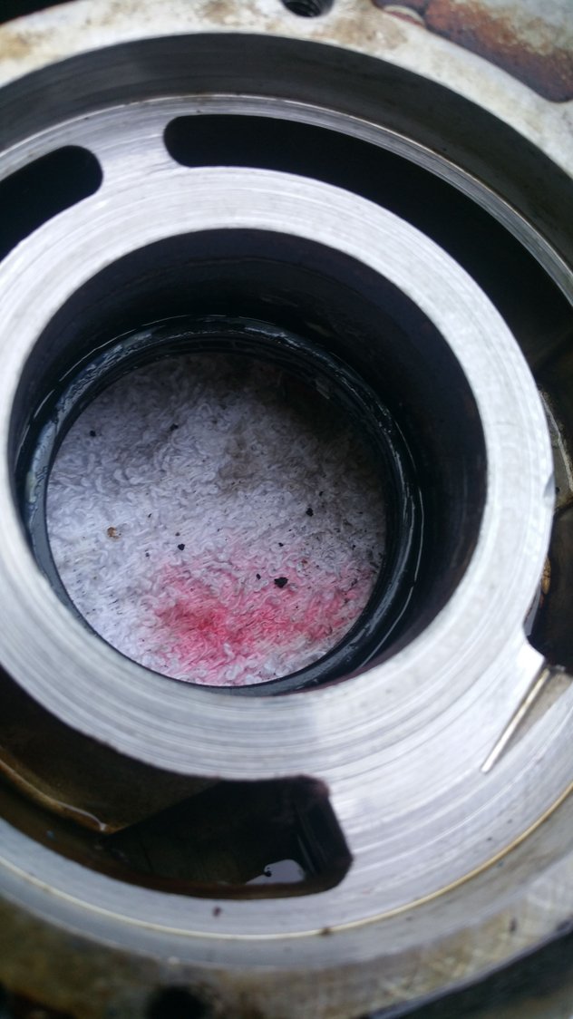

Old Mar 16, 2016 | 07:31 PM
  #24
Charlie_V's Avatar
Joined: Nov 2012
Posts: 3,717
Likes: 248
From: Longview, Texas
Default I found the problem.
I found a problem. Wow.
So that's an issue. Need a new timing cover. Those grooves are DEEP. The ding I just caused but it doesn't matter. That's definitely an oil pressure problem right there.
Abran suggested that my cam bearings being worn or walked could cause other issues. I'll check that next.
Also, there are TWO pressure relief pistons in the front cover on opposite sides. Not ONE but TWO. One came out easily and had already been checked. I had to beat the other one out with a long probe and a mallet. It was stuck, and I couldn't tell what position it was stuck in but it sure as heck wasn't at the end of the tube. I don't know how the second one escaped me attention before. But there are two. TWO!
I'd say I've discovered the problem. Or the beginning of the problem.
I'm not using my other front cover. I don't trust them.
Ugh. Off to order parts.
