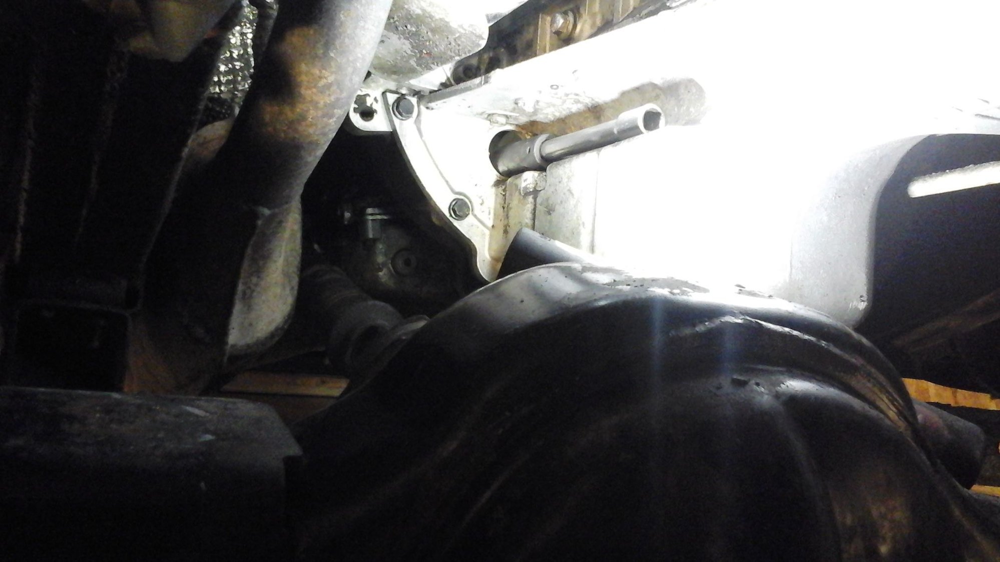

I'm new to this forum. I purchased a 2002 disco2 with 160k miles on it about a year ago. I am currently in the middle of replacing the torque converter. I'm following the RAVE manual. I can barely see the 4 TC bolts that need to be removed. Through either the peep hole or the startes hole. I can just barely touch them thru the starter hole, and need to know how the heck do you remove them?? Akso, please tell me what else I should replace seeing how I've got so many parts removed. I appreciate any help. Thanx

Remove rubber inspection by the starter to remove torque converter bolts.

​​​​Remove rubber plug just below starter.

Yep sorry I meant to say "by" starter 😂

Hey guys. Thank you so much ! I looked at the diagram in the manual and mistakenly took the rubber plug out of the other side. I will be more careful from now on. Going out now to remove the bolts. Thanks again. Love this forum.
