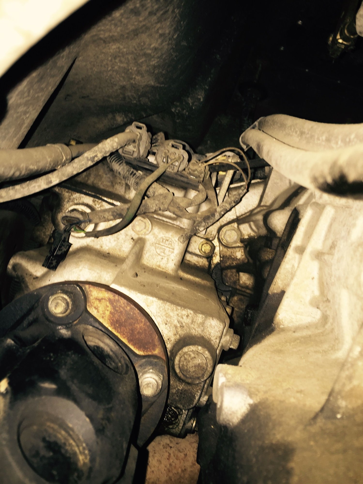

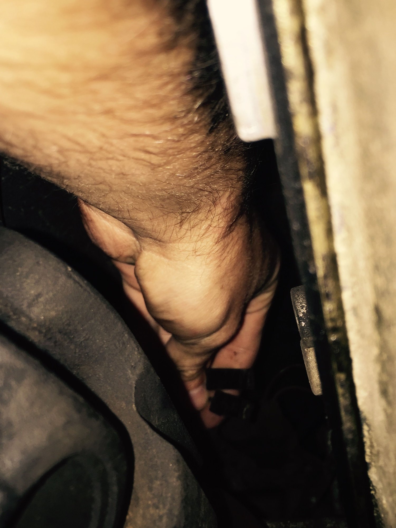

My 2002 disco was manufactured in on May 11, '01, so I was hoping to find the CDL nipple... but unfortunately it's not there. It really wants to... with that circular recessed area... but no. While looking, I found these 2 unplugged connectors, what are they and why would they be disconnected?
The black connectors to the left.

Those would go onto the CDL Engage/Disengage switch. On my 02 Kalahari they were disconnected just hanging there like yours. I installed the 04 Linkage, and connected those wires and I was all set.
