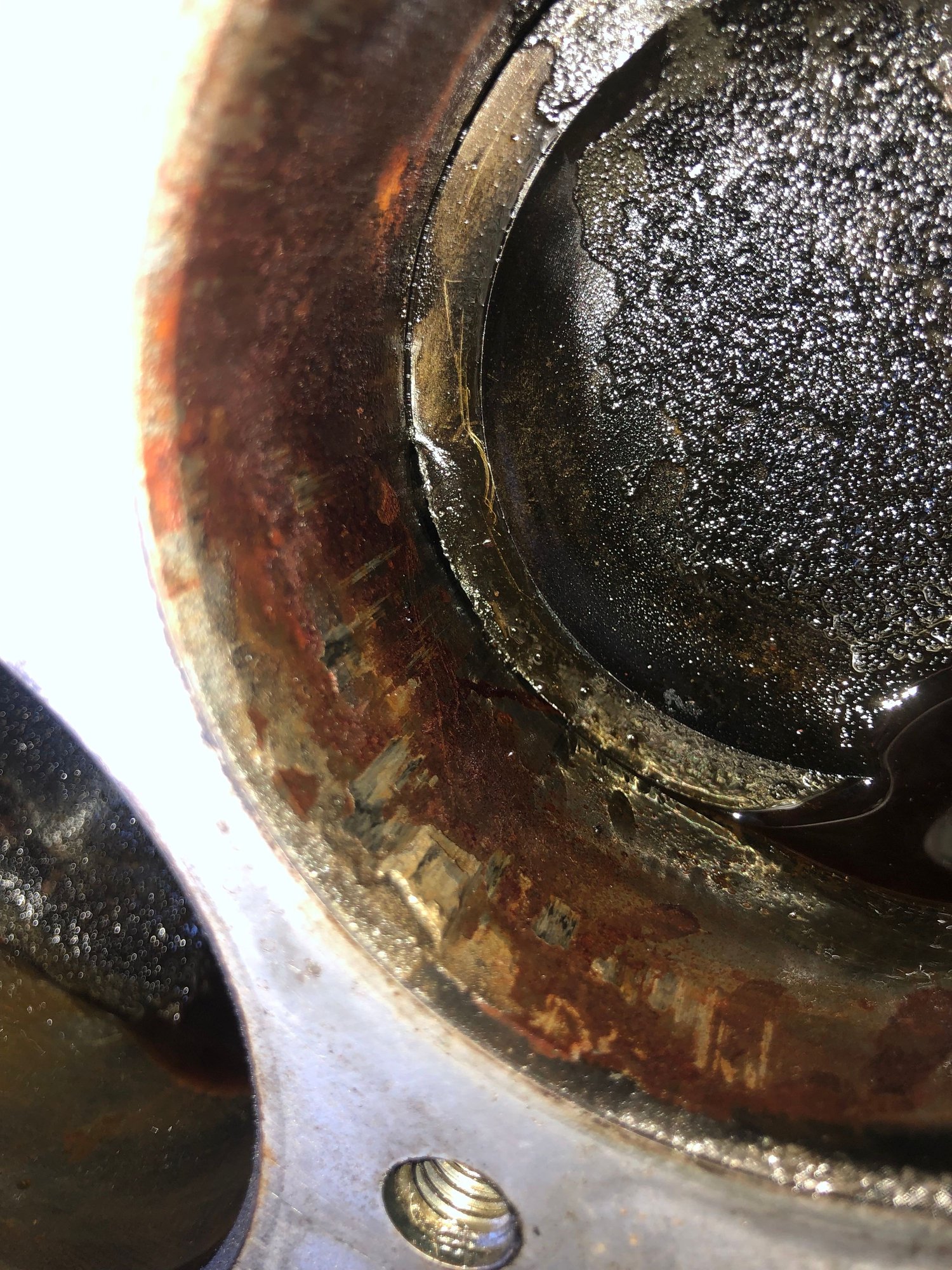

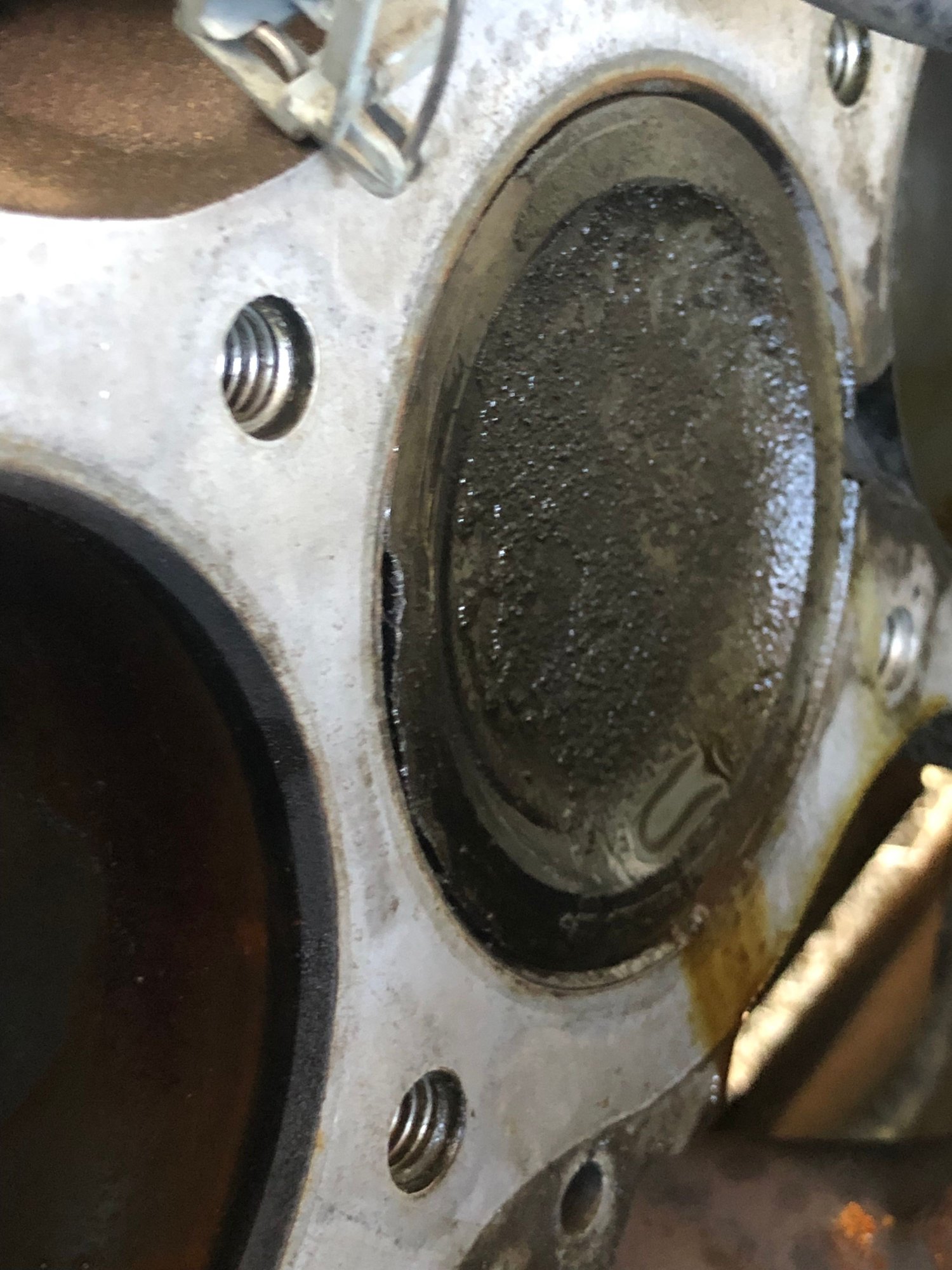

Upon closer inspection, one piston seems to be damaged pretty bad but the others seem visually fine. Should I get a new piston from ebay for $60, new from atlantic british for $90, or used piston that includes connecting rod for $70? Would a used one be better since it more closely matches the existing cylinders? Could the connecting rod also be somehow damaged and need replacement?

You guys must not value your time at the same level I do mine, or maybe my machine shop is dramatically cheaper? I would get the rod and piston assembly. You would need a press to disassemble yours and re-assemble, or have a machine shop do it. If it is in good shape and to spec then no reason it would not work fine.
