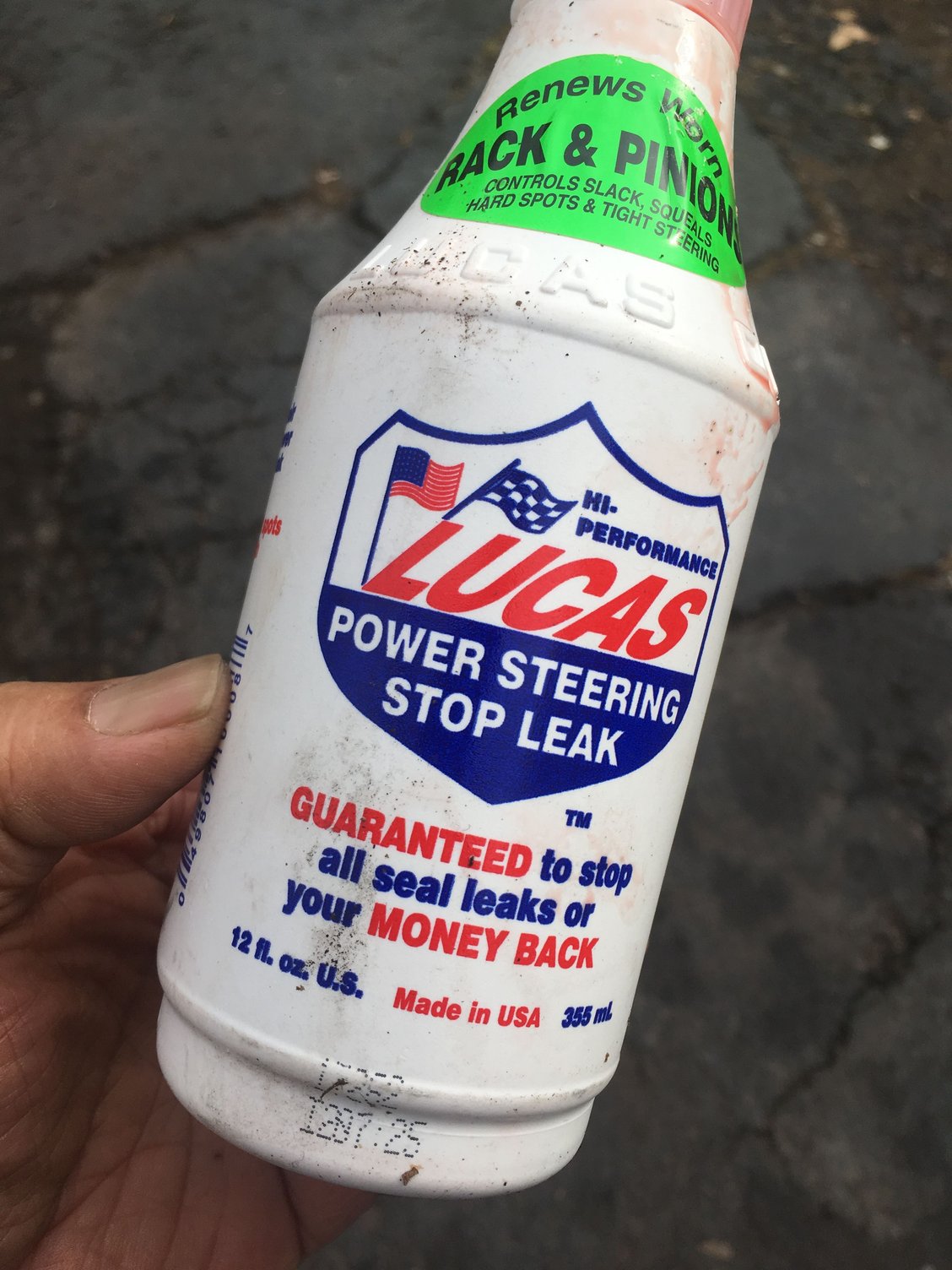

Its been cold here lately and my power steering line leaked real bad. Everything in front got soaked with fluid and my driveway is a mess. I tried this priduct until it gets warmer to replace the line. Amazingly, it worked. Sixpack just replaced his steering box and he ‘ll chime in.

Forgot to add image above.

I wouldn't use the stop leak as you know where the leak is, and stop leak can cause more problems than it fixes. If it was the output on the bottom where the drop arm is, was leaking, then yeah you can try stop leak then because at that point if you want to fix the leak you either have to rebuild/reseal the box, or get a new one. And I've heard that resealing the box doesn't always work because its usually part of the metal on the box that wore away, so new seals wouldn't help. My box was leaking bad on the output, so I picked up a new one from across the pond for about $550, brand was Adwest
